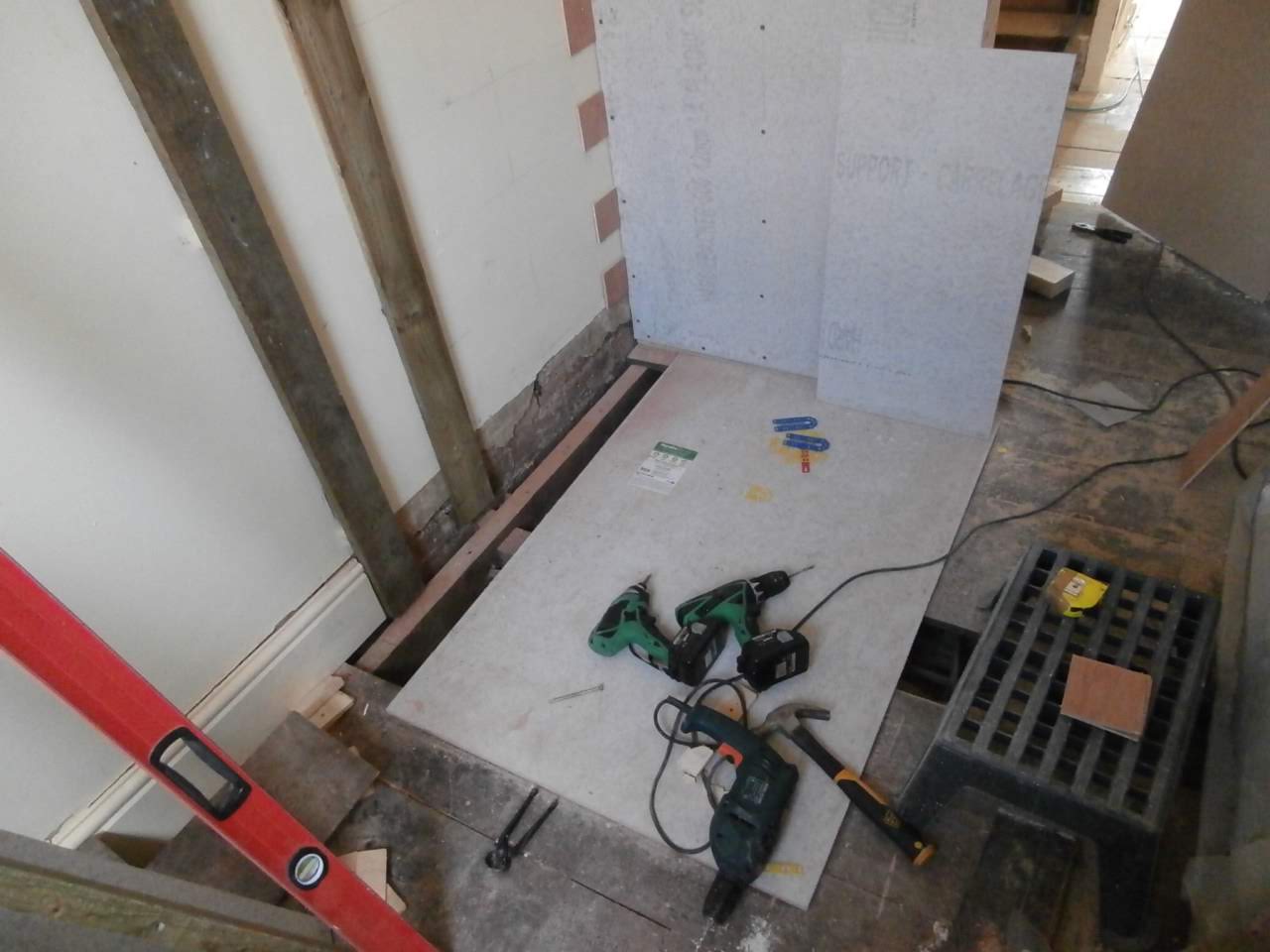

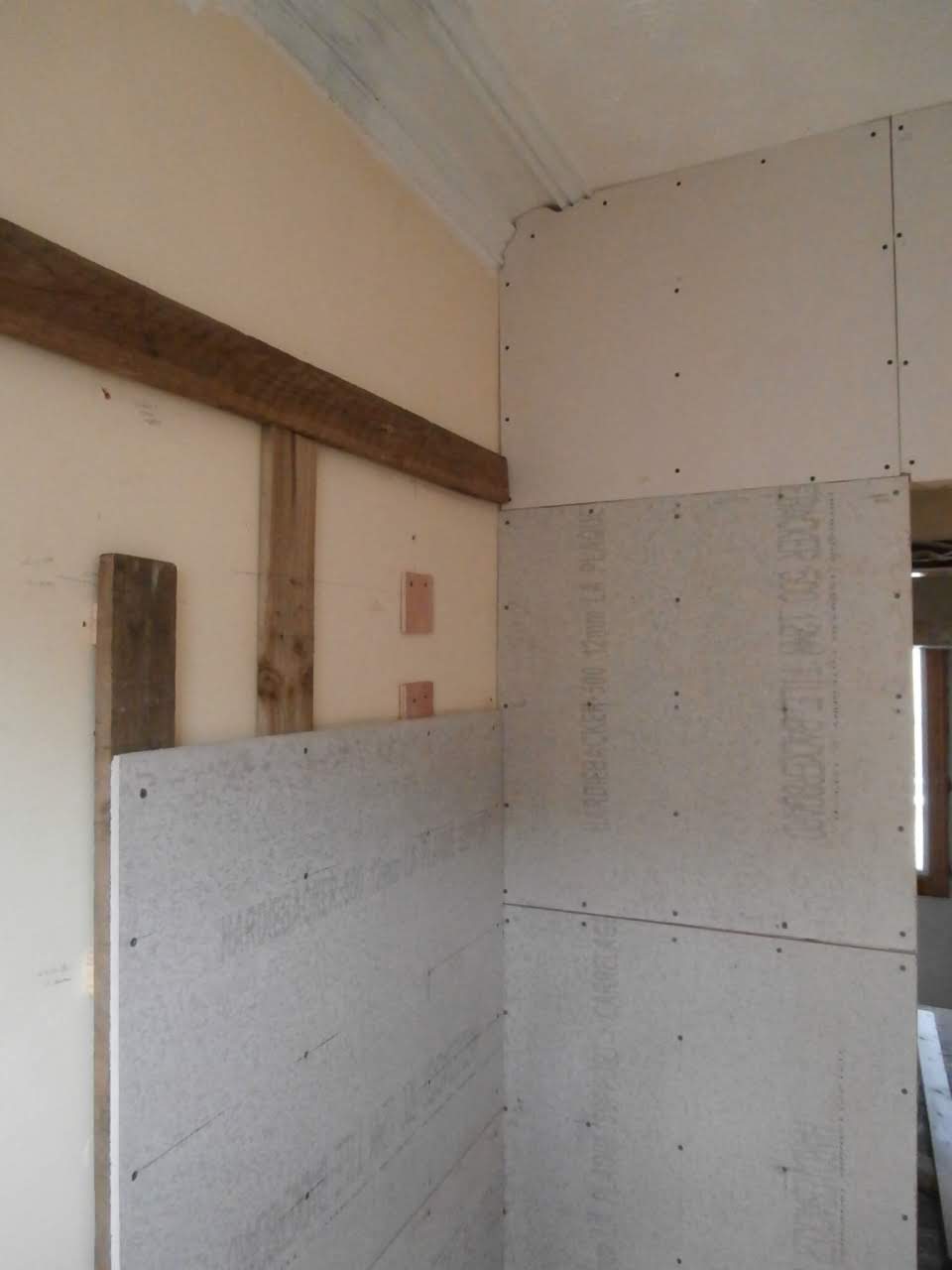

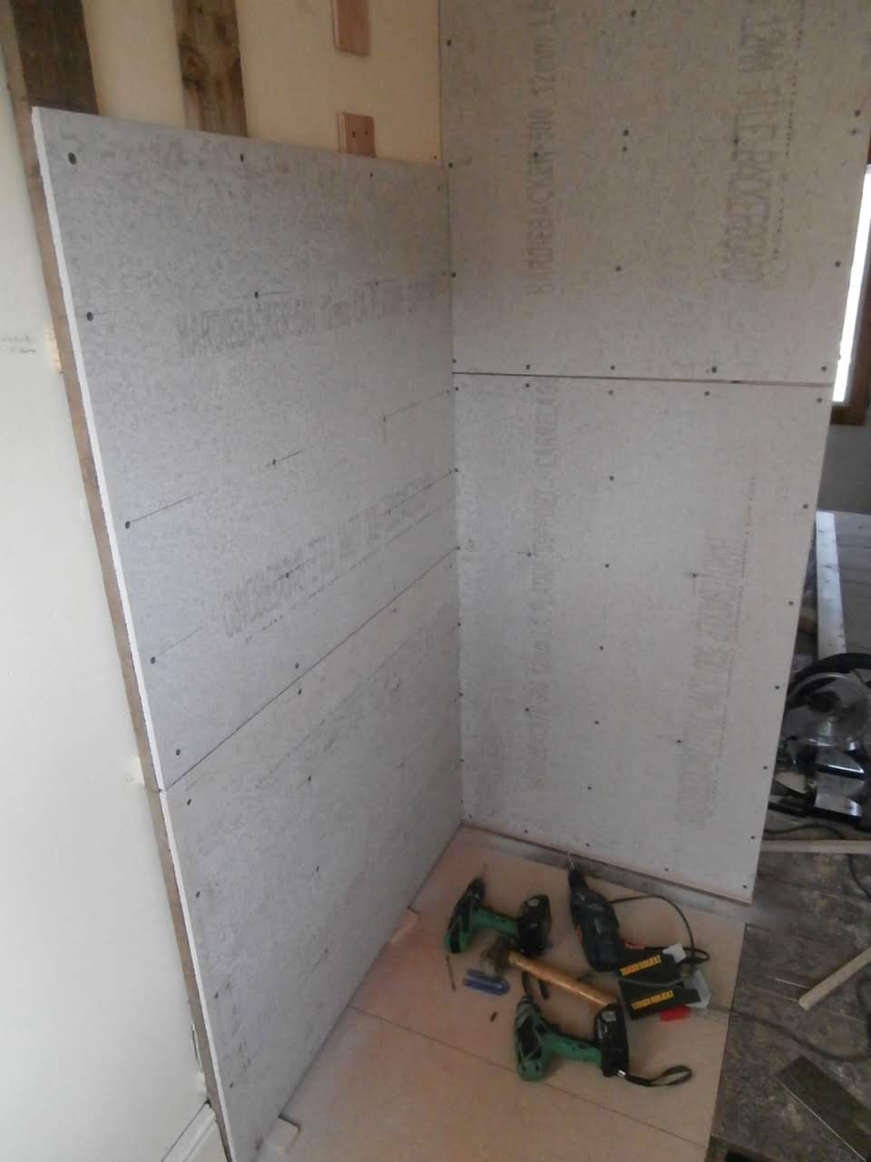

I fitted a shower into a non-square, non-vertical corner. 45mm down to about 15mm. Had to use packers of differing thicknesses for the full tray length and full shower height, using multiple boards. I then tiled. It was a ball-ache but totally doable and came out fine.
Then did the same for the floor below as well!
Yes, doable, but it helps if you have the patience for messing about with numbers and angles.
