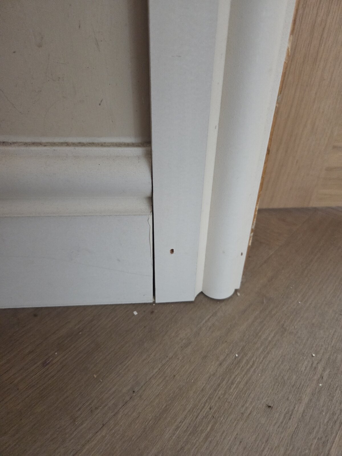

Hi, I've recently fitted new skirting and architraves in a few rooms. Some of my joints are slightly poor and I have some gaps like the photo. What is the best products to fill these gaps? I am assuming something that allows movement??
Toupret powder wood filler.
Others gun in caulk but I don't like that. It's a problem next time you paint plus don't last for years.
When fitting skirting I use 2 pack wood filler when butting up as I go
Thanks for response. Hadn't thought about using filler when fitting but thats probs because I don't do it often. Thanks anyway
