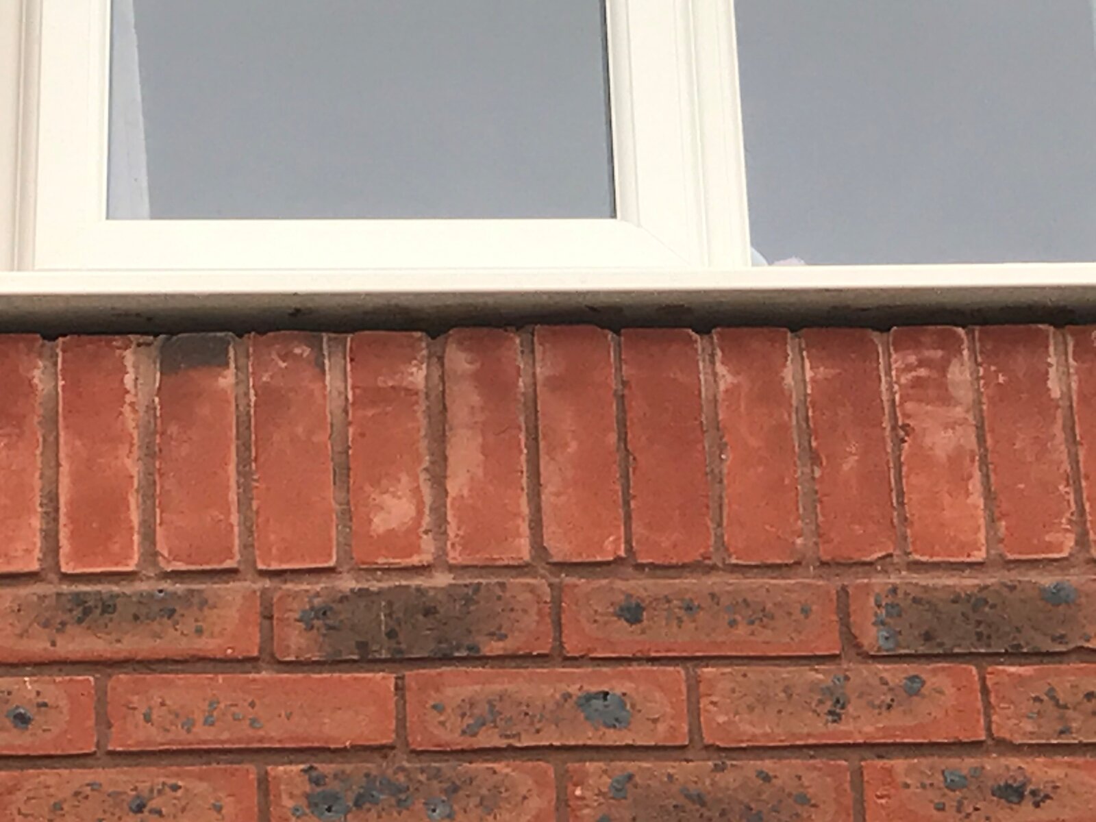

Hi all,
At the rear of my new house there is a gap under each of the first floor windows between the brick work and the underside of the window cill. I've not been able to take a good look due to the height but it looks to be about an inch maybe more.
The house is timber framed and I am concerned that water could be getting in there and in some way affecting the stability of the house.
There aren't the same gaps around any of the other windows and no w I'm outside the builders warranty period they don't care.
NHBC say they won't look unless there is actual damage.
Anyone have any advice as to whether this is a problem and if so what I can do to fix it?
Thank you
Ben

Duck tape along bricks. Fill with sand and cement. Just as its setting point up (smooth with bit of hose pipe) pull tape.
Cover below if there is a window with polystyrene sheets. Wickes do best ones.
Buy sand and cement good to go in bag or tub. Just add water type..
Guess window was too small and they packed up?
Why bother filling a gap when you can leave it, safe in the knowledge the building 'inspectors' won't bother to pick up on it ...
