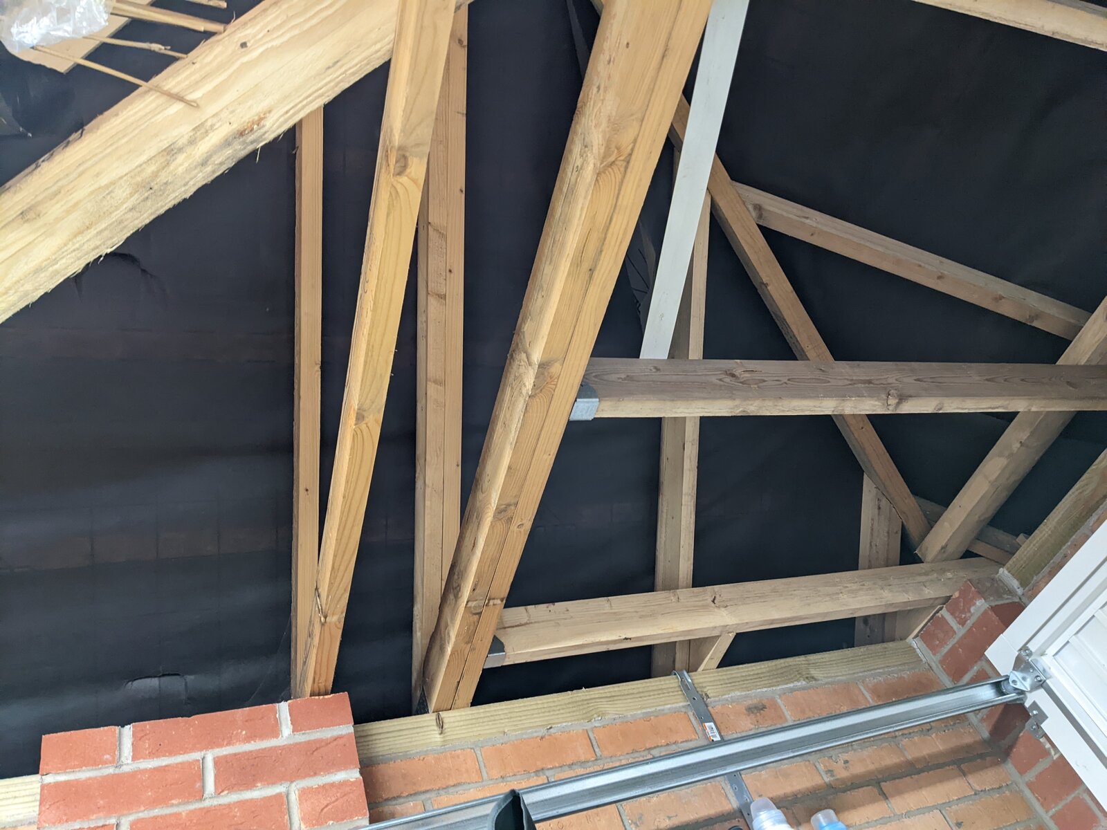

Moved into a new build with a separate garage
Wife has a heat pump dryer we plan on using.in the garage but it's cold in the winter so will run a small heater when it's in use
I have placed a rubber floor over the concrete and boarded the walls with insulation the 9mm ply as well as insulated the garage door

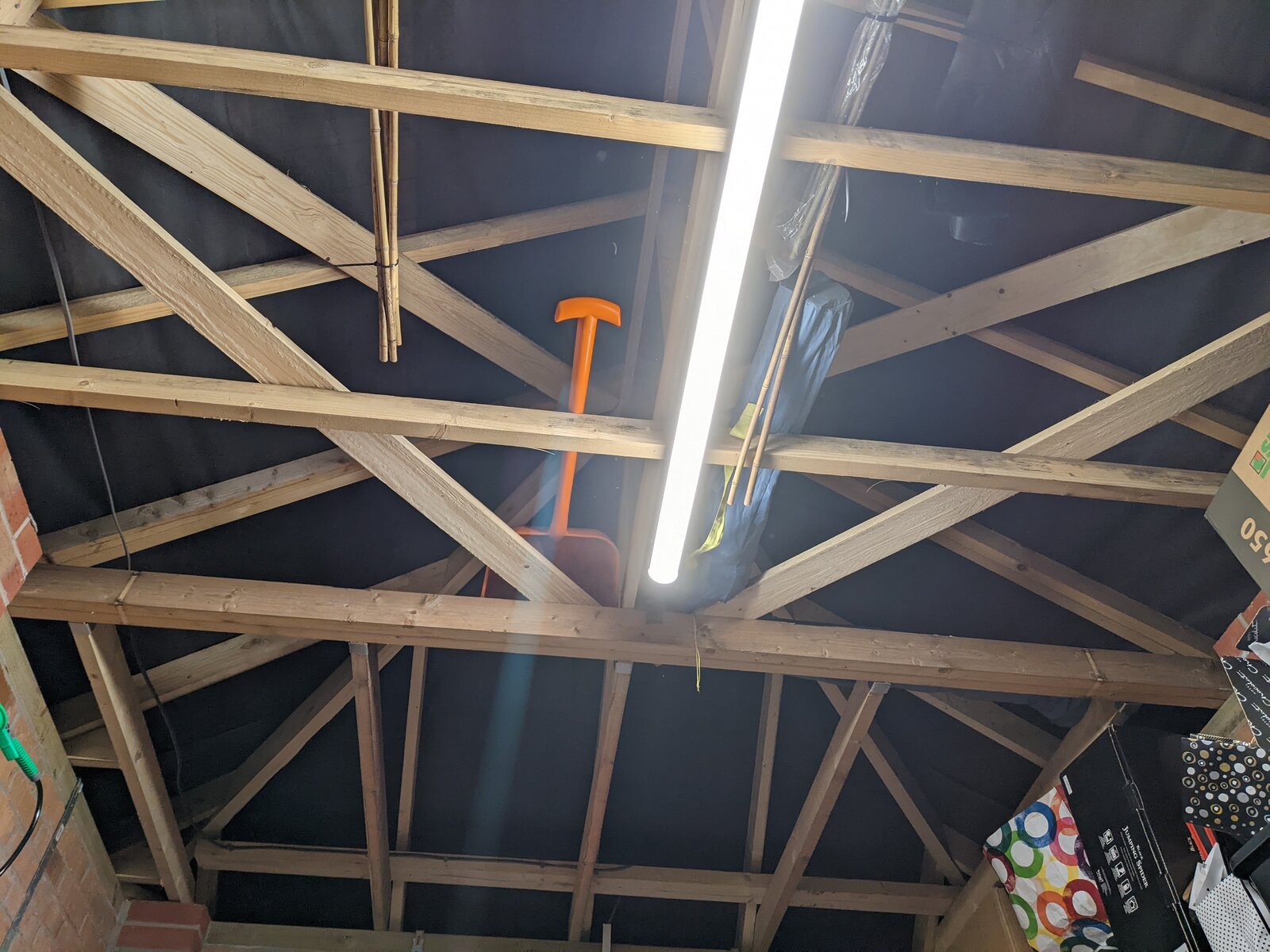

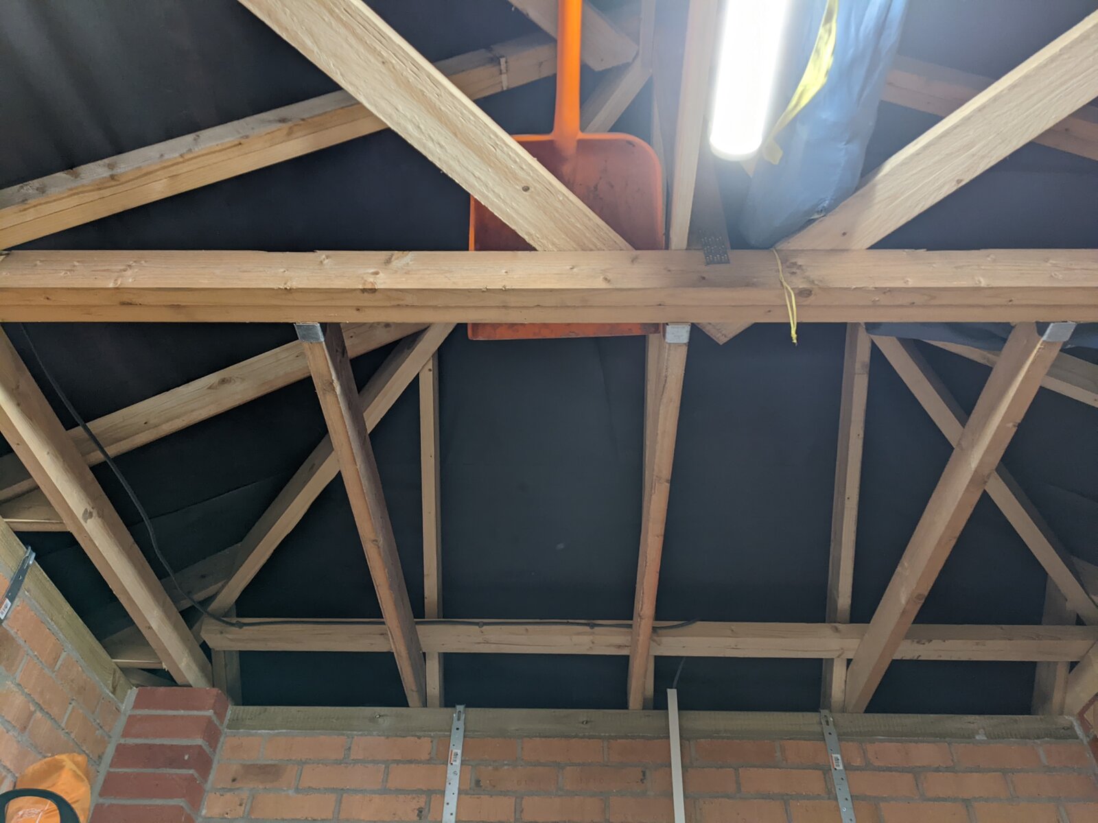

Onto the roof and there is a big void above so plan on boarding this with 4mm ply painted white attached to the underside of the joists 88x38 mainly
Should I put space blanket on top of the joists or cut insulation and lay it in between the joists
Just concerned that once it's boarded I won't be able to see the joists anymore so don't want to lock moisture between insulation and timber joists
Picture of roof before the walls were boarded

Vent the space above to get air blowing through.
Kingspan between joists
Stick 25mm kingspan to 8x4 plasterboard (cheaper than buying) and hire board lifter for a day and fit over entire ceiling. Moisture cant get past the foil on kingspan.
Tape joints
Paint ceiling.
Buy a dehumidifier ( game changer) to dry laundry and also control house condensation or buy the cheapest vented tumble dryer you can find and vent it out the house.
