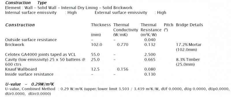

I have been in contact with Celotex and they have provided this method in achieving the u-value's by adding an internal wall to an existing single skin brick wall...
Interesting post that DD.
Are you sure that only 55mm of GA4000 will give a resistance of 2.500m2K/W and a subsequent U value of 0.29W/m2K?
Am I correct in assuming that 9mm sheathing, breather membrane and vapour control membrane have no resistance value?

That was the calculation I was provided by Celotex's Technical department so I'm not arguing :)
FMT will be able to confirm the thermal resistance of 9mm sheating as that's not on my calculation, so as per the calculation above, the BM and VCL both do not provide any thermal resistance.

I really don't know what all the fuss about is, this is some official blurb from Kingspan http://www.insulation.kingspan.com/uk/pdf/refurb_booklet_2009.pdf page 15 or 16. I've used this spec in plenty of garage conversions and it gets approved every time.
Kingspans solution for a half brick skin is basically the same as what DD specified for Celotex, 50mm cavity, BM 12mm sheathing etc, etc.
Both pages you quote 15 and 16 from Kingspan are for a 215mm brick wall. Will agree that OP states (single brick wall), but I feel sure that he means single skin brick wall. In the other post where you posted this solution the OP clearly states single skin 102 brick wall consequently pages 15 and 16 do not apply.
DD, I did not realise that 55mm celotex gave 2.50 resistance, but have checked it out for my own benefit, and you are correct, how ever can not make 55mm celotex stand up to a 0.29 U value best I can get is a U value of 0.35.

Frankly Oldun, no offence but I can't be bothered to read another of your long winded posts. All I will say is that my method as drawn on the first page of this thread and submitted to at least three different Building Control Authorities on plenty of garage conversions gets approved every time and I have, to date, had no negative feedback from any inspectors, builders or any householders.
Here's another copy of the U value print out from Celotex just for you Oldun

What's wrong in using timber as my recent Celotex calculation?
You'd be loosing approx. 90mm with that method. If you went down the block route, you'd be looking at loosing approx. 200mm.
