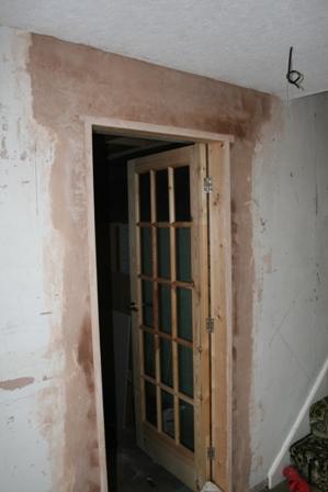

Hi, I'm new to DIYnot so I hope somebody can help. I'm planning to convert part of my integral garage into a room and have a few questions. I’ve fitted kitchens and bathrooms and refurbished rooms but never carried out such a large project.
1. I wish to install a new door from the hall into what will be the new room. This is an external wall with a cavity. I'm planning to use 2 concrete lintels 1200mm long but I’m unsure of the size. The wall is supporting the joists of the first floor.

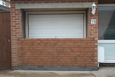

2. I’m planning to infill the garage door with a windows and UPVC cladding on a timber frame below. So the frame is not on the floor I shall lay 3 courses of blue bricks on the existing garage floor. Is this OK?

[quote="the-shack";p="1109658"1.
sounds good so far.
even though there is insubstantial weight going on the slab, it still may not be adequate, or you may need to prove the slab is strong enough to deal with the load.

You did not say what size lintel to use. Wickes sell 100x70x1200 would these be OK?

100 x 75mm (1200mm long) pcc lintels are, in most cases, ok.

Had to take a break from the conversion but it's all go. I have had the BCO officer around and he has OK'ed the bricking up of the door without new foundations. I have had a builder round to do this and the window went in a week ago so I'm all weather proof now. The insulation comes tomorrow so looks like I'm having a busy weekend.

Below are some pictures of the work so far. You can see the new door into the hall and the front wall before the window went in. You can also see the garage door behind the new wall. I moved it back a couple of feet to allow the builder to do his stuff and keep the garage secure.
