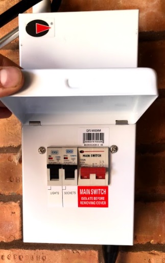

I have a dethatched garage which currently has a small 2-way CU - 100amp Main Switch, B6 for lights and B16 for sockets.
(Pic attached).
We are doing a basic conversion on the garage into office space. Meaning I'll add probably 1 additional 2-gang socket.
We will be running some office equipment plus 1 or 2 electric heaters from the space, nothing to meaty.
Lighting-wise we wont be adding to the load so sure the B6 will be fine.
Sockets-wise I'm concerned we may overload it a bit.
Since we have a 100A Mains Switch, should the B16 be able to be switched out for a B32?
Any advice appreciated.

In that case it was installed by an idiot. There is no point in having a 16 amp MCB fed off a 13 amp fuse. Even less point in having a 32 amp MCB.
Yeah. Posting this thread promoted me to check the internal fuse, to find its 13A. Was installed by the developers ... hmmm
What size heaters do you what - a couple of 1KW?
2 x 1KW heaters is approx 8 amps
Computer and screen maybe another 2 amps
So that 10 amps on a cold day. Assuming you don't have a dryer / freezer in the garage then you should be okay on what you currently have but it's getting a bit close.
I would like to understand where this spur is off. If it's a kitchen ring then you're adding another 10 amps onto that circuit which might cause issues - and they are heaters so it's a continuous load not a burst.
Also - what cable have they used to get the power to the garage? You say it's a detached garage so I'm assuming it's buried. I'm hoping they used SWA but the driving a sub-CU off a spur from an existing circuit makes me wonder.
Personally I would run a separate circuit from the main CU on a 20 or 32 amp. Find a sparky that's happy for you to do the drilling / digging the trench and it shouldn't cost a lot. If you add the sockets onto the existing power circuit in the garage before they come (you're allowed - it's not notifiable) then the sparky would test as part of their testing of the new feed to give you some piece of mind (they won't give you a cert or anything like that - but they have to make sure it's safe because they've changed the design of the feed to the CU)

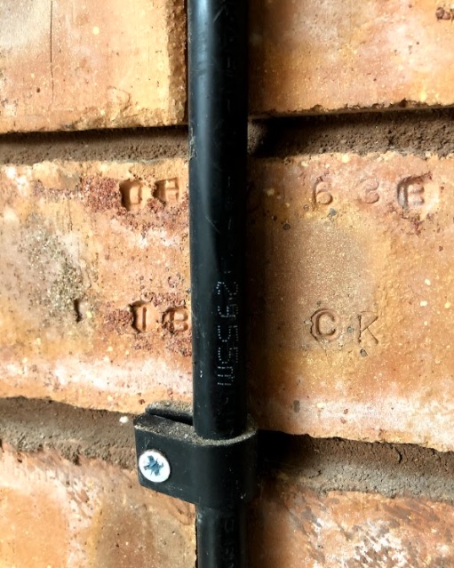

I've attached a pic of the cable from house to consumer - although is this just the conduit, so hard to tell ... ?
Through wall and straight into a 13A fused socket ... but I'm a bit unsure what feeds that ...
