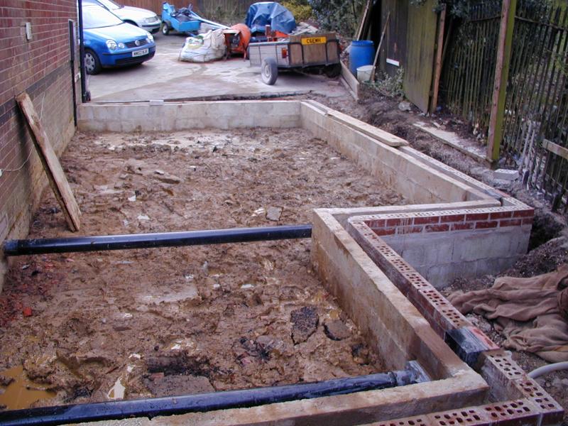

ok update.
Building control came round and had a constructive debate (ha ha) with him.
He eventually relented and agreed that a suspended floor was overkill for a garage, BUT......

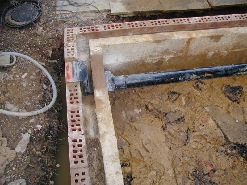

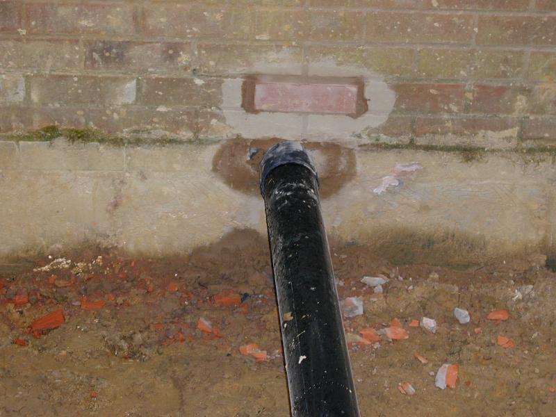

Because the existing airbricks would now be inside the garage he insisted that I fit ducting under my new solid floor and through the new side wall to a new airbrick, to give the existing suspended floor ventilation. Due to the fact that the existing airbricks would have now been inside a garage, he was very wary about fumes from exhausts getting under the house floor. Fair point.
So I have had to raise my garage floor level and remove bricks below the existing airbricks to fit a duct direct into the underfloor void and channel it across where my new floor is going using 110mm soil pipe, and into the new cavity wall, where I have fitted a telescopic vent to bring it upto DPC and a new airbrick.
I have had to do this for 2 existing airbricks.
Hopefully this will satisfy him (he's coming out to have a look this week) and I can get my floor down.
Just a bit of info for anyone interested, I had a nightmare finding the adapters to go from a brick sized rectangle to a 110mm round pipe (apparently they don't do a rectangular channel)
Eventually tracked some down. Travis had to order then specially. They are made by a company called Manthorpe and they cost £10 each.
