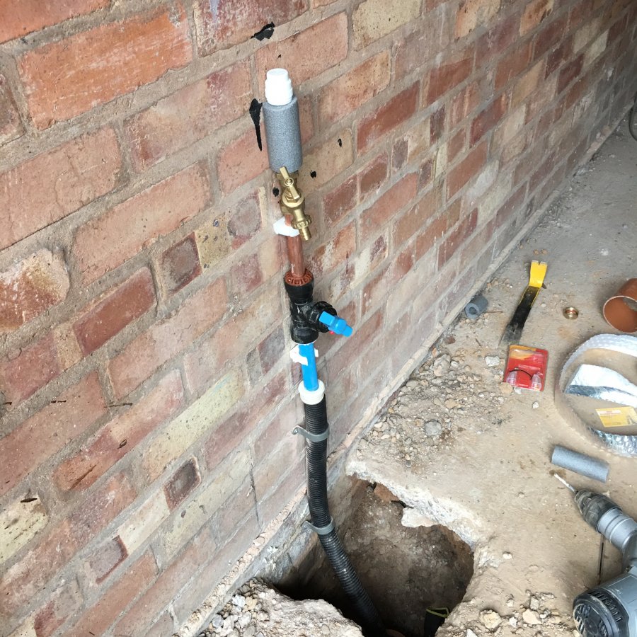

I presume the picture attached means you can see the DPC and I shouldn't plaster? Is that the general rule because the plaster could get damp?
As I am not plastering my next option is to leave it brick or use masonry paint. Not sure which:)

I can't see enough from your picture. There seems to be a upward folded edge of plastic, but I can't decide its from the floor slab or the wall.
Where you have dug your hole, the damp bit of wall is clearly visible, unless its dirty from the soil. The wall in general looks dry but. . . .

If the wall has a DPC then you can plaster above it. If the DPC is low down, then you can cloak the wet part of the wall with a plastic moulding. I think, starting at the house wall itself, find out the location of the DPC as it runs around the garage. I would have thought that it would have been all put in at the same level. The garage floor membrane should have been lapped on to it (perhaps where that turn up is?), but in the end the garage floor screed has to be at ground level, unless you want steps up to it!
