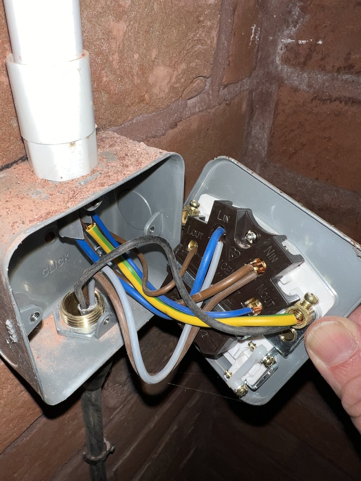

Hi all, appreciate if anyone could give me an advice on my situation.
In my garage there is a 1 gang light switch, when I open the box to look at the wiring situation, I found that the switch is not only controlling the light but also wiring to another twin socket in the garage. I have attached a photo for all your reference, it seems that the input wire is a 3 phase wire containing Brown, Grey and Black wires. And when looking at the wiring, both Brown wires (from supply & the one to the socket) are connected together at "NIN" and1 Blue to socket and 1 Grey from supply connected at "LIN". May I ask whether it's correct or not? As I understand, Brown should be Live and Blue (or Grey in 3 phase) should be Neutral.
Besides, my ultimate goal is to change the 1 gang to a 2 gang switch by using the extra gang to control an additional Floodlight which will be attached to the garage wall. In such case, can I still do this by an easy switch over or do I need to add a new switch by cutting the light wire in the middle and do with a function box?

Well - that's a bit of a cock-up isn't it?
Could you let us know how the supply cable is connected at its other end?

You are correct, thay are reversed and shoud be corrected.
Assuming the supply from the consumer unit is 16 or 20A, the light therefore requires a 3A or 5A fuse, it appears this may a switched fused connection unit for that fuse
The correct thing to do would be to add an additional switch, either the same as you have or a 2G switch after the existing switch.
When you've swapped the Lin and Nin around fit another Fused connection unit next to that one (using a 20mm coupler and 2 bushes) fed from Lin and Nin to feed your new light.
Obviously power off before swapping anything.
