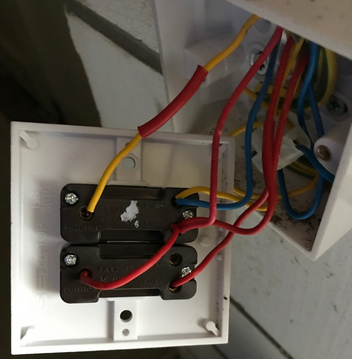

I have purchased a 2-gang Energenie light switch for my garage because I want to control the external garage wall light remotely.

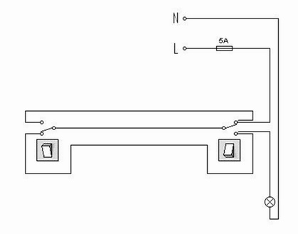

The garage light switch is currently a 2-gang. One of the gangs controls the outside light (1 way) and the other gang controls the internal garage light and is wired in a 2-way configuration with a light switch that is adjacent to another entrance to the garage.
I have successfully changed a 2-Gang 1-way switch for an Energenie RF switch. It is the 2-way wiring that is giving me a headache.

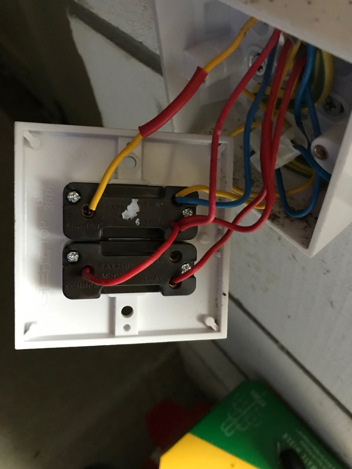

Above is a picture of the wiring.
The Energene switch has connections L (common 1),L1 (Line Out 1), Lx (Common 2) and L2 (Line Out 2). It also has an S connection for a slave switch that I do not intend to use.
Basically I want to remove the switch completely that is by another Garage entrance and replace the 2-gang standard switch with the Energenie unit.
Can someone explain simply how I remove the 2-way wiring and then reconnect pin 2 gang 1 way configuration for the 2 lights?
