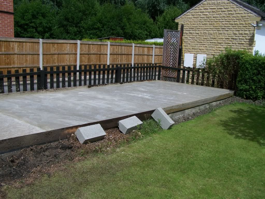

Well had the 20ftx10ft sectional garage up for 3 years and after the last couple of bad winters where it was freezing inside i've now added some insulation.

Start - base layed

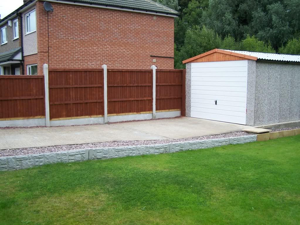

Garage built
Fence errected behind

Anyhow, really well done, if you dont mind me saying so. Your attention to detail and forethought are great. And i must say that i feel a little moist when i see that clean arris on the slab.
