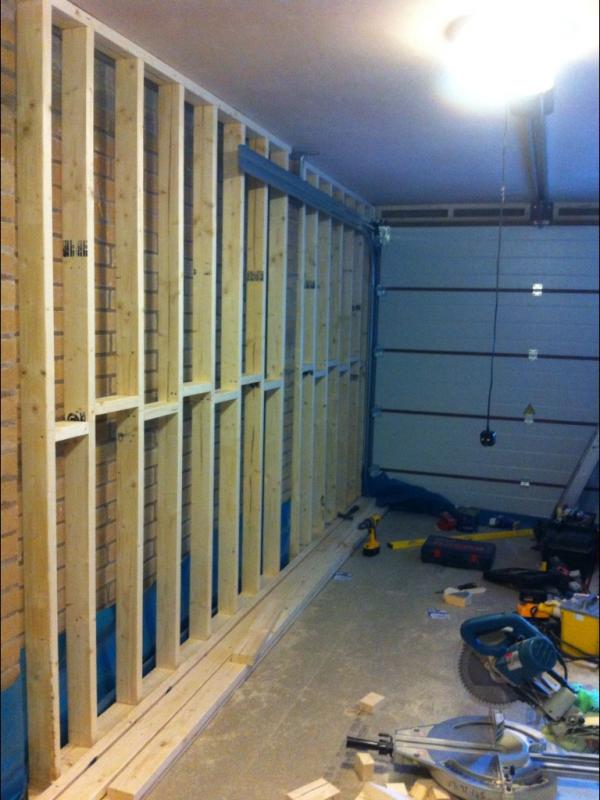

In the process of installing studwork to my single brick garage wall. The studwork is sat away from the brick wall and I will be fitting celotex insulation boards within the studs then plasterboard with a moisture barrier.
Am I right in thinking I need to fit a membrane on the back side of the studwork? If so will standard roofing membrane do?
When installing this I would plan to nail it to the back of the studwork horizontally starting from the bottom and lap the joints. I would also ensure the bottom piece is placed behind the floor dpm. Does this sound right? Do I need to tape the joints?

A breathable permeable membrane is required on the back side of the studwork to stop ingress of water from the brickwork and allow moisture to escape from within the studwork.

If you have a gap between the stud/board and the brick wall, I'm not sure you'd even need a breathable membrane - others will no doubt correct me if not the case.
When I insulated a single-brick cupboard, I used breathable roofing membrane; I attached it to the wall using DPM jointing tape, because I happened to have some knocking around. Due to space constraints, I did not leave a gap between the wall (the wall was always dry).

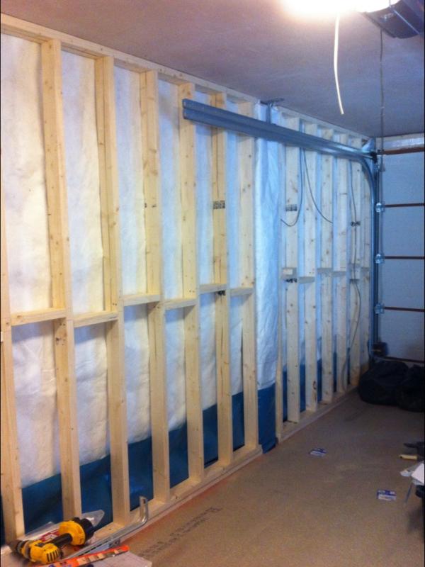

I decided to use Tyvek house wrap for the membrane

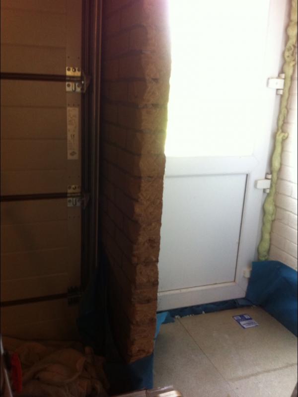

Just ready for the insulation to be added. Do you think I need to seal/tape the joint between the house wrap and the dpm?

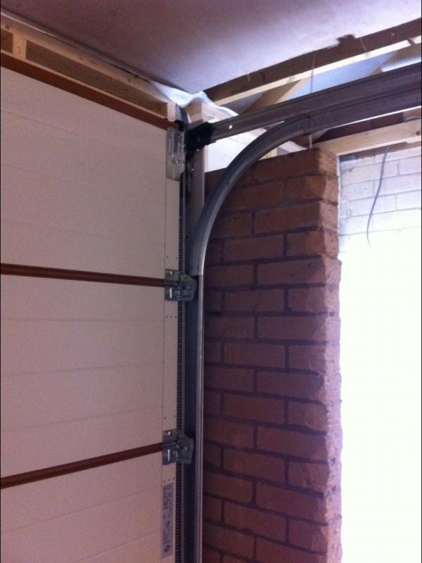

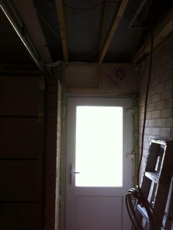

The only problem I have is what to do with this part of the wall. There was a wall removed (non load bearing) and this small part was left as it strengthens the pillar at the front of the garage. This will be built up to ceiling level. I want this to be plastered but there is no no cavity between this and the external pillar. Wondering if insulated plasterboard would be acceptable or could there be a problem with damp?
Any suggestions are appreciated?

I don't think you'd need to tape the joint, especially as the DPM comes up a fair way.
As for covering that small section, I don't know; I suppose in your position I'd be tempted to affix some leftover membrane and board over. It really depends on how much water the wall takes in during wet and windy weather.
