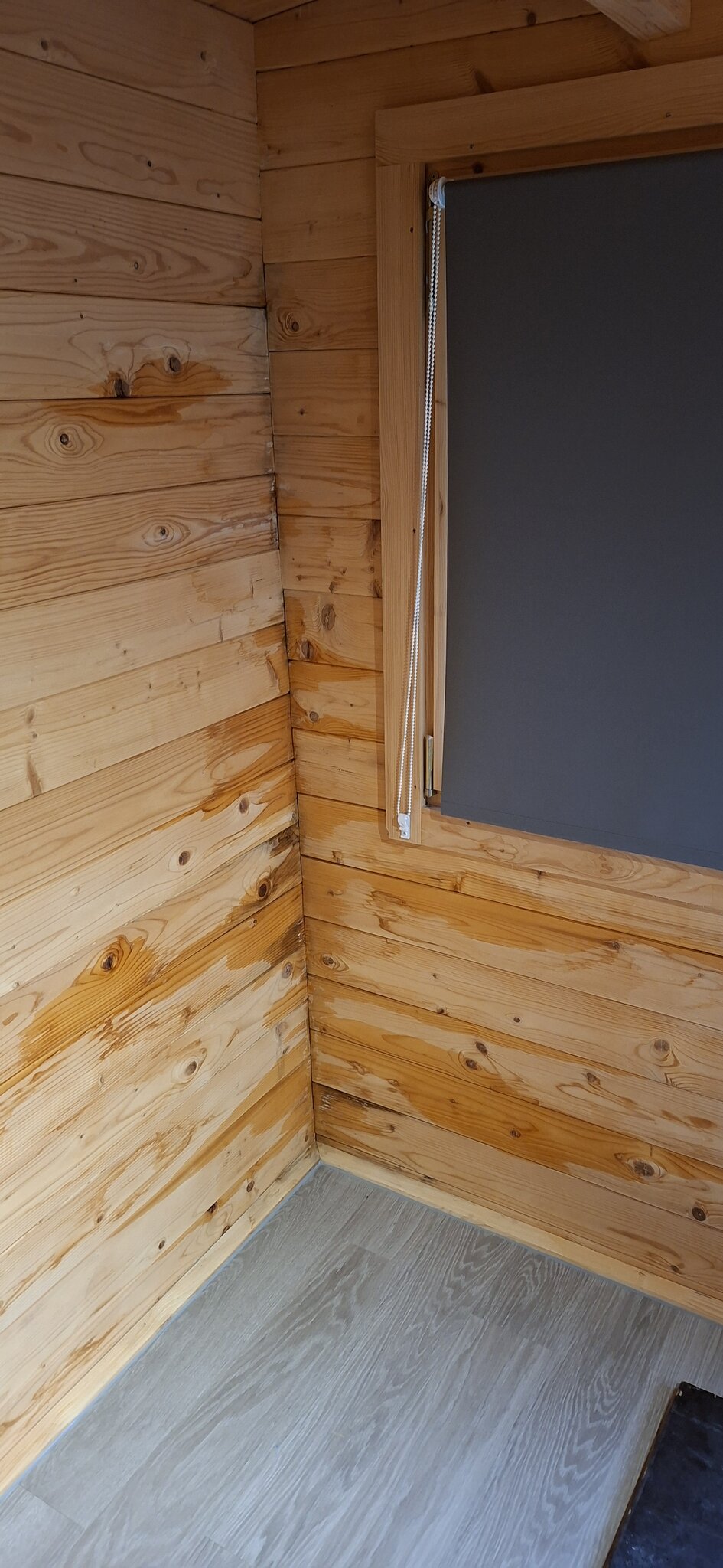

Hello all,
My first post having just bought my first house.
I have a cabin in the garden (already there when I moved in) which is only a few years old but is leaking water through the wood as shown in the photos all around the cabin.
Exterior of the cabin is painted (albeit a few years ago I imagine) and the roof has a decent overhang with gutters fitted.
What would be the best course of action? I assume a repaint on the outside but any recommendations of products to use?
Many thanks in advance
Show us the outside, and the guttering, especially above the wet patches.
Go outside and look at it during rain. I strongly suspect water is dripping or running down the wall.
Paint is not a waterproofer.

Thank you. Will provide some photos when the rain stops!

If that's the only area that is leaking I would have a look at the corner posts. It may need a bead of silicon running down the outside of each one.

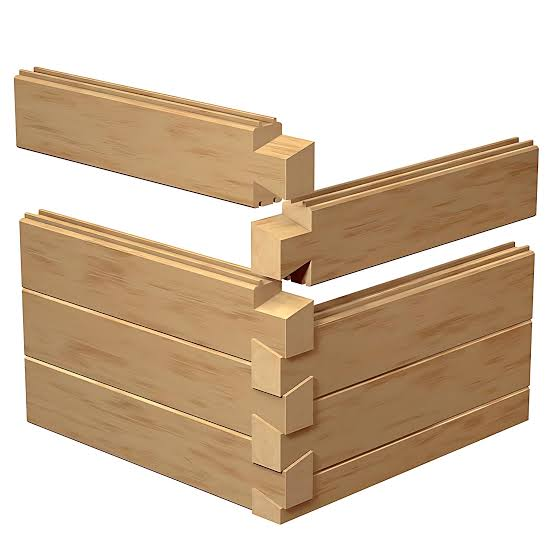

"Log" cabins usually have the boards notched at the ends so they interlock, and the ends stick out at the corners. They do not have a corner post. The 'logs" are T&G or have a loose tongue so it us difficult for water to get inside along the flat wall.
If the gutter had failed at the corner joint, water could run down the corner joints of the "logs" and give the leak pattern we see.

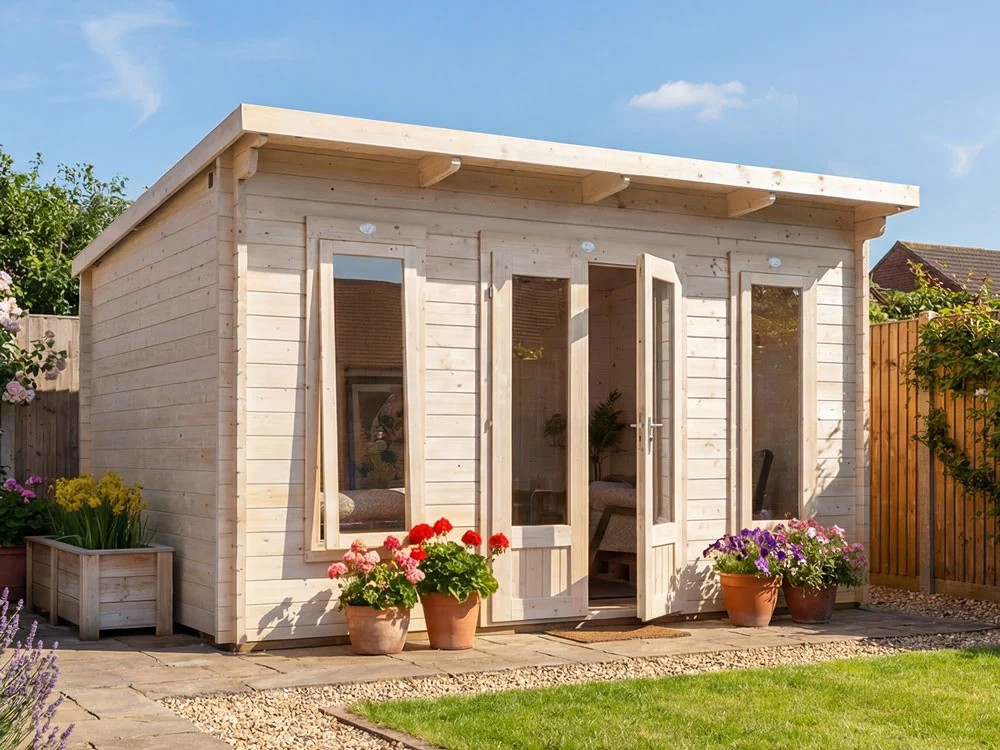

You can just make out the interlocked corners on this one. They call it a log cabin but you can see it is really flat boards. I think they are imported as kits from Finland.

Here we are.
The ones I've seen have a simple square notch, this picture shows improved angled cuts where gravity helps pull the boards together,
