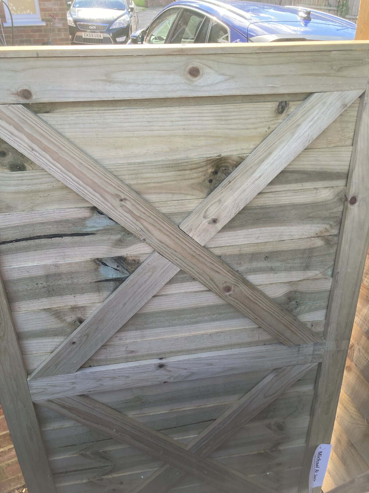

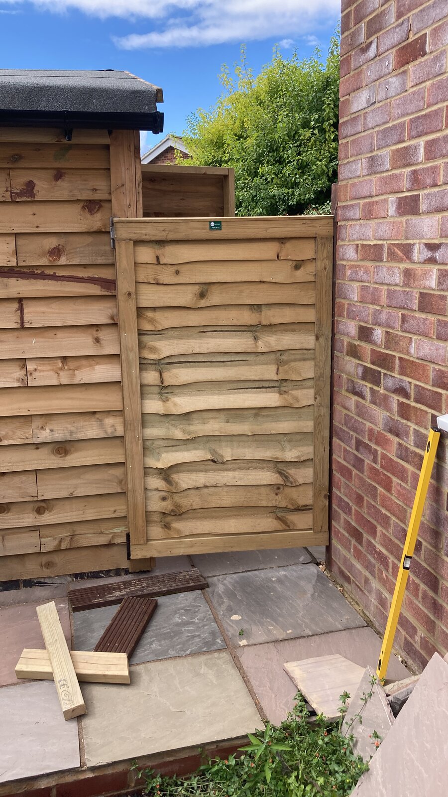

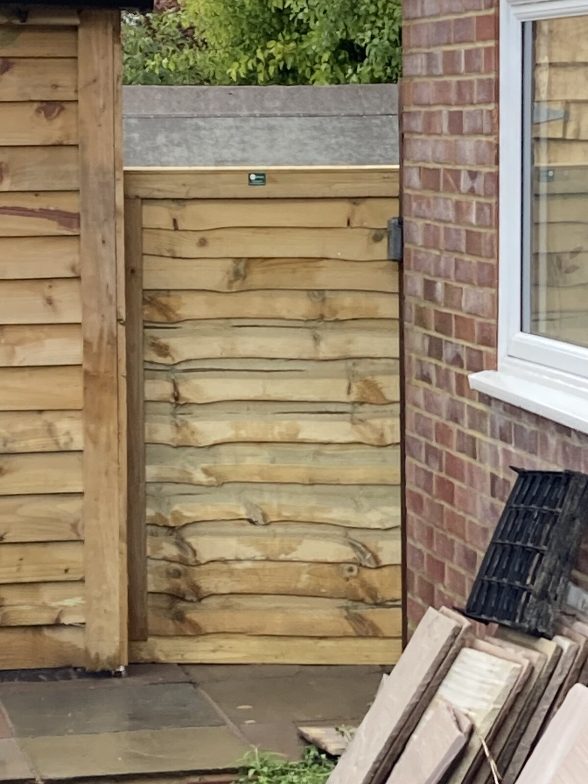

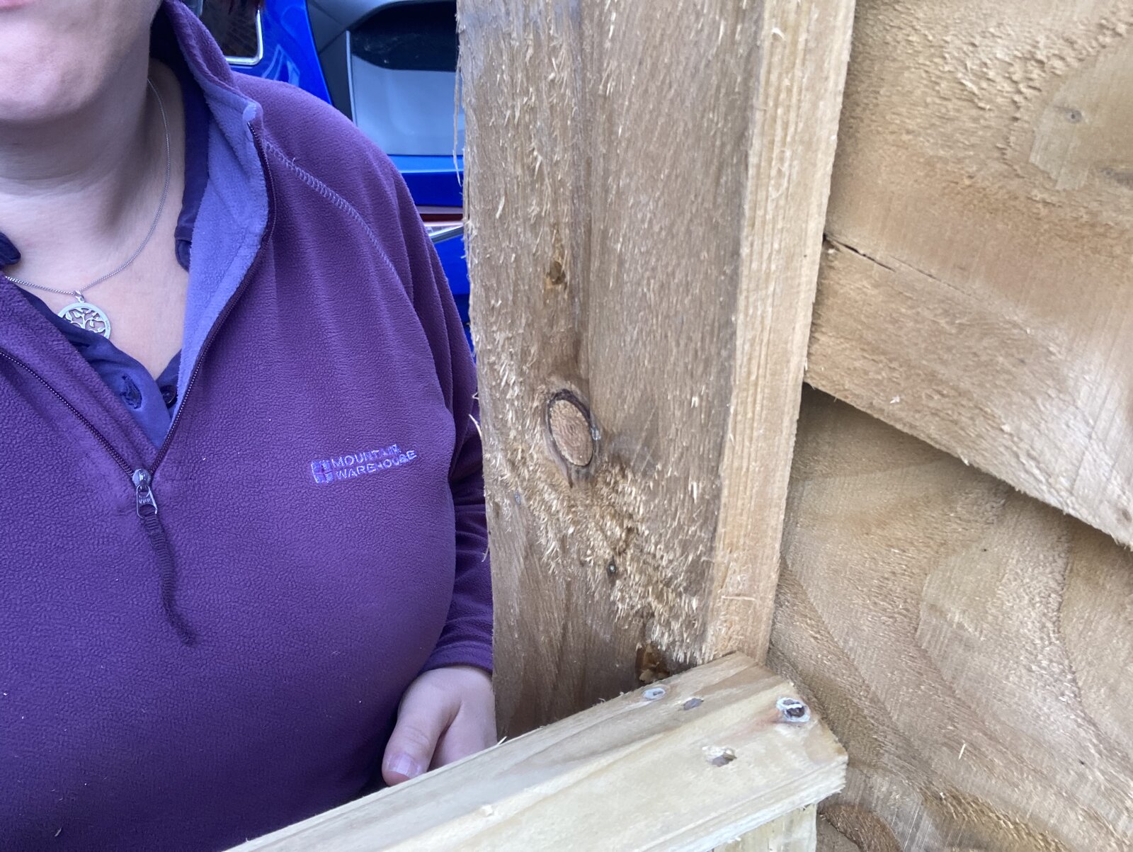

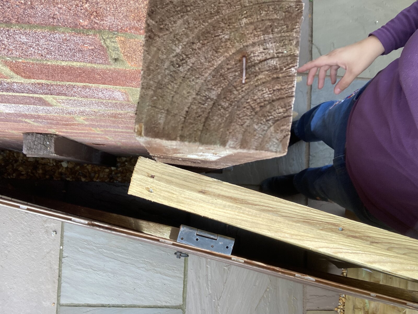

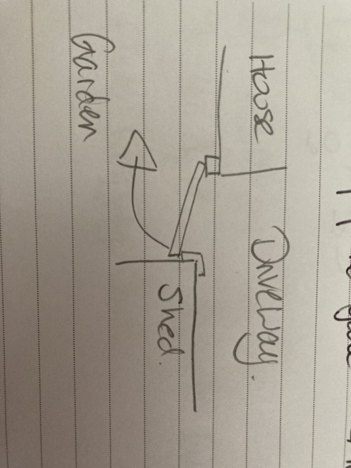

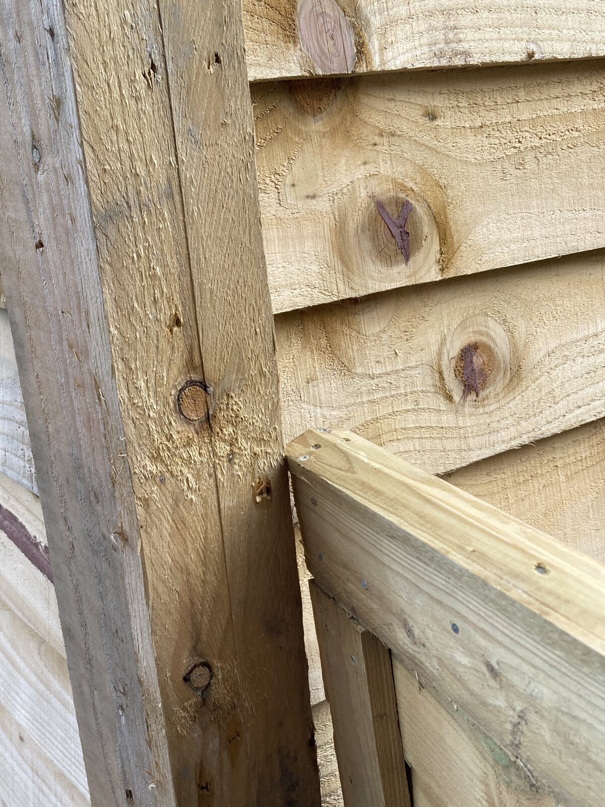

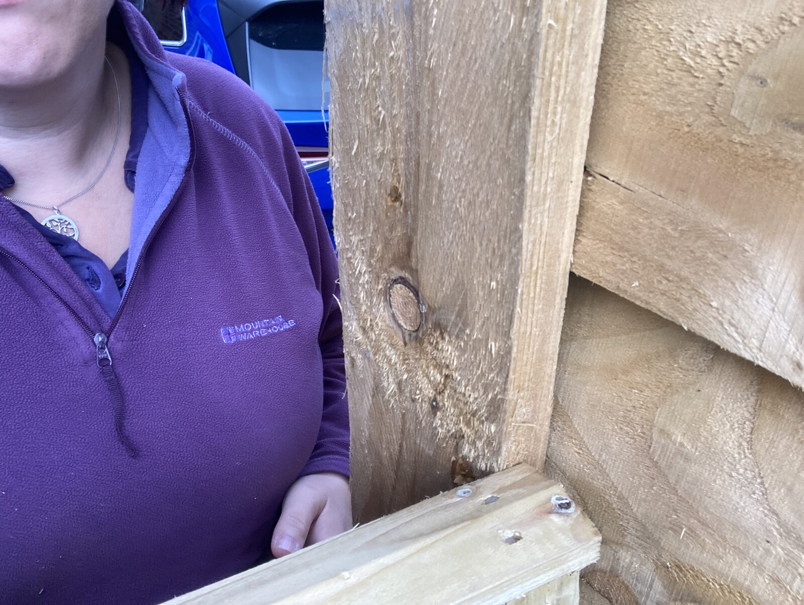

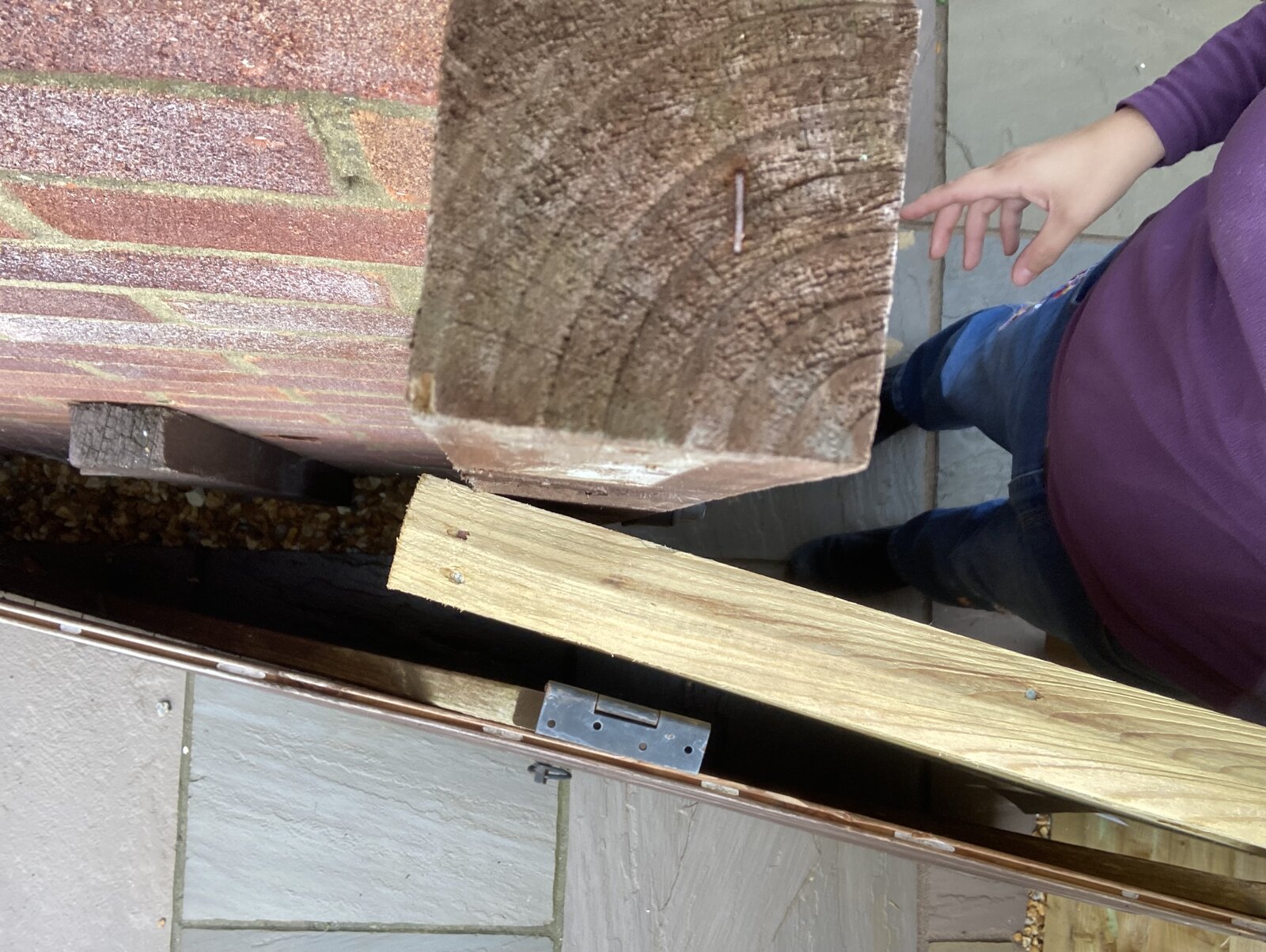

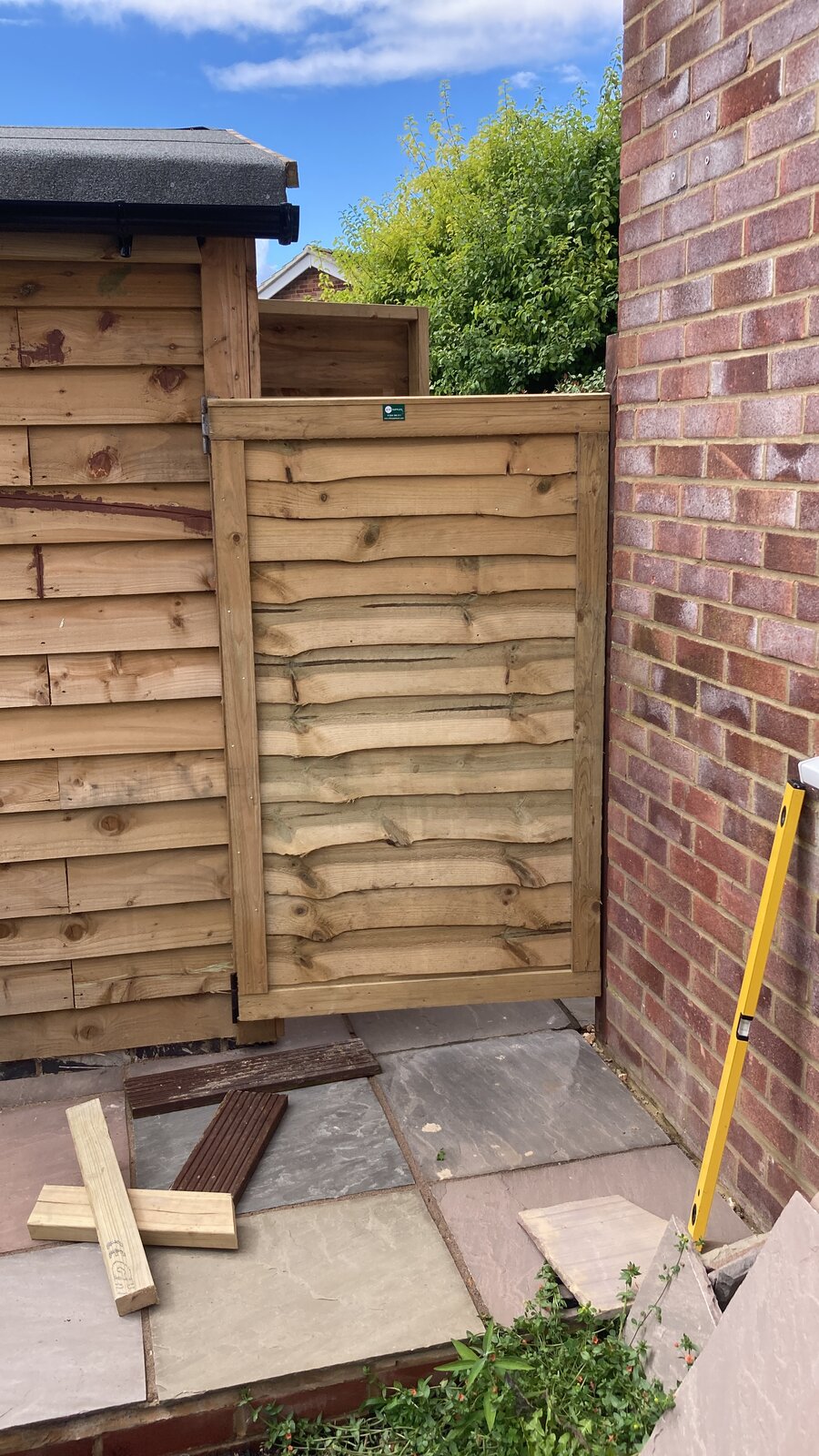

Hi - I was hoping someone could help. We had a new patio and garden shed built, sadly before it could all be completed our builder dissapeared. We are finishing off ourselves and have purchased a standard size garden gate to finish it off. Hopefully the photos and diagram I attached will help me to explain.
There is already a post attached to the house as indicated on the diagram (not to scale) - to enable fixing of hinge to the inside of the gate to allow it too open inwards to site against the house I think I need a cranked hinge but I’m struggling to find one that I think would work.
If I use a “cranked hook plate” hinge can I reverse it so it “curves around the gate”????
Any suggestions please
you need the hinge on the back off the gate as any hinge on the face will only open to around 110% ish
strait hinge will work but the post needs to be in the normal at end off [side off]gate for simplicity
you can overcomplicate and use hinges in other positions or faces but you then get swing and gate position when closed and open with unusual angles and clearances that may or may not be a problem

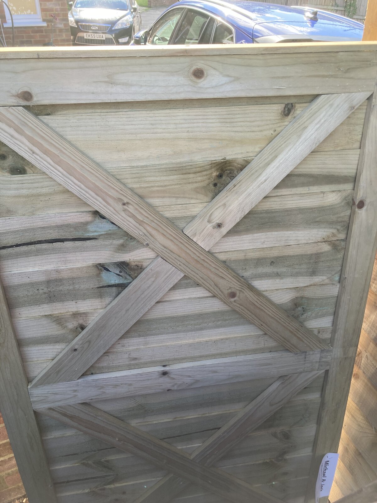

Looks more like a fence panel than a gate to be. If there isn't a diagonal brace on the back, don't use it as a gate; it will collapse
For hinges a hook and band cranked one should allow you a 180 degree swing that tucks the gate against the wall when fully open and hold it at an angle that makes it look more straight when closed.
Don't fixate on buying a standard size gate that is unsuitable; gates are every easy to make
I have tried making a gate in the past to no avail - it failed pretty quickly just lucky I didn’t need to open it - this gate needs to be used often.. This is a gate - it has the cross braces etc on the other side - purchased to “blend” with the shed.
I have always been taught that a gate should “open inwards” so you push it closed against intruders - but I’m thinking it’s a 5ft gate so that’s probably null and void so think I’ll just attach the gate to the shed on the “outside” and use a standard T hinge
