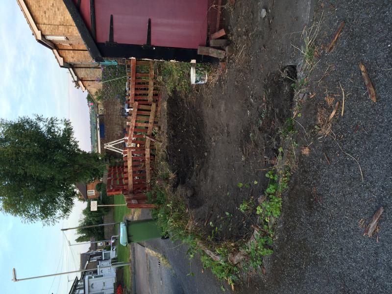

Hi
I have read a lot on these forums and found the responses very helpful in the past however on this occasion I can not find anything on this.
I have a garden which is split up by an old garage, roughly 1/3 of my garden between the house and the garage then the garage covers 1/3 and the other 1/3 is behind the garage and is forgotten about.
We want to remove the garage (simple) and open the garden up so it is one space. I would like to build decking to cover where the garage currently stands and the area behind the garage. However the ground raises about 2 feet from the edge of the garage to the pavement.

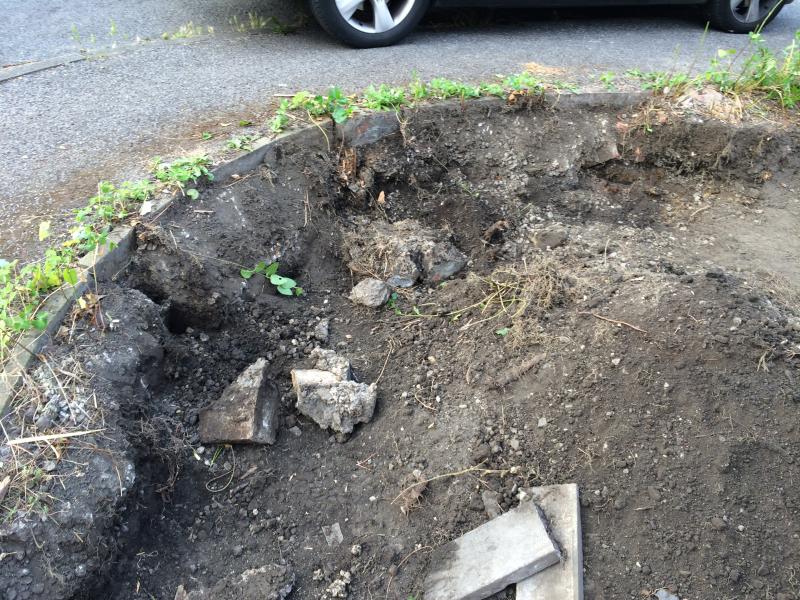

So I have started to dig out the garden to try and bring the level as close to that of the garage concrete base as possible. I have hit a snag, the concrete that is holding the pavement edging in bulges into my land almost a foot. I am wanting to have a new fence put in so from the deck I will see 2 feet of gravel boards up to the level of the pavement and 5" of fence from the pavement.
Now at the moment I have big lumps of concrete holding the pavement together in the way of the fencing I want to put in as i do not want to loose a foot all around my boarder.
I have thought of a few possible solutions but I am not sure which are viable so would appreciate your input.
1 - Remove the concrete bulges and put the fence in with the gravel boards and infill between the gravel boards and pavement with gravel.
2 - Remove the concrete bulges and put the fence posts in and then between the posts build a retaining wall with concrete bricks and infill between the wall and pavement with concrete before putting the fence panels in.
3 - Remove the concrete bulges and screen off the boarder with timber and place the fence posts and pour full of concrete to set the fence posts and effectively make a retaining concrete block.
Thanks in advance!

Hi, thanks for your reply, please see these pictures which i hope help.
Picture of the rear garden area
Picture of the concrete bulges in the high corner
The pavement goes up in the corner more than across the rest of the garden so at the highest point it will have to be retained roughly two feet.

Okay no worries thanks for your input I will look into PP as a separate issues. Going back to the original question do you know the best way to support the pavement once I dig out and remove the concrete bulges currently supporting it?

As for the kerbs, the bulge you describe is the haunching to stop the kerbs shifting side ways and the pavement sinking. Removing it may unsettle the kerbs if you just smash it.
Ideally leave a couple of inches of it in place by cutting off the excess. As for retaining the area concrete gravel boards would be ideal although they don't go round a curve very well so a small masonary wall would be better but a lot more work.
Fill any gap between the kerbs and gravel boards/wall with a lean mix concrete. Something like
6 gravel
3 sand
1 cement
This will form a solid chunk to stop the kerbs moving and relieve pressure on your gravel boards but won't be too bad should it ever need broken out.
This is assuming the pavement falls away from your gravel boards and there is not a lot of water draining into this area.
Thanks r896neo exactly what I was hoping for. Do you have any suggestions of how to trim the concrete? I fear if I use a chisel it will just break the lot off from the pavement anyway. The only thought I had was to borrow a angle grinder but don't know how practice this is?
ideally cut it with a stihl saw or angle grinder.
You can break it with a chisel but may unsettle the kerbs as the bedding and haunching will all be one solid lump.
