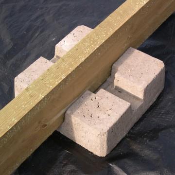

I am planning on building an office in my garden on an existing patio covered with concrete slabs. It's going to be 14'x10' & I would appreciate your comments or suggestions on the base.
Bearing in mind I already have the concrete slabs laid, I plan on using a pre cast concrete deck pier/deck block on which I would place the 4x2 frame with joists 16" on centre. I would then use 75mm polyurethane foil back insulation and then 18mm t&g OSB to cover the entire area. The vapour barrier I was thinking would be placed between the deck block and the 4x2 frame.

It will be built out of timber 4x2 and here is a pic of the pre cast concrete deck:

Why not just use ordinary concrete blocks, it won't blow away!
I suppose that would work but would it be a good idea to mount the structure on blocks? I cannot understand why or how important it is to have air circulate underneath the structure...... any suggestions as to the benefits? Thanks
I see. So it's a timber building. It wouldn't do any harm to fit small sheet of poly between the timber and the block - although it's probably not necessary. If there is continuous ventilation below the floor you don't need a dpm. The vapour barrier must be on the warm side of the insulation. My advice would be timber joists overboarded with treated OSB or similar. Insulation can go directly on top of that with vapour barrier over and then finish with a floating floor of 18mm P5 grade moisture resistant T&G chipboard. If you want to get rid of the deck blocks ordinary concrete blocks - or maybe engineering bricks - would do the job just as well.
Raising the timber is less about allowing air flow and more about trying to keep the timbers off the floor (and thus dry).
