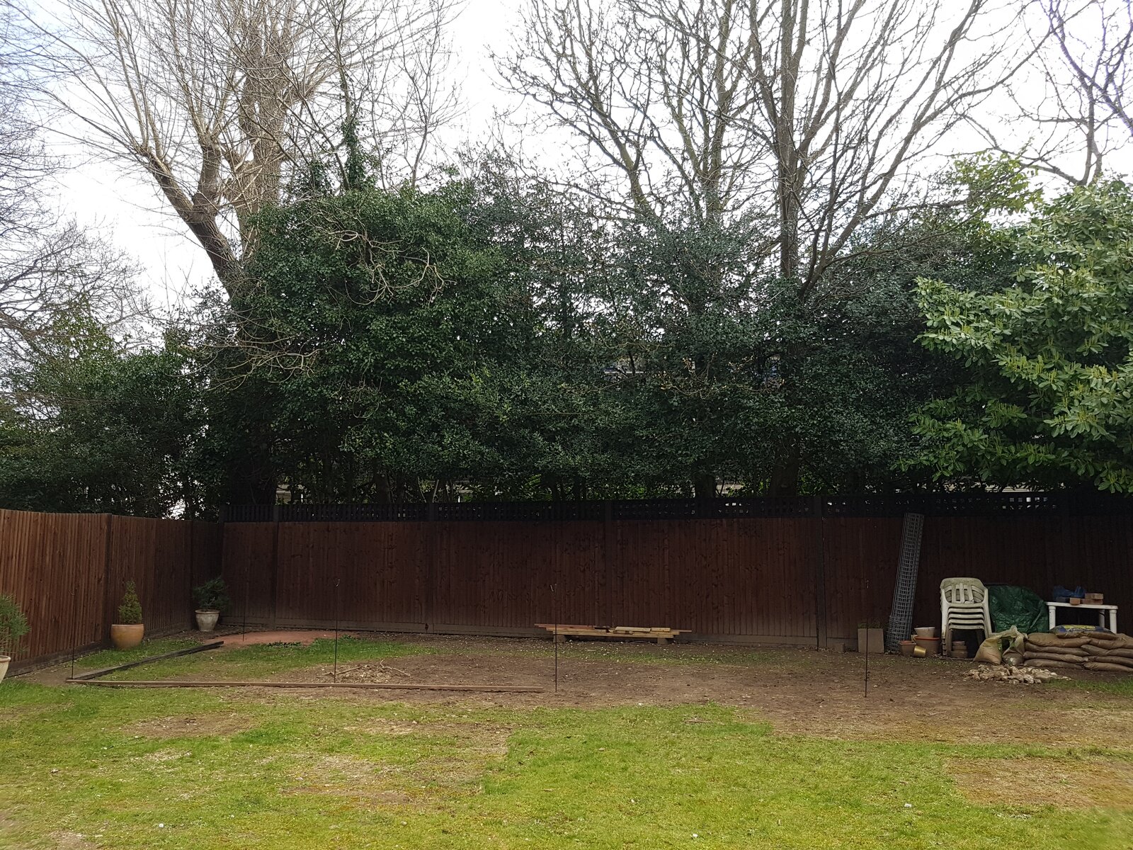

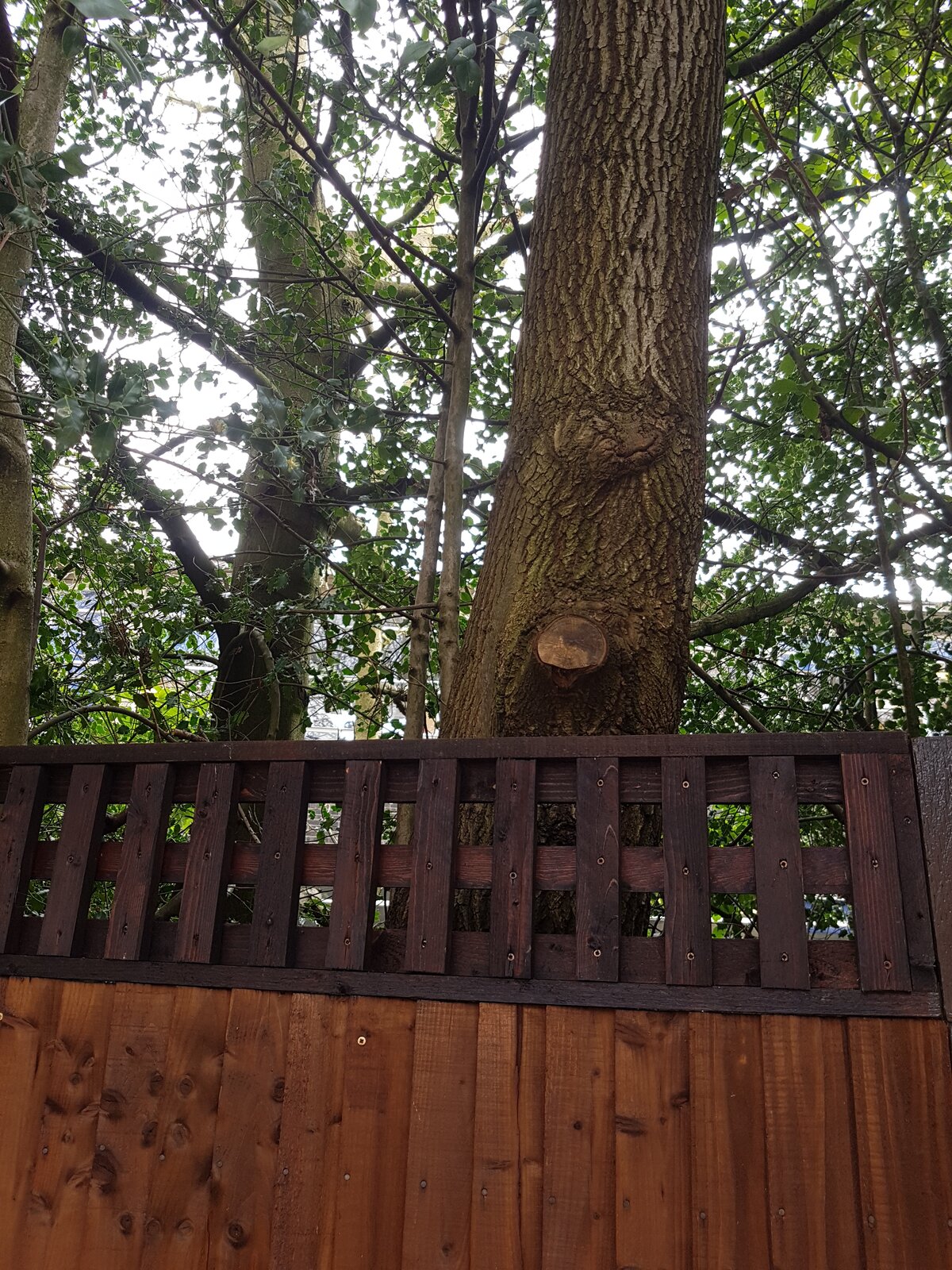

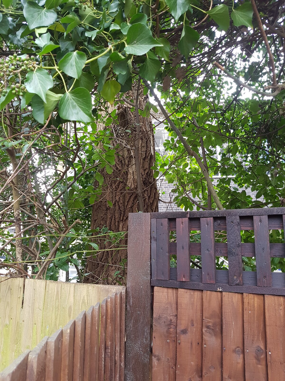

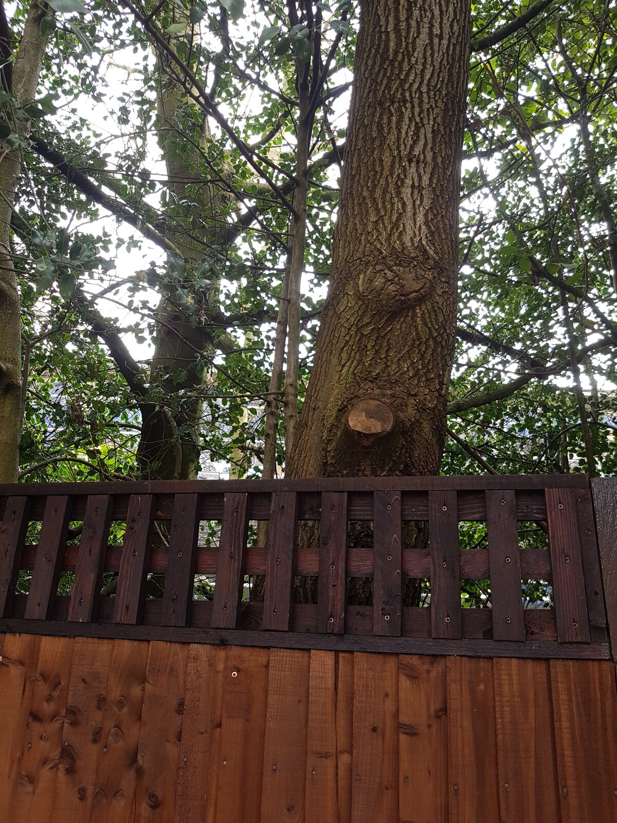

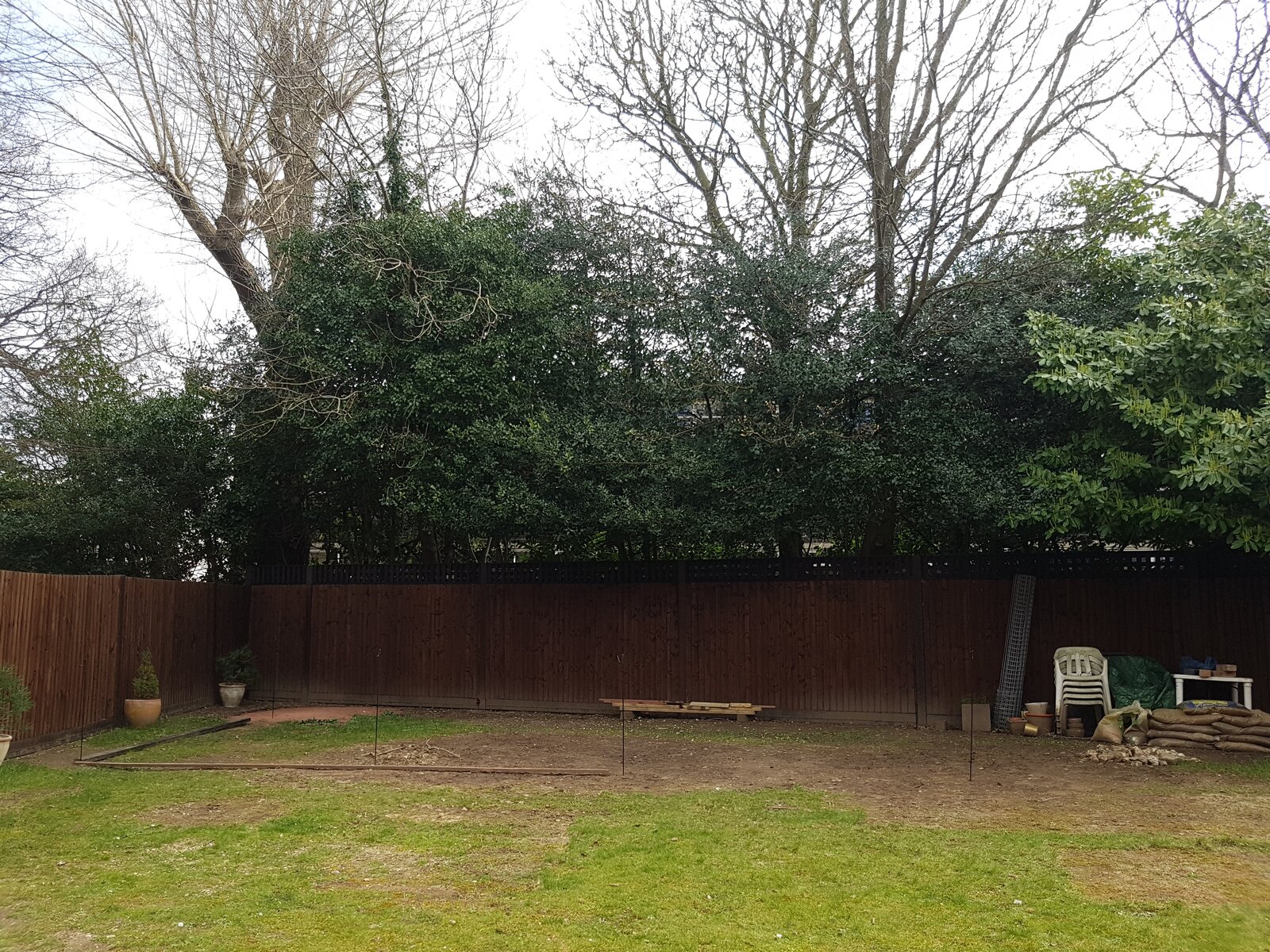

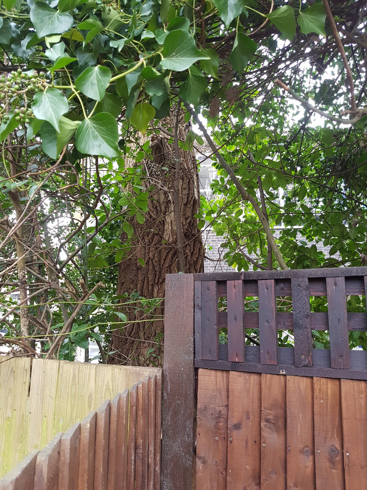

Hello,
I am looking to build a garden room ideally 8 x 3.5m. However behind my fence there are a lot of tree's and bushes, keeping these trees healthly is important since they act as a screen between my house and a college building behind them. There is quite a big Oak tree that sits right behind my fence and a Chesnut tree with an 60cm meter wide trunk a metre away from the back of my fence.
I know the soil in my garden is going to be pretty tangled up with roots, so I was thinking to build my garden room on concrete blocks, on a 10cm layer of MOT Type 1. Then placing a weed membrane in between the blocks. Then followed by a garden frame etc
I thought this method would still allow air flow underneath the building so the soil could still stay slightly oxygentated which would benefit the roots, although I am not sure how the weed membrane would effect that.
Any advice or feedback about the best foundation option for this situation, or tree knowledge is much appreciated.
I roughly laid out the building dimensions with stakes, please see attached pictures
Thanks,
Antony

The issue with roots is not the root damaging foundations or the root not getting oxygen, but the moisture that the root extracts from the ground which could cause the ground to shrink, and the foundations to subside or move. Or if trees and shrubs are removed the subsequent swelling of the ground due to excess moisture.
Weed membranes are of no use in this context, unless you want to stop weeds.
Large established tress will not tend to cause much of a problem, but otherwise a raft foundation may be more appropriate, or deeper foundations than normal.
