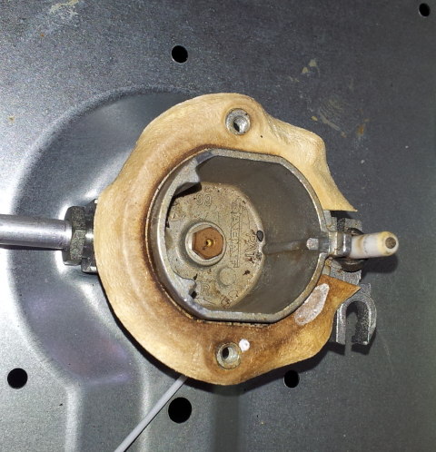

The gasket I am interested to replace is pictured. It's papery, leathery, and probably fibrous. Anyone knows what materials is this and what kind of temperature it is expected to handle in that position under the hob cover? Buying the original part is unlikely as it is an old hob. The gasket is estimated to be 0.8mm thick.

I would have thought the gasket is more of a paper work. It's not there to seal the gas. It's there to seal against cooking spills. Do you reckon Flexoid is good enough? It's for oil and water, but nothing about temperature.
.. just found out flexoid is rated for 120°C. It does look the right colour. The high temperature gaskets are blue or grey for 250C continuous.
