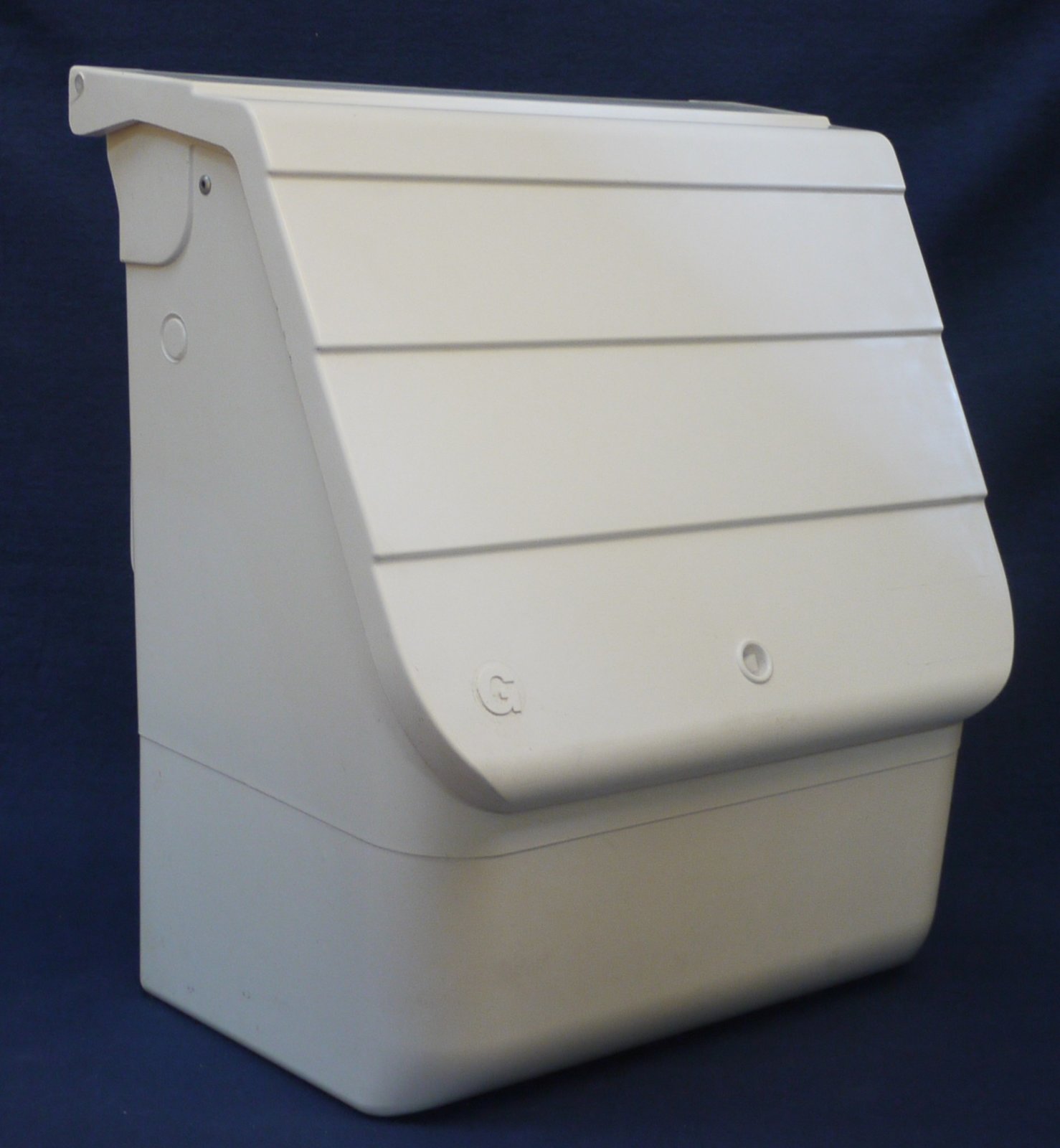

SGN surveyor came round and went over two options. One is the recessed meter box and the other is a semi-concealed type meter box. We have cavity fill insulation installed, it's the blown type. He did say that his recommended option is the semi-concealed box, but reposition around the corner and therefore out of the way of wheelchair traffic.
So couple of questions to help me decide....the semi-concealed box looks like this... 1_3.jpg the description says it can be partly buried in the ground (in our case blocked paving) is that usually possible? The surveyor did say something about smart meters being sensitive to damp in part buried boxes, but I think he was referring to the older style which had more of the box below ground.
Does cutting a hole in the wall present other problems? Those boxes are 160mm deep, will that mean the inner skin will have to be cut away to take the depth?
Cost wise is very similar.
I just cut the outer skin of mine and then sealed it in with expanding foam. It was easy to do, 4 saw cuts then wiggle the bricks out. Once I pressed the box in I leant a plank and a slab against it while the foam cured.
I think the recess box comes in two parts, the box that goes in the wall/cavity and an architrave part that is screwed to the box and sits flush on the wall. Is that correct?
Then if I am correct the incoming pipe is fitted within the architrave section by the network guy.
Yes, 1 part and you can't drill it to fix it or they will refuse it.
