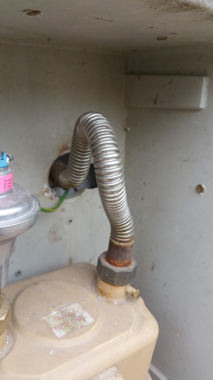

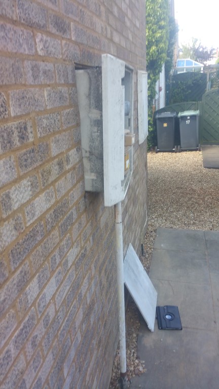

I disagree , if Southern gas fitted it and the garage door will strike it if opened then in my humble opinion it is At Risk, sadly the bodies that are paid to help you , Gas Safe wont go out of their way to take on Southern Gas, I would call them anyway and say you think that southern gas have left a potentially dangerous situation at your property and see what they do about it, please let us know what if anything they do
ye i agree but would the gas company really fit a meter ( company) " AT RISK " , but I've never seen them do anything so wrong , i just think theres more to the story thats not being said because fitting a meter in such an obvious AT RISK state surely they wouldn't be that stupid , will they ???
Yep phone gas safe they will come out for free and tell southern that you have called them you might be surprised how quickly they change their tune . alternate phone it in as a leak and 99% of the guys will see its fitted wrong and alter it free of charge
112 are there surveys detailed enough to have seen what has really happened ? or would they just do it to cause less hassle ?
Emergency guy would just look at it see straight away someone has feked up and alter position .
if service needed moving he would report back to his manager (not office) that it needs moving and if its same as grid phone the outside team manager tell him and the just raise a revisit on his computer and would be done in couple of weeks max
ah right so no investigation as such so really the original installer would have nothin to answer to ( regarding at risk situation ), so that makes sense now

It would seem that the EC could be turned off and an RGI could move the meter back about 2 m so that the door no longer hits it.
Its not something that all RGIs would be prepared to do, but it would probably solve the problem and no one would ever blink an eyelid afterwards!
It started off like this:
Had been that way for years.
I refused to connect the boiler to it (had to put a new supply up the back wall of the house to the eaves).
All they had to do was change the angle of the spigot bend at the foot of the pipe to bring the riser to the wall and refit a new box (which they eventually found at the yard but couldn't be a7sed to use).

Going back to the original question, is a Gas Safe registered plumber allowed to move a meter, and if so, which if any of the following are they allowed to do?
Move the gas meter within the reach of the existing flexible pipe
Replace the flexible with a longer one and move the meter
Put in some extra pipework between the isolation valve and the flexible pipe (thus extending the reach of the flexible pipe) and move the meter​
If any of those are allowed I'll get a few quotes, otherwise I'll persist with Gas Safe/Southern Gas and start saving up..
