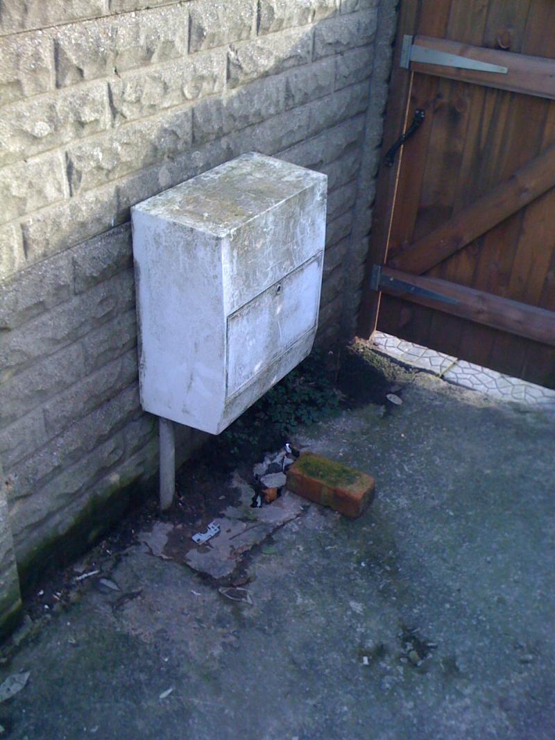

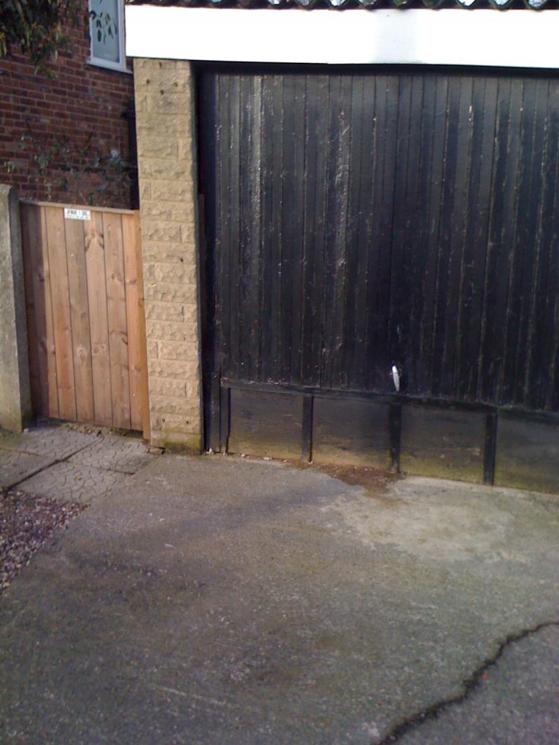

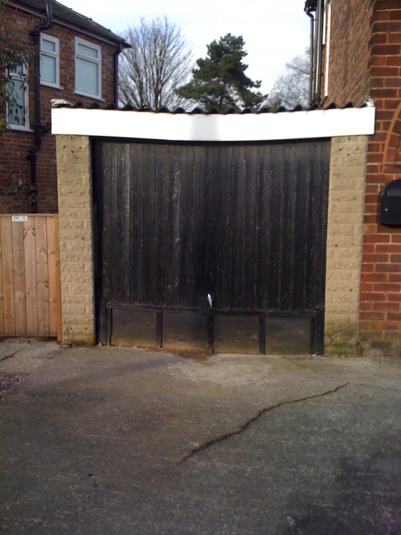

My house has an old 1970 pre fabricated garage connected to it that is badly in need of removing. The panels are cracking and the wooden roof timbers are rotting away.
Ideally I want to knock the garage down however the problem I have is that the gas meter is installed on the outside of this garage. There is then some cooper pipe for the gas inside the garage that runs along the ceiling before entering the house.
IS there any chance the supplier would move the meter for me? Where the meter is situated is also where the concrete panels are cracking the most.
If its feasible to remove the garage without damaging the meter installation, I would make my own meter housing for it - if it can stay where it is.
If not, its Bachos way.
I think the problem i have if i take the garage down is that the meter would be free standing to the side of the house. I would then have to run a pipe underground to get the gas in the house.
I take it that any moving of the meter position will carry a cost?

The suppliers will move the meter for you (at a cost) but you'll need to provide a new meter box (installed) to accomodate the meter.
When you first apply a surveyor may well call to check that the site will be OK.
For our area it is National Grid Tel 0870 903 9999. Tell 'em you want to move the meter and they'll send you the info' pack,
Not sure phone number will be the same for your area.
Aah! Just remembered. The Gas suppliers will move the supply to a readily installed meter box. they will not necessarily reconnect your side of the meter. You'll need to line up a gas registered contractor to do that, once the meter has been moved.
