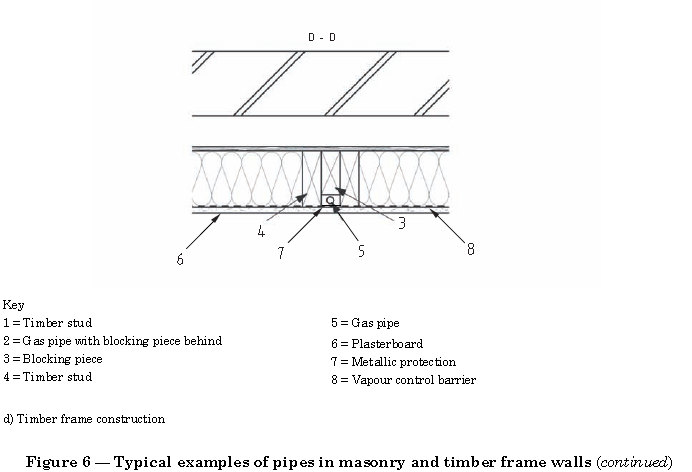

gas pipe in stub wall battened off
he said to just put a batten either side if you put a gas pipe

I have heard the metalic protection is not used much though?
It isn't - and isn't universally demonstrated in the standards. However, it is there to prevent physical harm. We are more concerned with explosive mixtures here. A leak can be repaired. An explosion can not be undone.
Thanks. Without the backing piece the area the pipe runs in will be too large. Is a 3x2 stud wall so maybe 2x2 behind it will do. It is for a gas fire that may or may not go in. It hopefully won't. And this pipe would come redundant. I.e not connected up to the gas.

But the use of a backing piece to encase the pipe is defferntly needed?
It's all about the volume IMHO. Perhaps one of the others would like to confirm.
Provided the cavity in which a leak of gas could cause an explosive mixture is small enough that the energy from that volume of explosive gas is small enough to not do serious damage then the possibility of a leak into that cavity seems to be acceptable.
