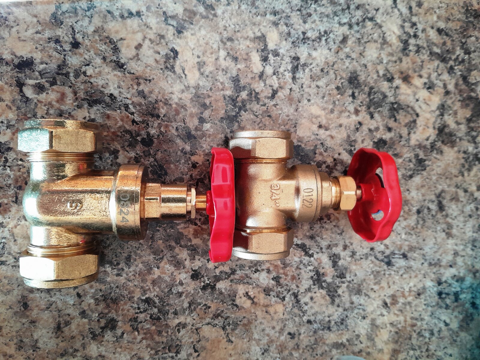

The left hand valve gland nut is impossible to move, is this now just a form of O ring seal?, the right hand valve gland nut (~ 3 year old spare) is quite easy to move and presumably the gland can be topped up like it always could be?.
The older one (both 3/4") has a reduced bore of 15.1mm but can't measure the bore of the newer one with a vernier calipers but looks about 19mm, 3/4".

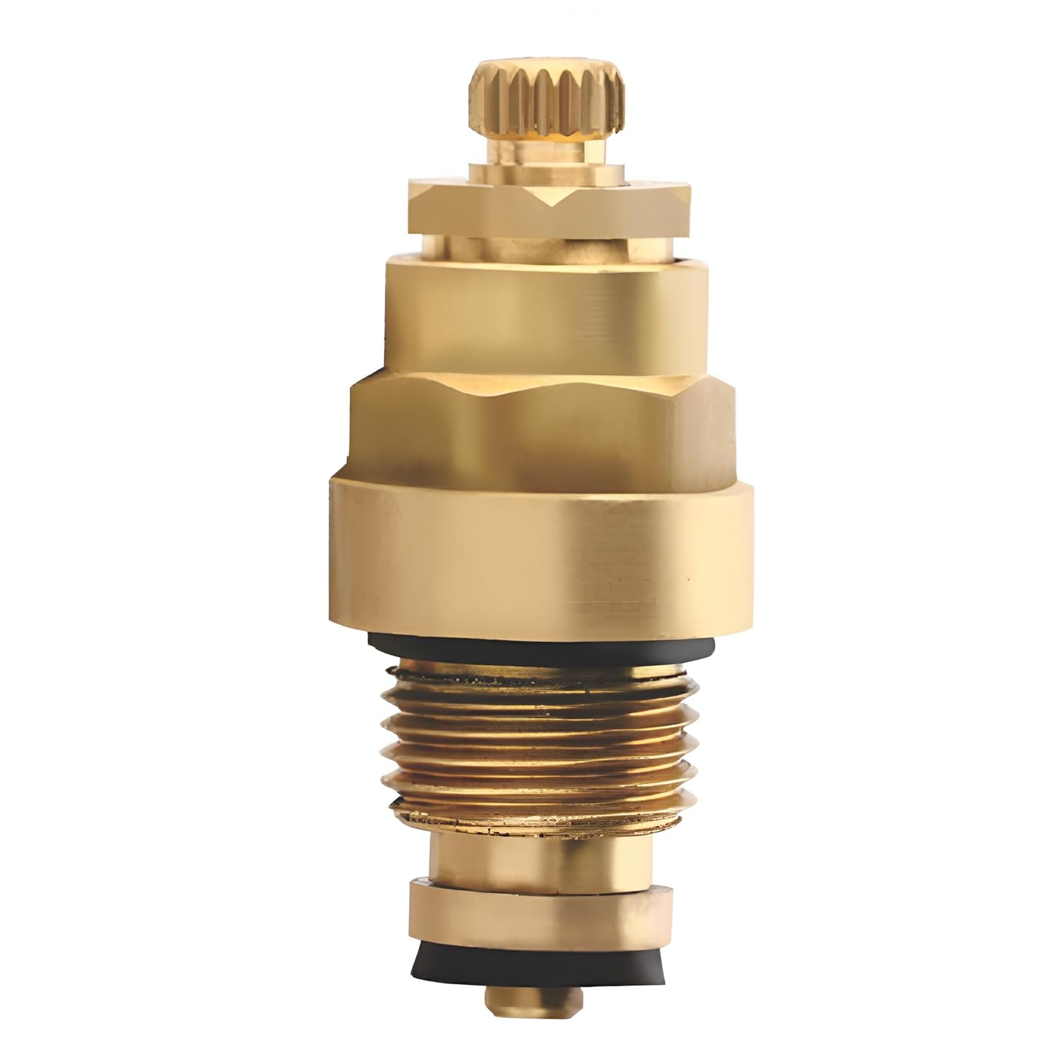

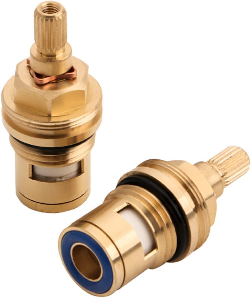

Nope, anything with a gland nut uses a gland type seal. O-Ring type spindles don't use nuts, they are all usually C clipped.
1761229248386.png - Valve that has a C Clip where the spindle uses O-Rings to seal
1761229566054.png - valve that has a gland nut has a packed gland seal
Don't think I've ever seen a gate valve without a gland seal. All gate valves should only every be used with gravity supplies IMO.
