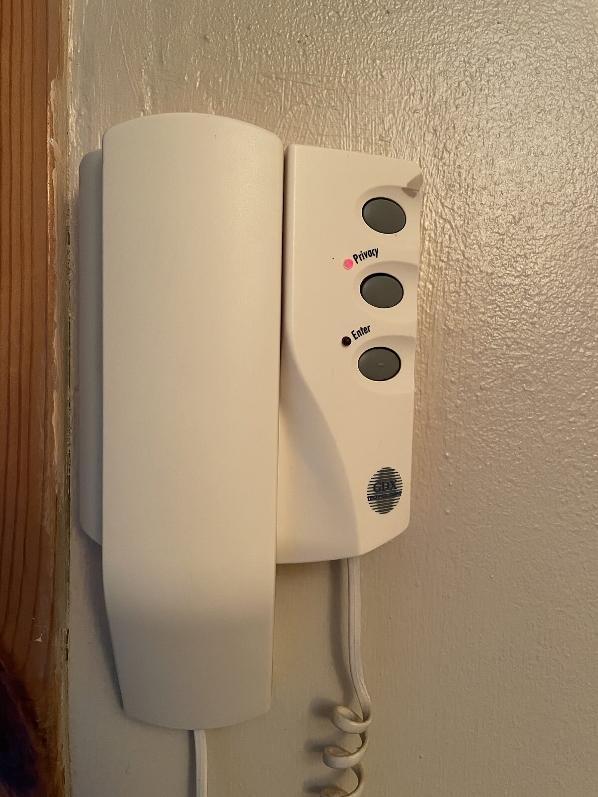

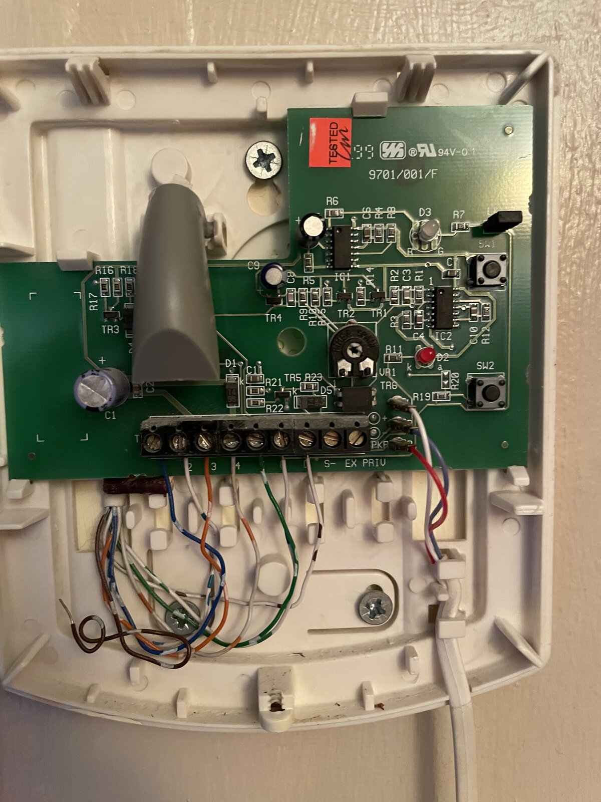

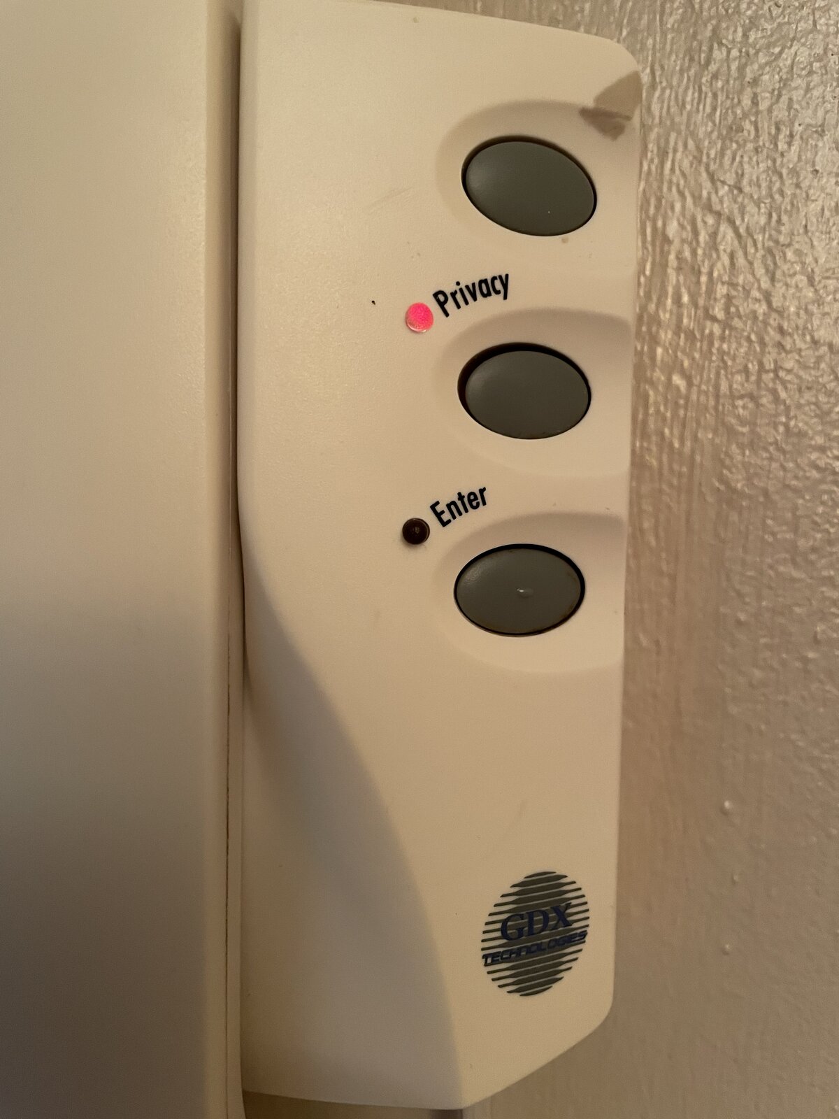

Hi, This GDX intercom doesn’t currently work, no sound and doesn’t allow anyone in the door.
Does anyone know which model this one is as I can’t see anything like it within the GDX range so I can swap it over.
Council won’t help as I’m an owner. Thanks

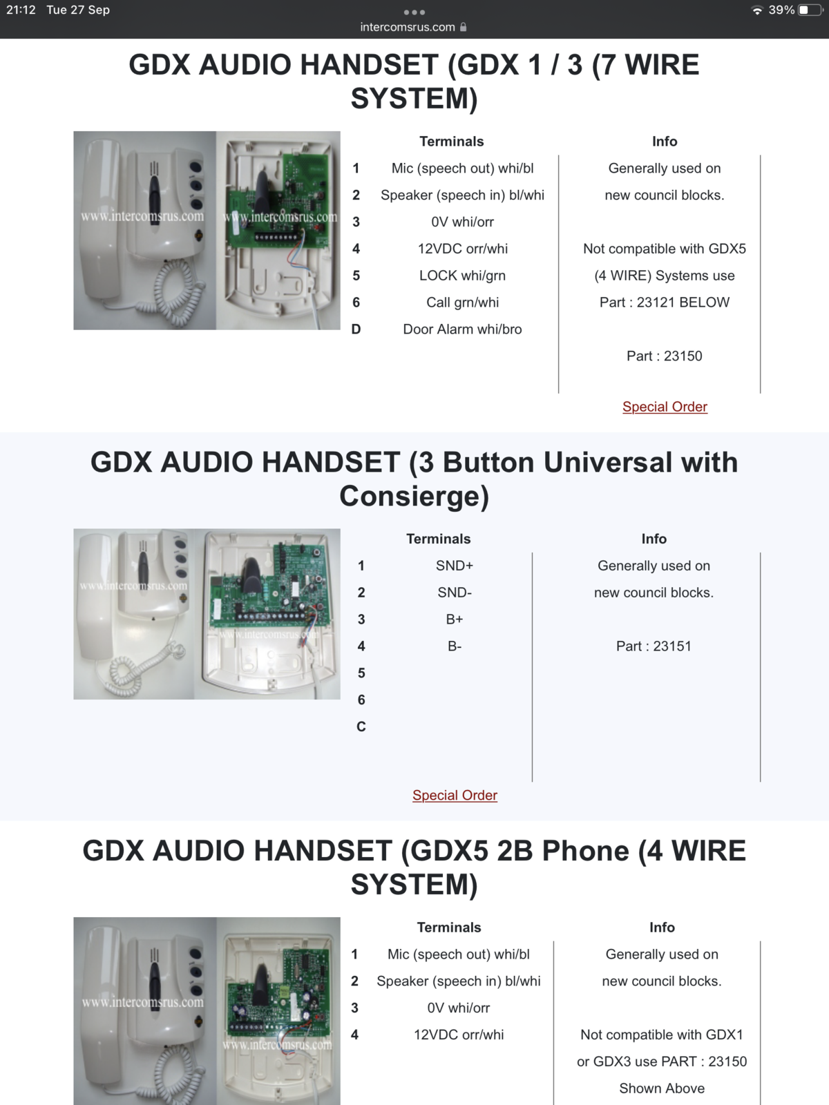

Try these if your stuck ….intercoms r us
I think we have the same phone and issue, I think we need the
GDX-23151 or older version GDX-23150​
Mine has done the same, lights up but no buzzer sound. If by chance you found one or fixed yours let me know how
GDX-23151 is the one I’ve ordered just waiting on it arriving​
