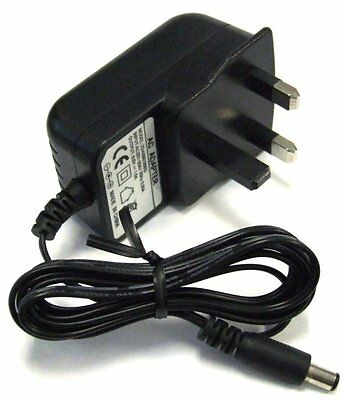

Oh right, should it say " switched' on it? Or anything else? Ive uploaded a pic of it. Plugged in undoors and jack is outside for garden pest chaser.
Output voltage matches and amps

Oh right, should it say " switched' on it? Or anything else? Ive uploaded a pic of it. Plugged in undoors and jack is outside for garden pest chaser. Output voltage matches and amps
There's not really anything else which it 'has to' have written on it. What you say sounds fine - I don't think you need to have any concerns.
