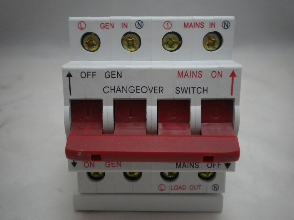

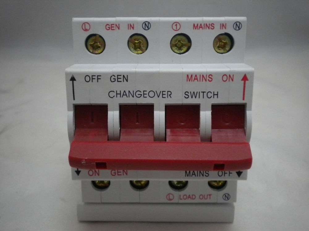

Yeah the op probably just needs the appropriate 4 width din switch.
But that China one looked good to me.

This sort of thing:

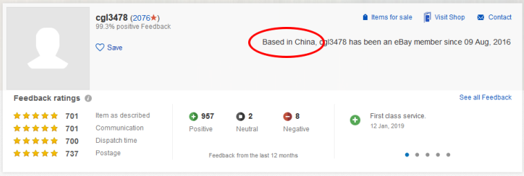

Much is, but you need the protection of UK/EU sellers within reach of the law and with reputations to consider.
"Made In China" is not the problem - "Made in and sold directly from a country by someone not subject to UK product safety and consumer rights laws when in that country the falsification of safety standards compliance is a known practice" is.

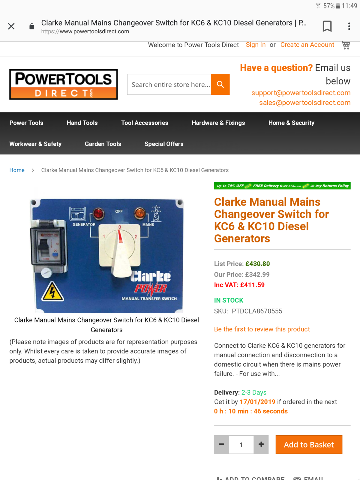

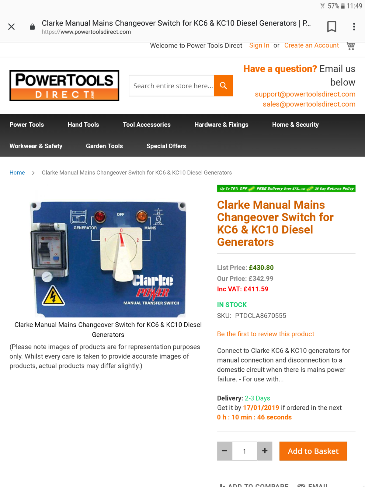

Prefer turning type with off position like these:
https://www.tlc-direct.co.uk/Main_Index/Distribution_and_Switchgear_Index/Change_Over_Switches/index.html?ad_id=79920763788772&source=msn&kw=change over switches&matchtype=p&qry=32A changeover switch&msclkid=35a77baa10e41d4f8727279179adcee0
Not the upper type.
... you need the protection of UK/EU sellers within reach of the law and with reputations to consider.
Occasionally I find myself in agreement with you BAS.
I would not risk buying a product of this type from China and installing it in a customers premises, I would accept it from a UK based importer/trader as I would have a comeback on our law when there is a problem.
I'm sure your pictured item is perfectly adequate but like Tommy I like a rotary switch with a centre off, they somehow feel more intuitive and risk free.
