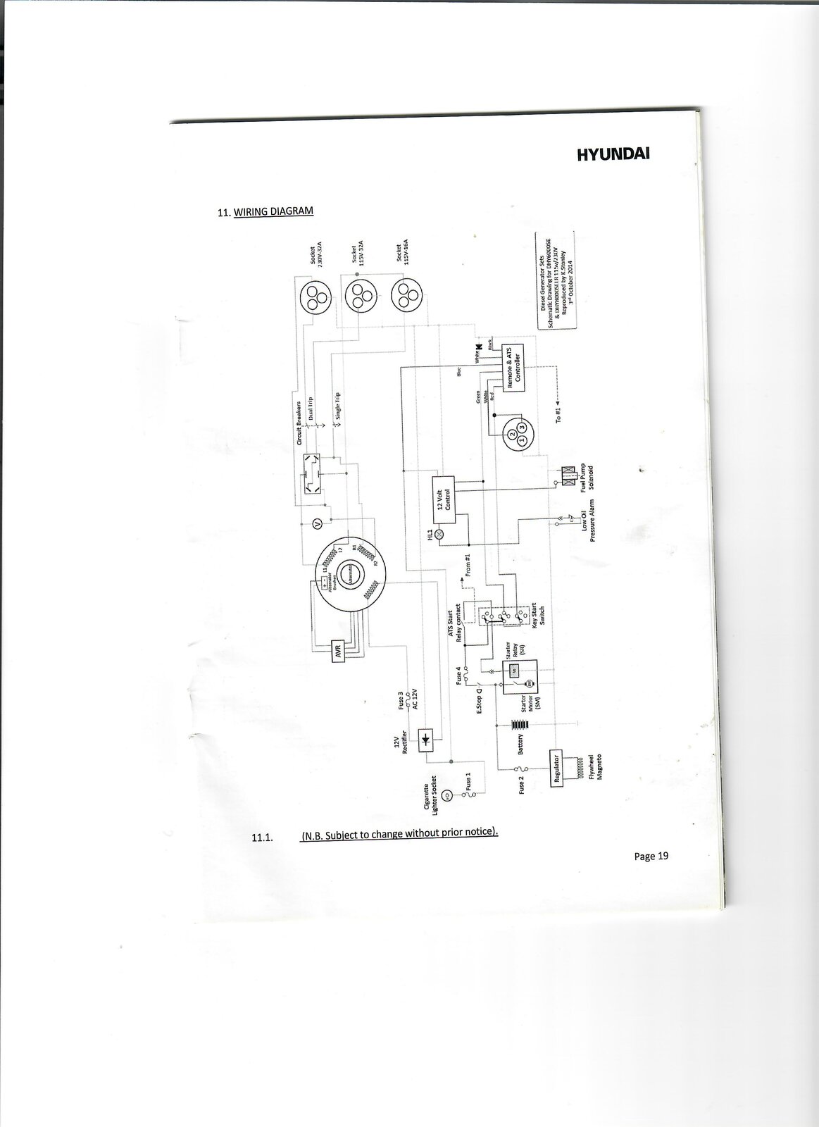

A) Below is a pic of the wiring diagram in the genny's operating manual (sorry I can't seem to get it correctly oriented). It looks to me (but I'm not sure) that a centre tap earth or N-E link is NOT shown. Any comment on that question? Perhaps better to test for that (with a multimeter) on the genny itself?. Can you guide me on that?
B) Assuming that a N-E link is needed, is the best place to do that in the plug at one end or the other of the connection lead, which is then labelled as (suggested in the generator FAQs) “Do not connect to mains: Neutral-Earth link fitted”. Or in the inlet itself? Or in the genny?

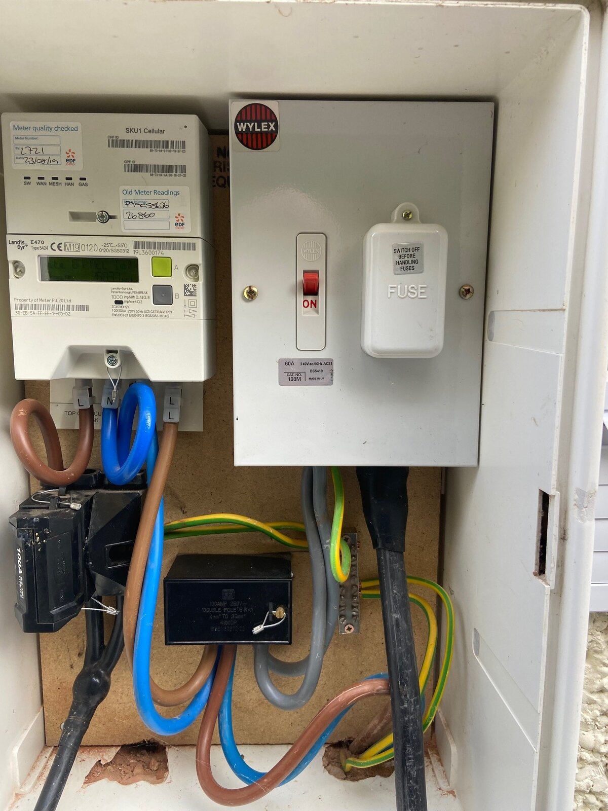

C) I have worked out that a 7-module, metal DIN rail box can be mounted in place of the 60A switch fuse (see pic below). 4 modules are needed for the changeover switch and I had in mind a 63A fuse holder (1 module) and 63A main switch (2 modules) taking tyhe remaining space. I'm concerned that finding space for a separate RCBO will be tricky. So, is a possible answer to substitute a 63A 2 pole RCD to provide overcurrent protection and to operate as the main switch? If I am thinking this through correctly, the fuse will protect the SWA cable when connected to DNO supply and the RCD will provide fault protection (including the connecting lead) when the connected to the generator supply.
[edit]I mean the RCD to provide fault protection (including the connecting cable). The fuse will provide overcurrent protection in both operating modes.

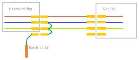

A solution to the N-E ink issue could be to make the link in the cable but use a 'non standard' connectors such as 4 pole but it will require changing or adding a concector on the genset.
Is the purpose of that to mitigate against the lead being used in a setting where the N-E link isn't needed?
Yes that's correct and also to prevent the issue with a different genset with a 55V N-E.
This shows the general format, I show it with a selection of dark green wires to show different options which have been discussed:
That way the cable can't be used for anything else including for the wrong genset.

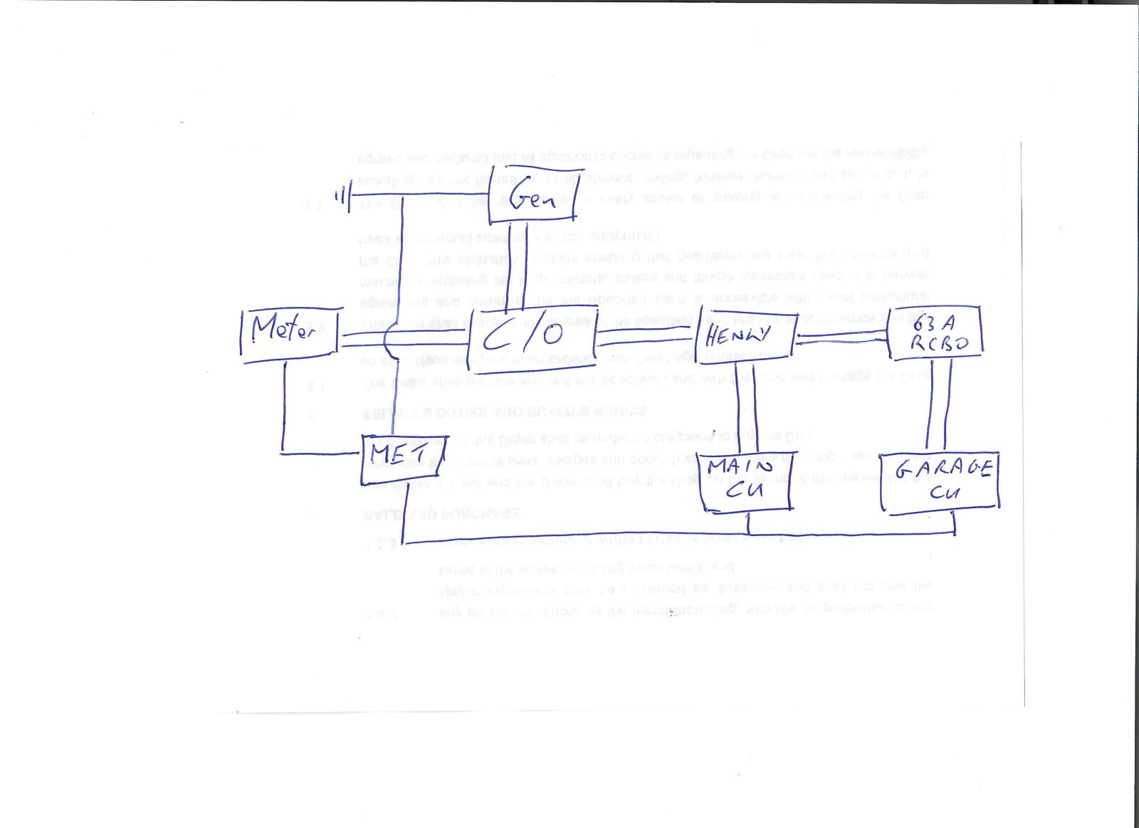

Below is a wiring diagram of what I envisage based on the discussions so far. Couple of NBs:
(1) The earth connection from the genny to MET will be via the 32A connecting lead so not permanent.
(2) I haven't yet found a 2P 63A RCBO but no problem with a 63A RCD. So may revert to the RCD + 63A fuse alternative.
I have two further questions:
A) I presume the RCD/RCBO should be type AC?
B) It seems logical to place the RCD and fuse with the RCD closest to the genny.
Any further comments?
