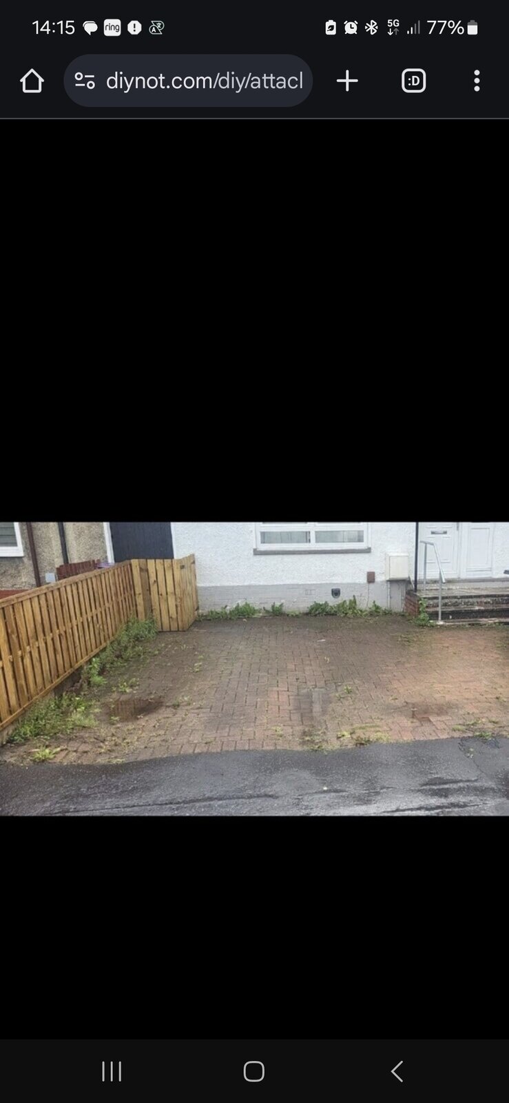

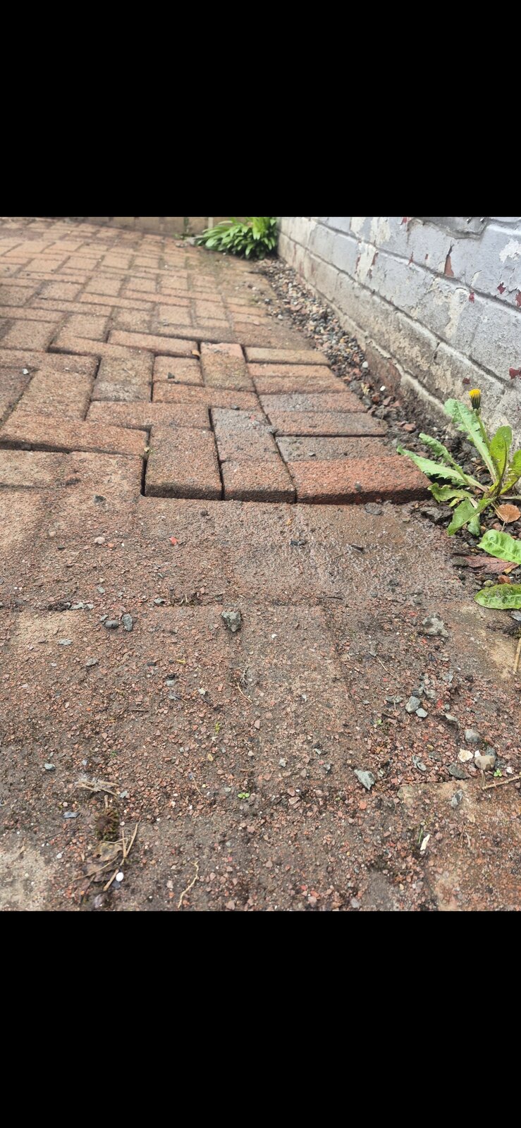

You have bad rutting there, and the ground below those ruts will be saturated. That subbase needs to be scraped and the soft ground removed, then the base and relaid or even renewed (if its contaminated with soil/mud), not just patched.

Had a guy come out to give me a quote and he said he needed to lift up some monoblocks to see under them. I said ok, so he lifted a few up and was full of water soaked squishy clay. He left the about a dozen monoblockes all sticking out a good inch or 2 all over the place. I since messaged him and ask him if he can give me a quote break down on a paper and mot just verbally but he has vanished and not replying. Very nice of him.
Now if I can't find anyone to actually do the driveway then.my driveway is left in an even worse condition. Please see pic.
I'm almost out of options now. As no one left to try. Or 7k is too much.

One thing to remember, a permeable surface is only as permeable as what is underneath it. If your soil is clay, your driveway can be as permeable as it gets, but you will still have issues
