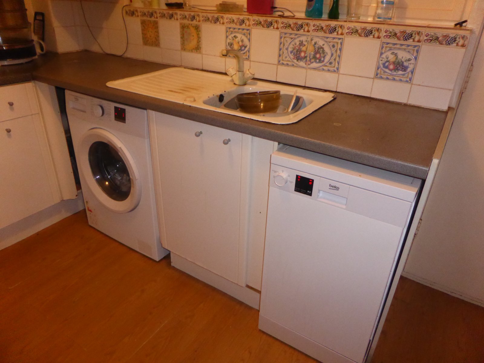

Hi folks,
I am going to have a worktop, sink and taps replaced.
I am thinking that if I source a worktop, sink and taps then get a plumber or kitchen fitter to fit them that might be the way to go.
Is that a good plan? Would it be better if I get the worktop and leave the professional to get the sink and taps so that they are compatible with each other and the existing pipework?
I've seen some very flimsy sinks in rental properties. What thickness of stainless steel sink is appropriate to support the taps without them rocking back and forth every time they are used?
What sort of costs can I expect?
I can remove tiles before the professional does the work, and re-tile afterwards. But I don't feel competent enough to do the plumbing.
Thank you, David

Get some quotes and people to look at the job.
It's a pretty straightforward job.
Kitchen fitters will know where to source a good quality stainless steel sink.
Taps are all more or less compatible with standard sinks which come with a 35mm hole (and less and less with 2 holes).
Yes, you can remove tiles and clean the plaster (if it doesn't fall off) before replacing the worktop, in fact, it would be better.
Should cost you around £1000 excluding material (worktop, sink and tap).
I'm assuming you will do the tiling afterwards, otherwise add another £300.

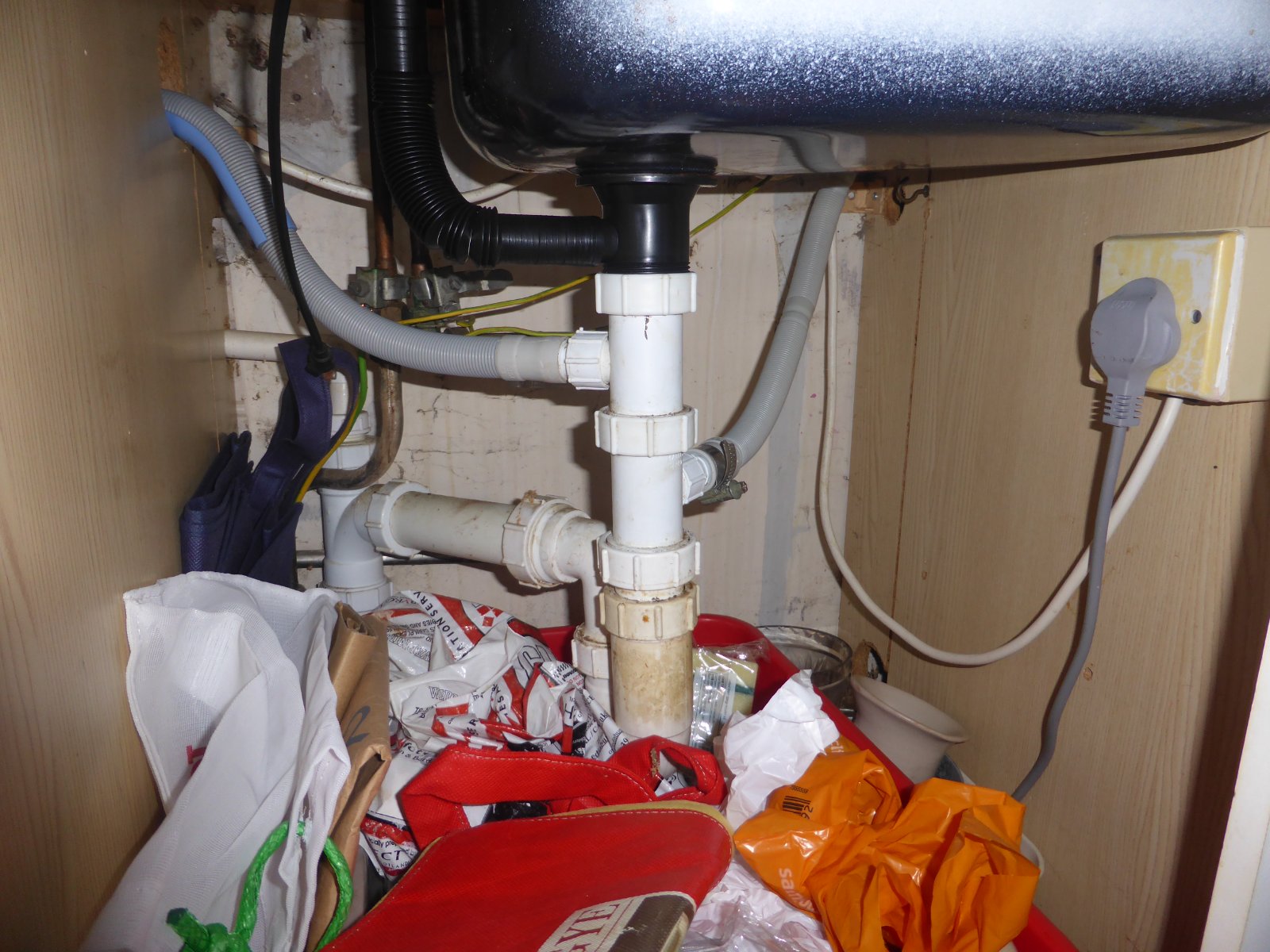

Plumbing the taps in rigid copper would improve things, so you could insist the installer does it that way. Otherwise he'll almost certainly go for flexis as it's easier. From the pic I can't see any flexis, so maybe the existing is rigid.
Alternatively, there are plastic devices fitted under taps to add stiffness, but could be specific to the make of tap.
