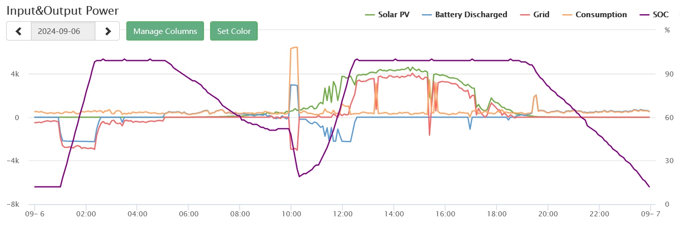

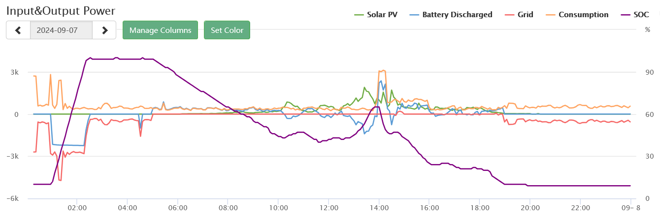

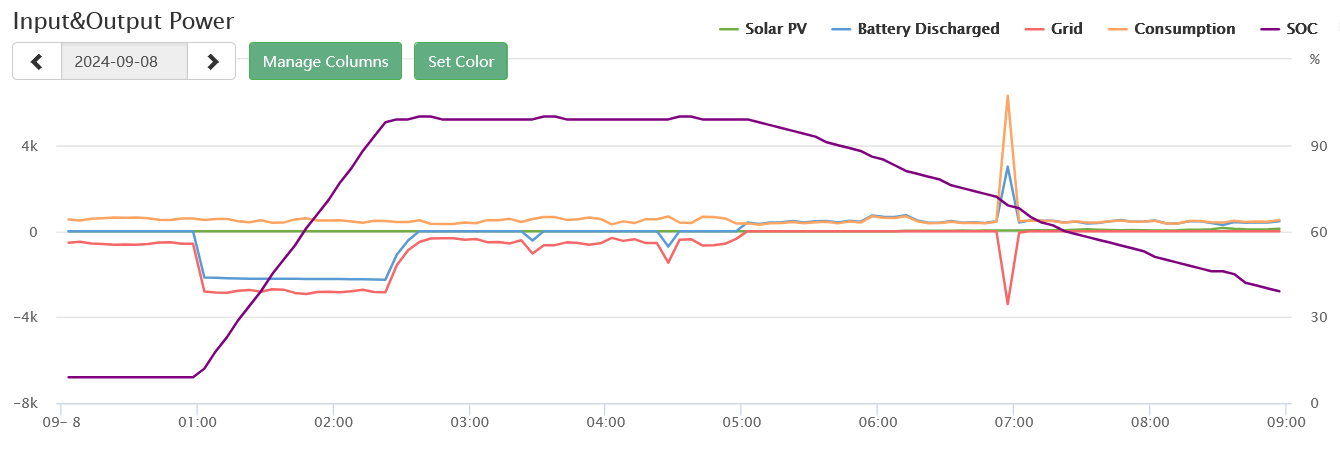

However this time of year we tend to run out of hot water, solar panels heat the water once battery is full, but this time of year, we get bad days, yesterday purple line 1725782356849.pngthe battery never charged from solar, only the off peak charged battery, which lasted us until nearly 8 pm so not bad, but by today 1725782528516.png water is cold, and it seems likely again no solar to reheat it. Once the central heating is running, we can't stop the DHW being heated, and the central heating does the whole tank, where the immersion only does top foot, so heated with central heating hot water lasts 3 days, but not with the immersion heater.

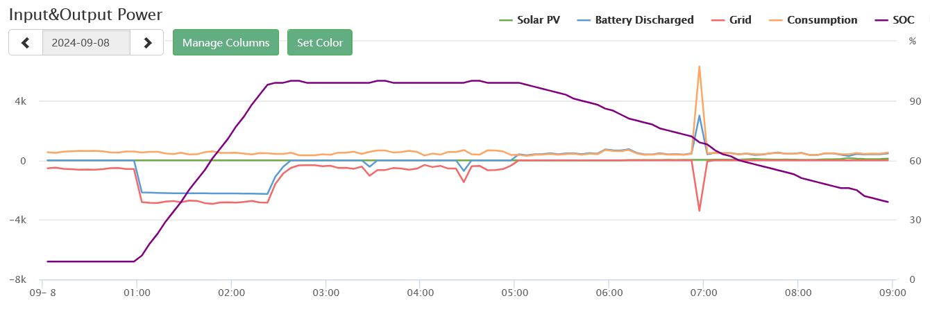

The problem with the boost time, is we don't realise we need it, until after the water has cooled, most days we get a pattern like this1725783361321.png and the flat top to the state of charge curve means we had more solar than required, so immersion heater has heated the DHW, so just a few days in Autumn and Spring when we run out. Typically we use around 0.6 kWh per day to heat the DHW, so hardly worth spending out a lot of money to cover the days when we run out, but I can't be the only one with this problem. So any idea I have not thought about?

However this time of year we tend to run out of hot water, solar panels heat the water once battery is full, but this time of year, we get bad days, yesterday purple line View attachment 354885the battery never charged from solar, only the off peak charged battery, which lasted us until nearly 8 pm so not bad, but by today View attachment 354886 water is cold, and it seems likely again no solar to reheat it. Once the central heating is running, we can't stop the DHW being heated, and the central heating does the whole tank, where the immersion only does top foot, so heated with central heating hot water lasts 3 days, but not with the immersion heater.

The problem with the boost time, is we don't realise we need it, until after the water has cooled, most days we get a pattern like thisView attachment 354888 and the flat top to the state of charge curve means we had more solar than required, so immersion heater has heated the DHW, so just a few days in Autumn and Spring when we run out. Typically we use around 0.6 kWh per day to heat the DHW, so hardly worth spending out a lot of money to cover the days when we run out, but I can't be the only one with this problem. So any idea I have not thought about?

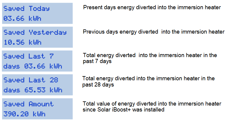

At last some sun, water reports as hot, and used 0.60 kWh today, over the week it shows 2.92 kWh, which raises the question why use an iboost+ to start with? Well we have been told so many times, how costly it was to heat DHW with electric, I just believed what had been said, and I know my oil boiler in summer (20 kW) has to fire up 4 times a week, at ½ hour each time, and it actually ran for 20 minuets each time, so thought the electric would use the same amount of energy.

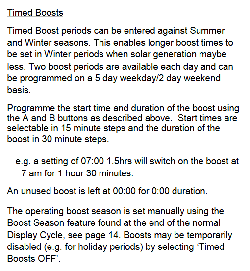

I have been reading the instructions for the iboost+ is says:-1725882921761.pngbut this seems to defeat the whole idea of having the iboost+, in winter the central heating is running, so no way to stop central heating from heating the domestic hot water, in summer the solar does it's job, the figures the manual shows 1725883134105.png seem great but in real life that is 0.60 kWh today, yesterday not much sun so zero, 2.92 kWh last 7 days, 14.88 kWh last 28 days, and 98.13 kWh in total and been fitted nearly a year.
So in a year saved just over £30, so will take 10 years to pay for its self. Well if I used off peak, saved £8.80 so over 30 years.
