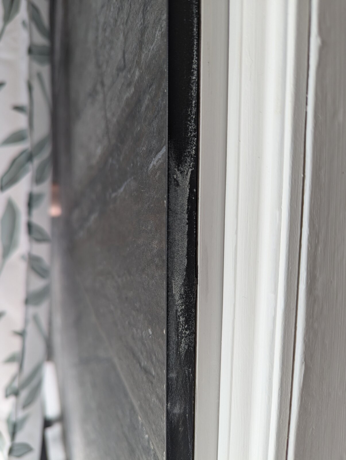

Hi,
Stupidly splashed white paint on metal tile trim and only realised when I smudged it.
Any tips on getting rid of this without affecting the black trim?
(Paint is zinesser mould resistant paint)

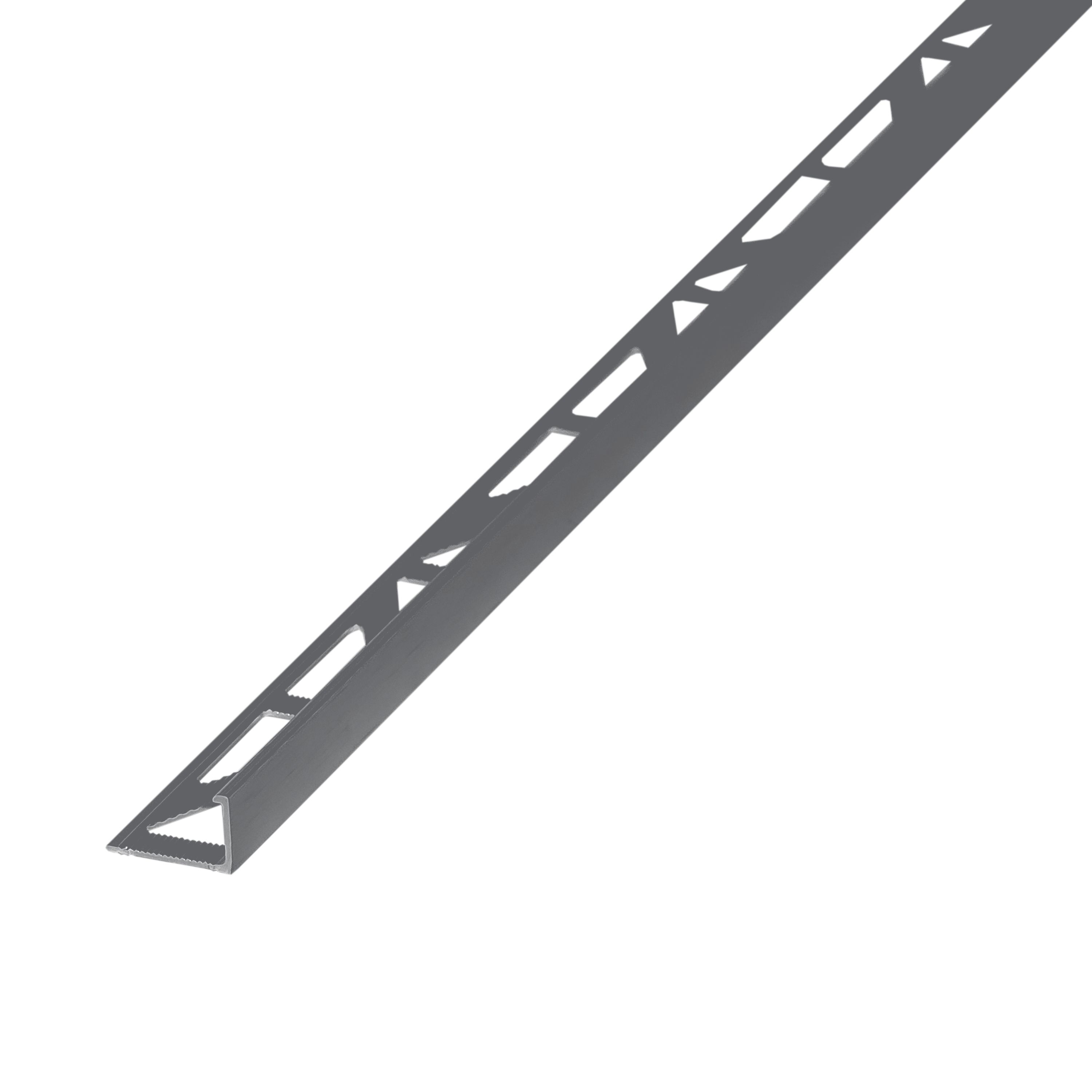

What material is the black trim made from?
Its coated aluminium
This one:
@Joe Fixit Hmmm .. that does not state if it's anodised or just a painted finish on the alloy. If it's anodised then a light application of a paint stripper should remove those smudges, but if a painted finish, then you'll have to ask in B&Q.
@Scally-Ho it does mention it's anodised in the specification section. Any recommendations of paint stripper to use?

I would try something more gentle to start with. You can get progressively aggressive if it doesn't work, meths, white spirit, turps, cellulose thinners then pait stripper would be my suggestions.

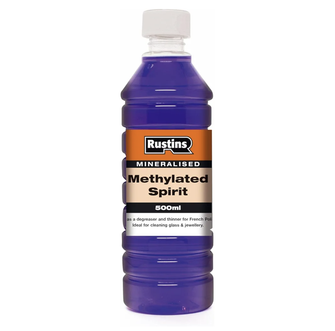

This one ok?
That’s it, I generally have a bottle in the garage. Really good at cleaning winter crap of the car windscreen. As I said and egg cup full in a couple of pints of water and a micro fibre cloth brings windows up a treat.
