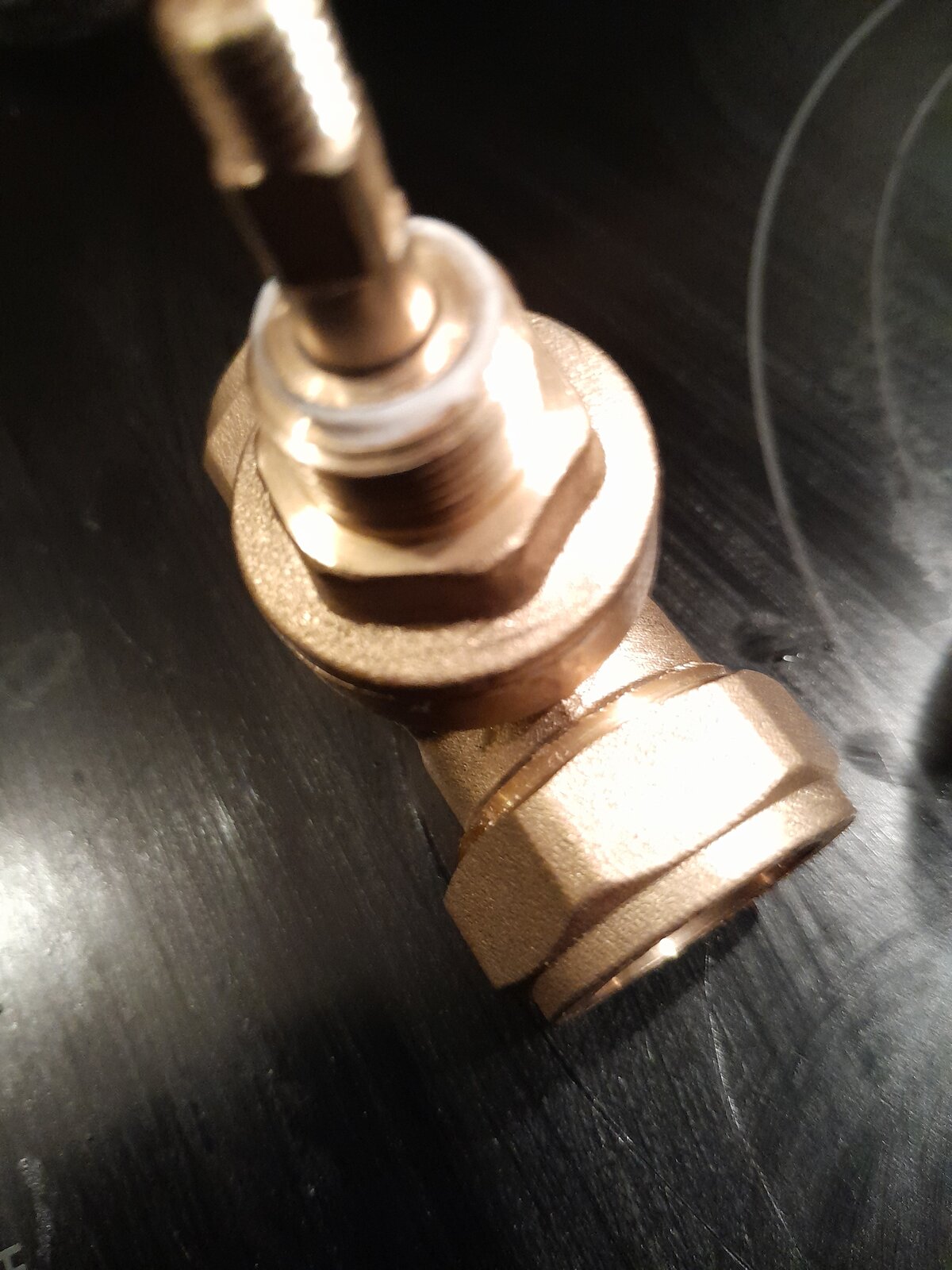

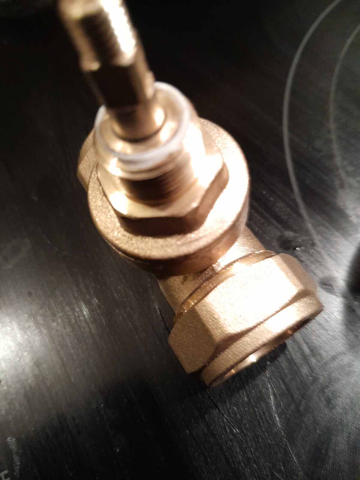

Photo is from a spare 3/4" gate valve, there just seems to spiral wound (white plastic) packing that protudes ~ a mm to allow tightening up.

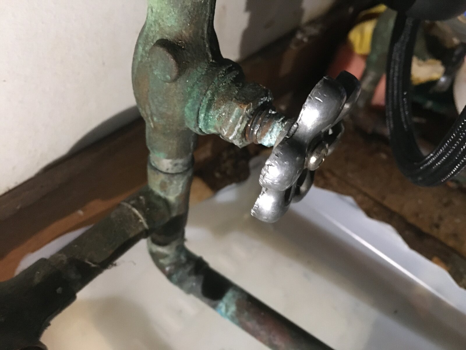

To examine the leak further, I took a picture.
It looks like'll need a 3/4" wrench to repack the gland. However, I first opened the valve really "hard" and the dripping reduced dramatically. I dried everything and will check the next day. If the water evaporates faster than it collects I'll be okay. If not, I'll have to shut the water off and open it up to repack the gland.
Wow that’s an old one with visible threads......can the gland be repacked on that one?
Personally I’d consider having that replaced with a new one, or a lever valve if at all possible.
John
I have 4 of those under the sink, all the same vintage. Hot and cold for the kitchen faucet, hot for the dishwasher and hard water for the hard water faucet. None have given trouble since I've lived here for 40 years except now this one. That's why I'm hesitating to take it apart to see if I can repack it. If I break it, you can see it's only 1/4"or so above the tee, so replacing with a new one would be a bit of work.

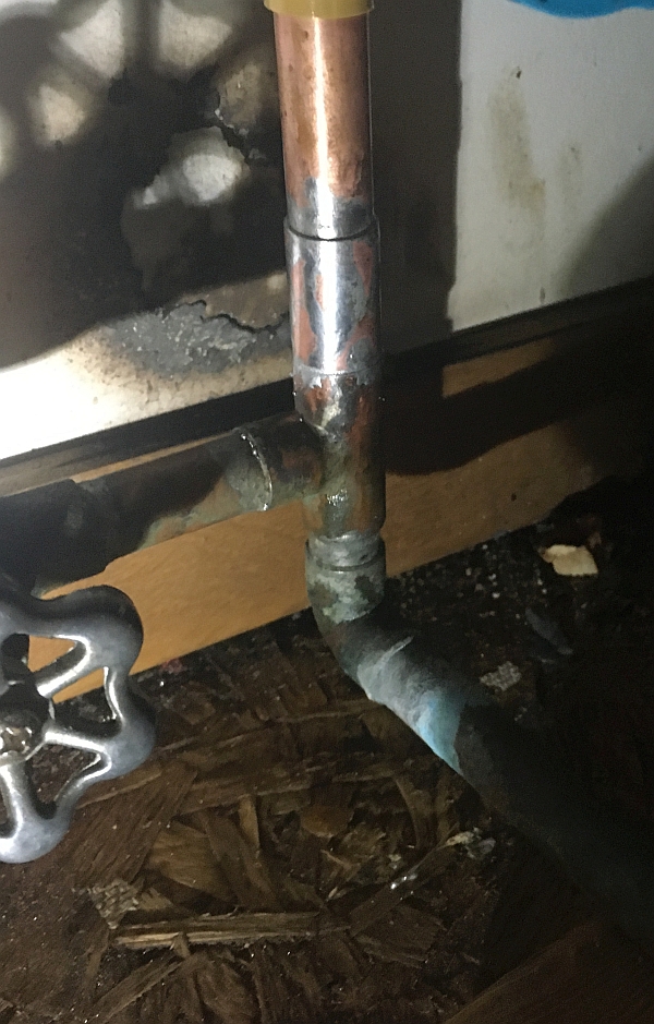

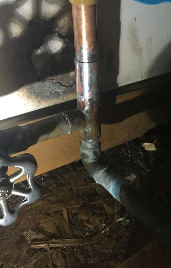

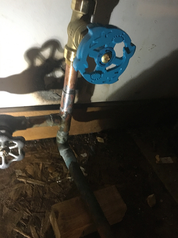

Well, the gland was still dripping a little, needing me to empty the tray every other day, so I opted for a more permanent solution, using a Sharkbite valve. First I tried heating the joint under the old valve, but still could not get it to separate even when I could see all the solder joints in the area melting. Next, I hack-sawed the 1/2" pipe flush with the bottom of the old valve, leaving about 3/8" above the tee (see post #8 above). I heated the joint again and tried to pull out the piece of copper pipe with channel locks, with no luck. Maybe the lime and corrosion was holding it. I should have left well enough alone because now the piece of pipe sticking out was mangled so I could not fit a coupling over it. I finally could press it on after a lot of shaping and filing, so I soldered it and a short length of 1/2" to take the Sharkbite valve. Sometime I'll see how easy it is to take the old valve apart and repack it.
