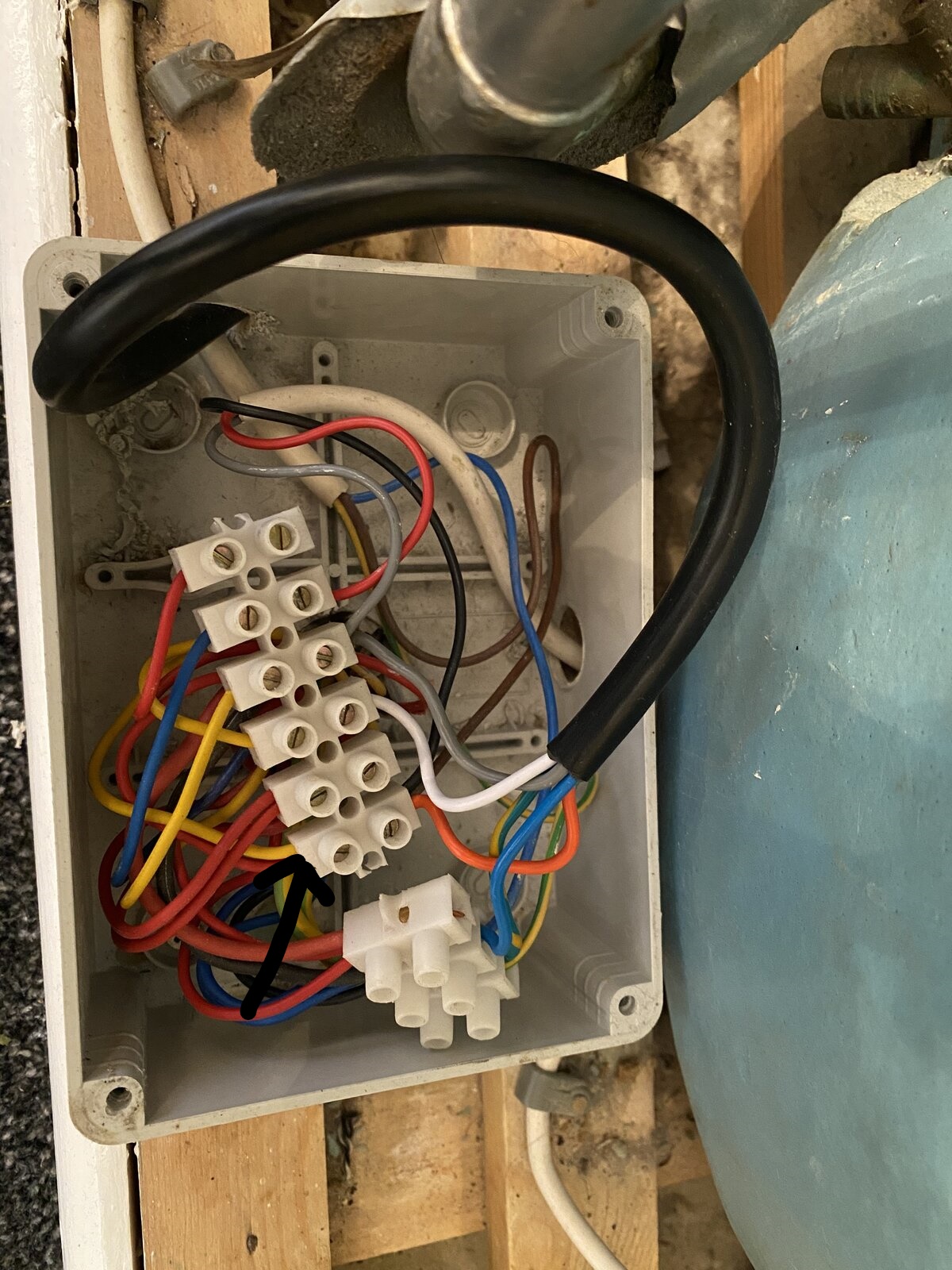

You will get more help, if you are able to describe more about the rest of your system - type of timers, stats, 3-port valves, water cylinder. Include some photos too.
All we know at the moment, is that the boiler is an heat only boiler, possibly supplying an open-vented system.
Rather vaguely - You need to begin by working out what type of system you system was designed to be (likely Y-plan), then (if you feel competent) mark up all the cables as to where they go at the joint box (probably in the airing cupboard). Then there are plenty of diagrams on the internet, explaining how it should be wired.

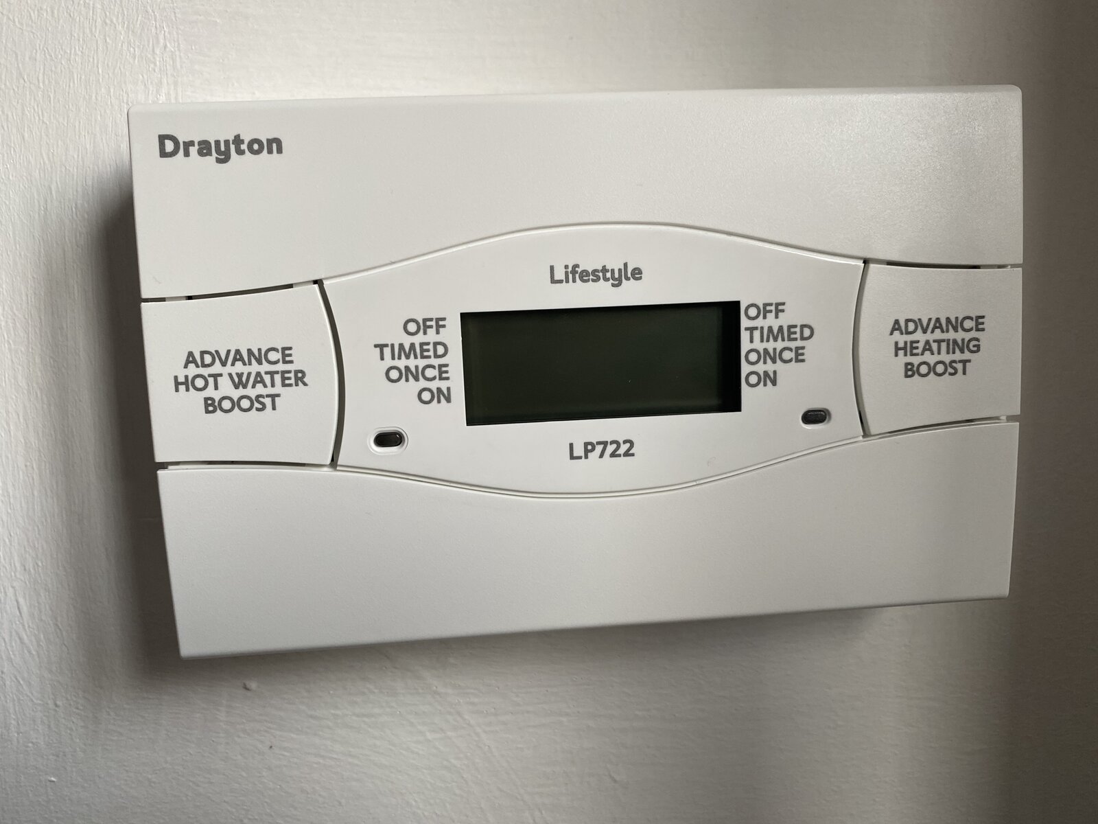

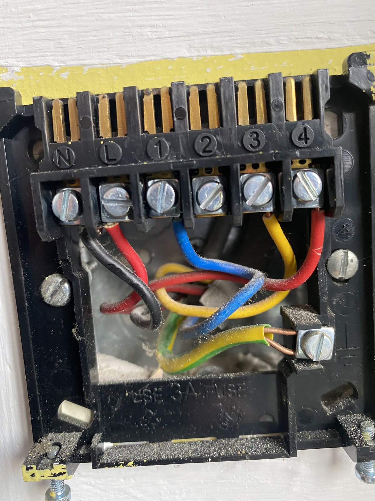

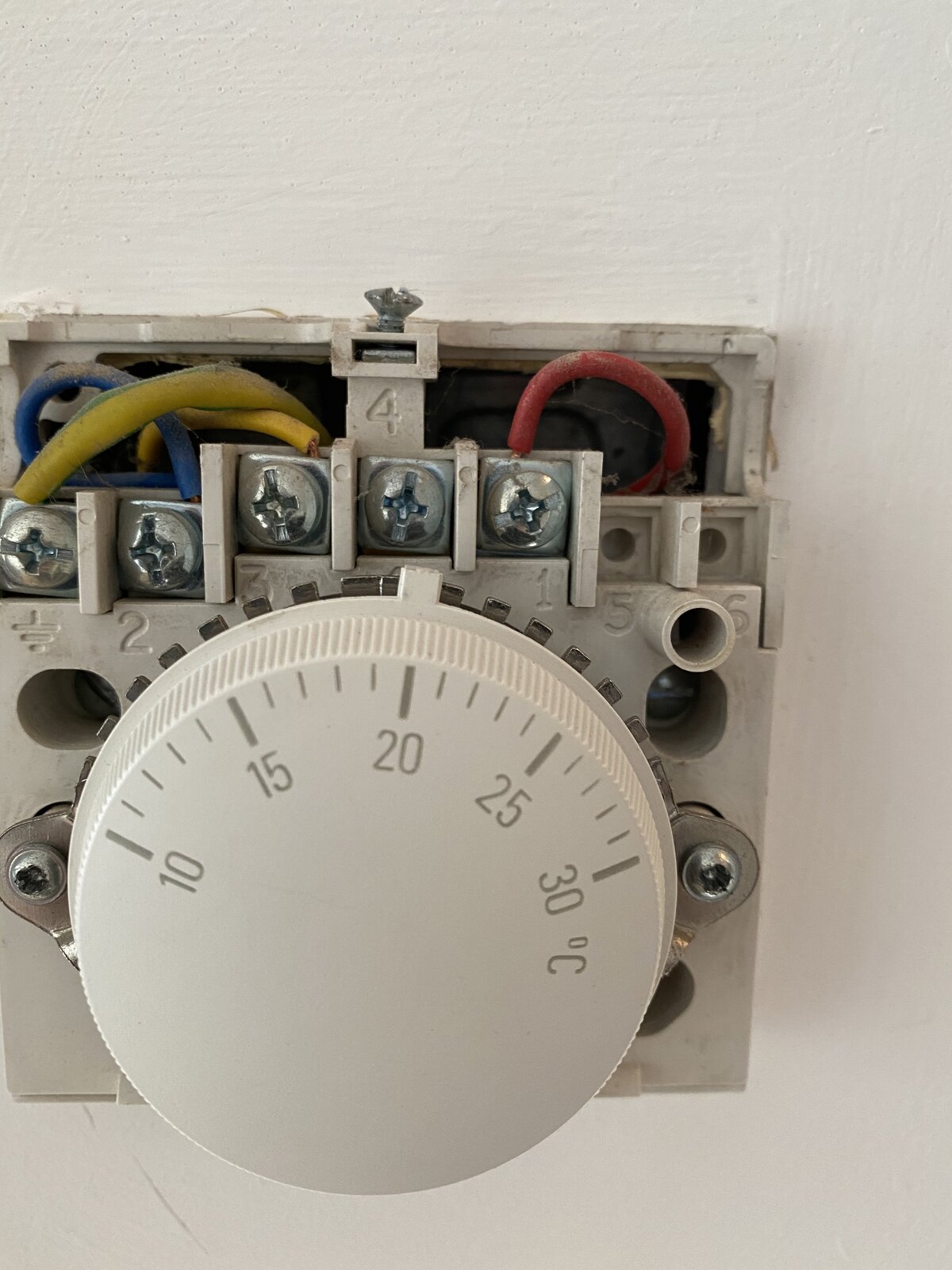

System is Y plan

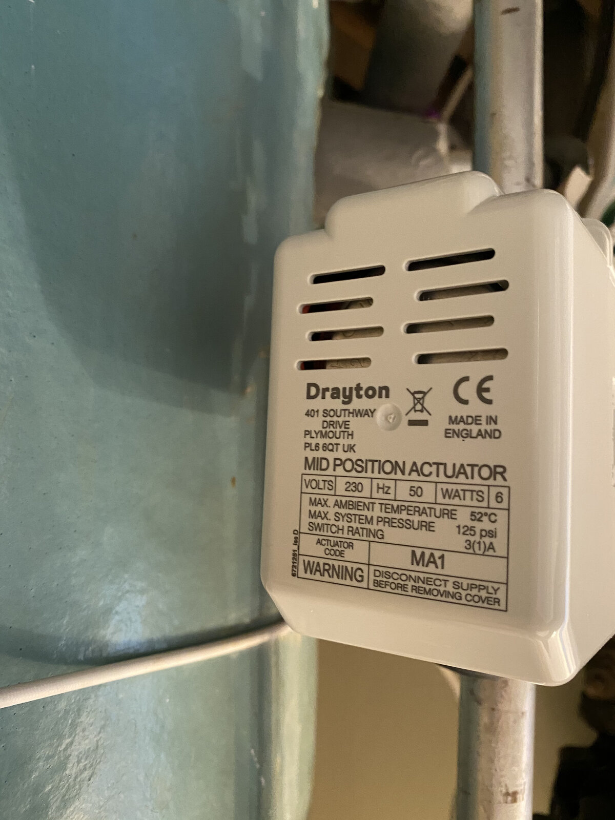

Mid position Valve - Drayton MA1

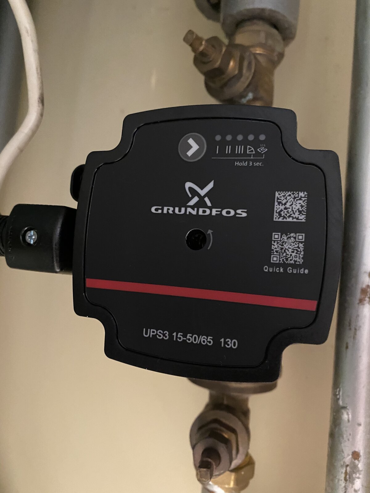

Pump - Grundfos UPS3
Room Stat - Honeywell T6360
Timer - Drayton LP722
there are no other room / zone stats

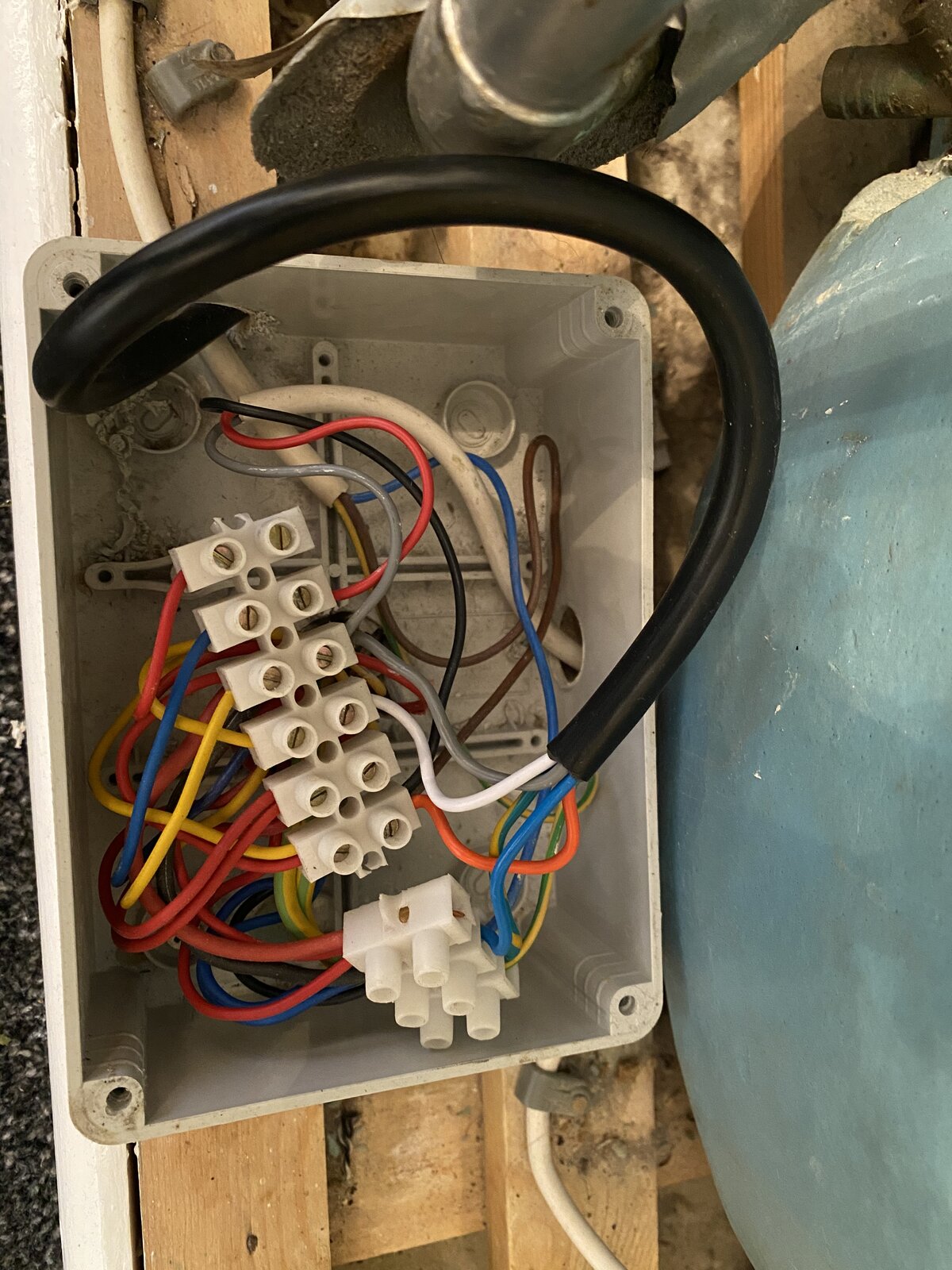

photos attached and with their associated image of wiring
at the junction box in airing cupboard
black cable is the Mid position valve

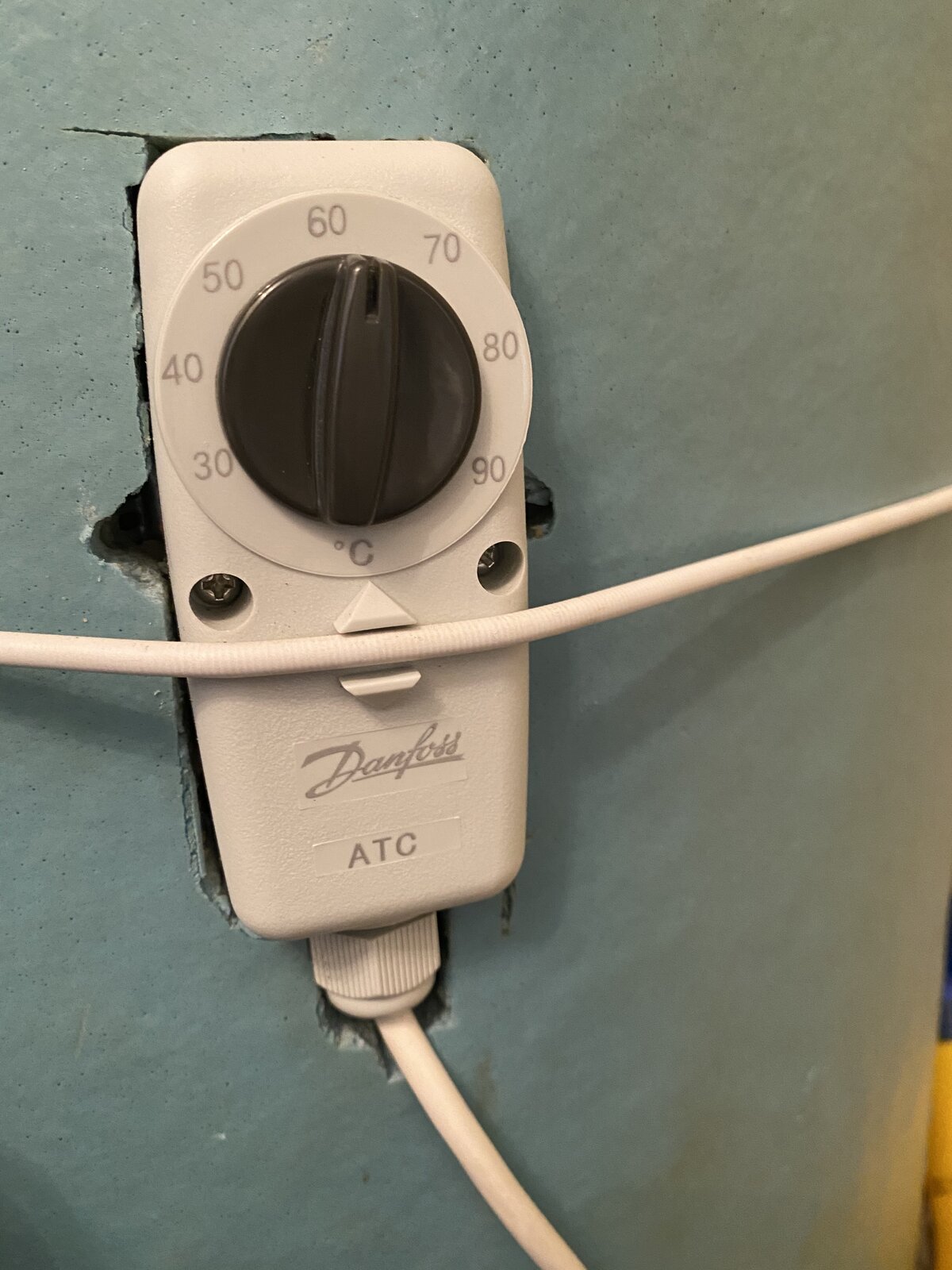

White cable entering box at top of photo is hot water tank stat
white cable entering box at left of photo is Grundfos pump
the fitter (neighbor, not friend ) is gas safe certified as had to get a certificate for it as house is currently up for sale
I’m happy to fault find the wiring with some guidance to avoid putting up with the choice of 26c or freezing

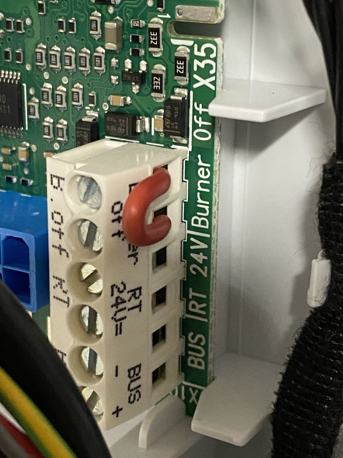

Ask your neighbour/plumber if he has removed the 24v link on the pcb, very common for it to be left in and the boiler will run 24/7 ignoring programmer and stat.
Was my first thought. (y)
Just checked and there is a link between RT & Live which is obviously not a factory link
there is also a link across “burner off”
No wonder your boiler is running constantly, you have a link between live and switched live (rt) the switched live is supposed to come from the controls.
So is it a case of just removing that link or is there some wiring to be changed inside the birds nest junction box ?
The red and yellow cable marked should be the pump and switched live to the boiler, you need to find out which one is the boiler switched live and connect it to the RT slot on the boiler (after you remove the link) do not connect any thing to the 24v part. just noticed there is also a brown and black cable on that connector, either of these could be the boiler switched live.

you need to trace the yellow wire that is connected to the orange wire from the mid position valve, and this is connected to the RF terminal on the boiler, that link must be removed , seen some misguided idiot wiring but that is school boy error

Could this be some attempt at overcoming the issue that there are only 3 wires arriving (L, N & E) at the boiler meaning there is no switched live wire going from junction box to boiler?
If it is some form of hash job does it mean I need somehow to get a wire for this purpose installed?
if so I see a bit of a do coming with my neighbor for the hash job and then a mega job of having carpet and flooring removed as boiler is in the garage and jcn box in airing cupboard

I have now (apart from 1 cable) traced all wiring
apart from the local cabling - pump / tank stat / 3 port valve
there are 6 cables entering jcn box
Supply
Timer
Room Stat
Boiler
Frost Stat
I need to identify the last of the 6 BUT would there be any problem in removing the frost stat (fitted next to boiler) and using one of those wires as the switched live to boiler?
