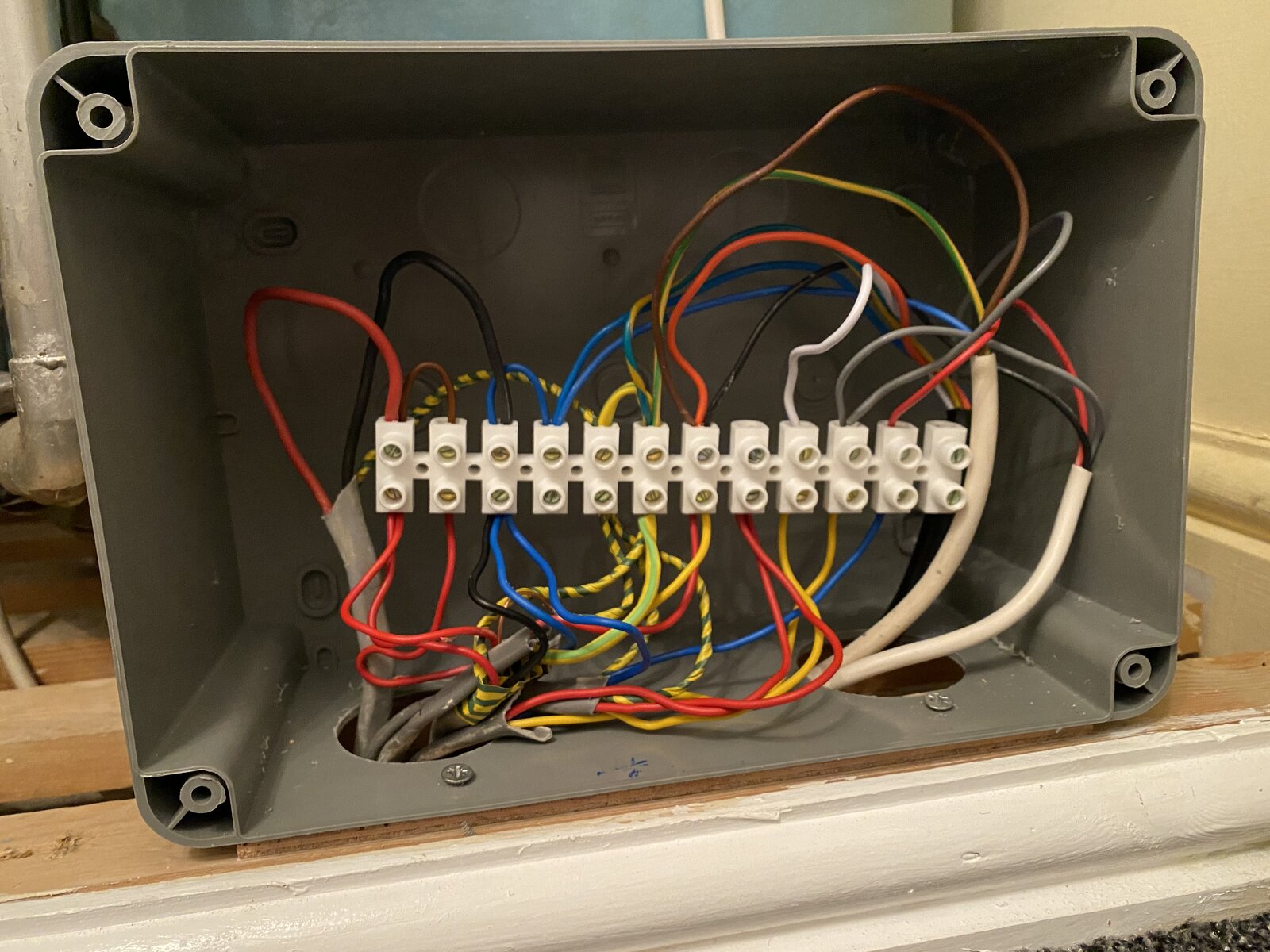

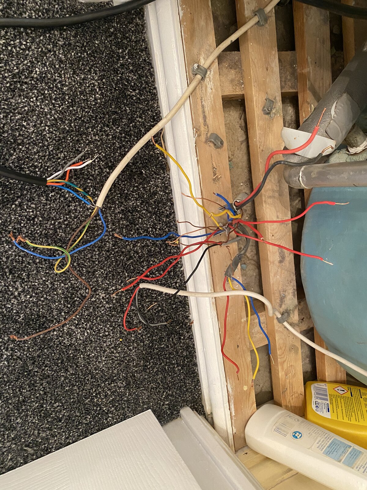

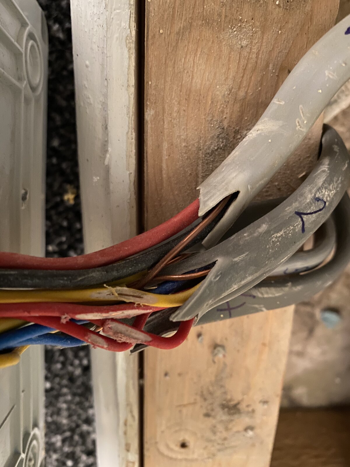

so I’ve completely stripped junction box out (I’m anal with things being neat and it was just horrendous) I also noticed some bare wires which need correcting
this has allowed me to trace every wire

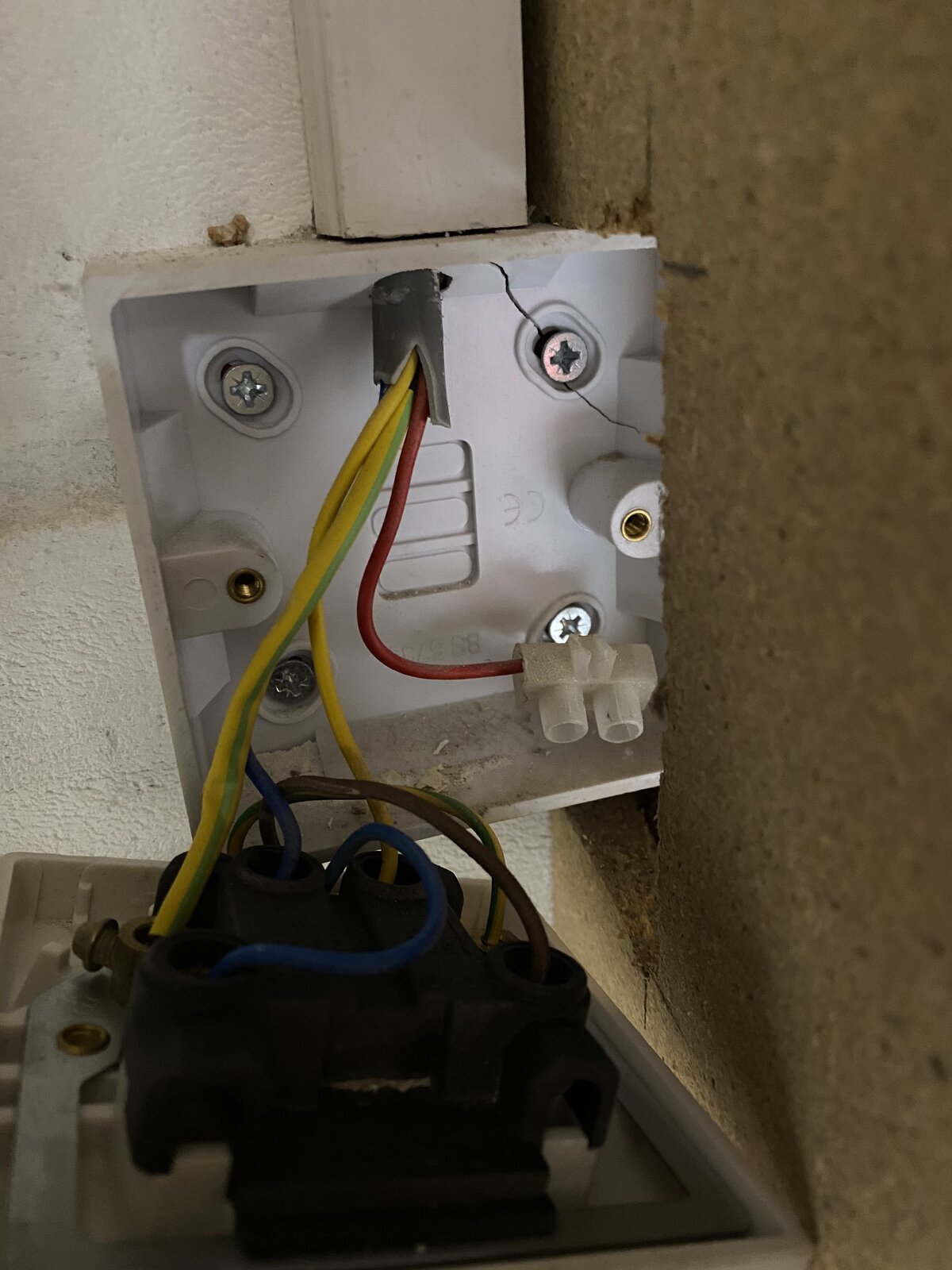

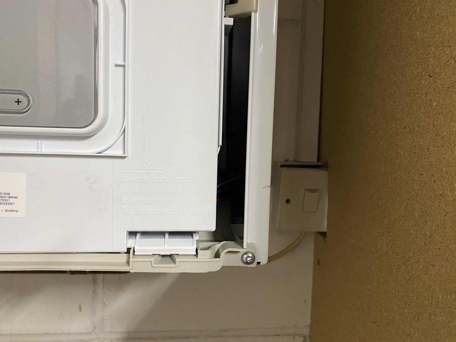

so the boiler cable from junction box terminates at a switch at side of boiler
when I removed that to buzz wiring out I discovered that one wire is made safe and not connected ( from this switch is a normal 3 wire flex which possibly confused the fitter) hence his bodge to overcome it maybe??
that spare wire actually terminated in junction box on the choc block but is not connected to anything else
so he has obviously not noticed there was a wire there available

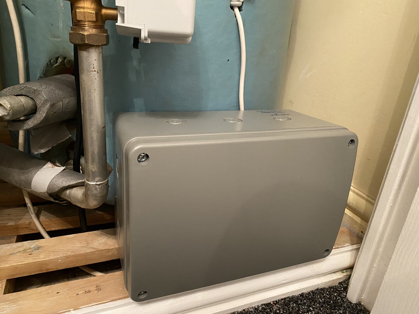

so I’m off out to buy a bigger jcn box and hopefully make everything correct and tidy
New jcn box fitted and all wiring back “as was” well almost
did best I could with wires that were literally cut to length like guitar strings ! But bit neater, easier to see what’s going on and all cables now identified and labeled
plumber had used the switch live (yellow wire) also connected to live to pump, cylinder stat switched live, 3 port switched live and frost stat switched live - he had used that at the boiler as the live and bridges across to RT
As there was a spare red wire (boiler cable) not used between junction box and boiler I have wired that as Live on boiler (removed bridge wire between Live & RT) and permanent live in jcn box, the boiler yellow wire linked in paragraph above, I have now wired to RT
all seems to be functioning correctly now and boiler now reacts to room stat and cylinder stat as I would expect
