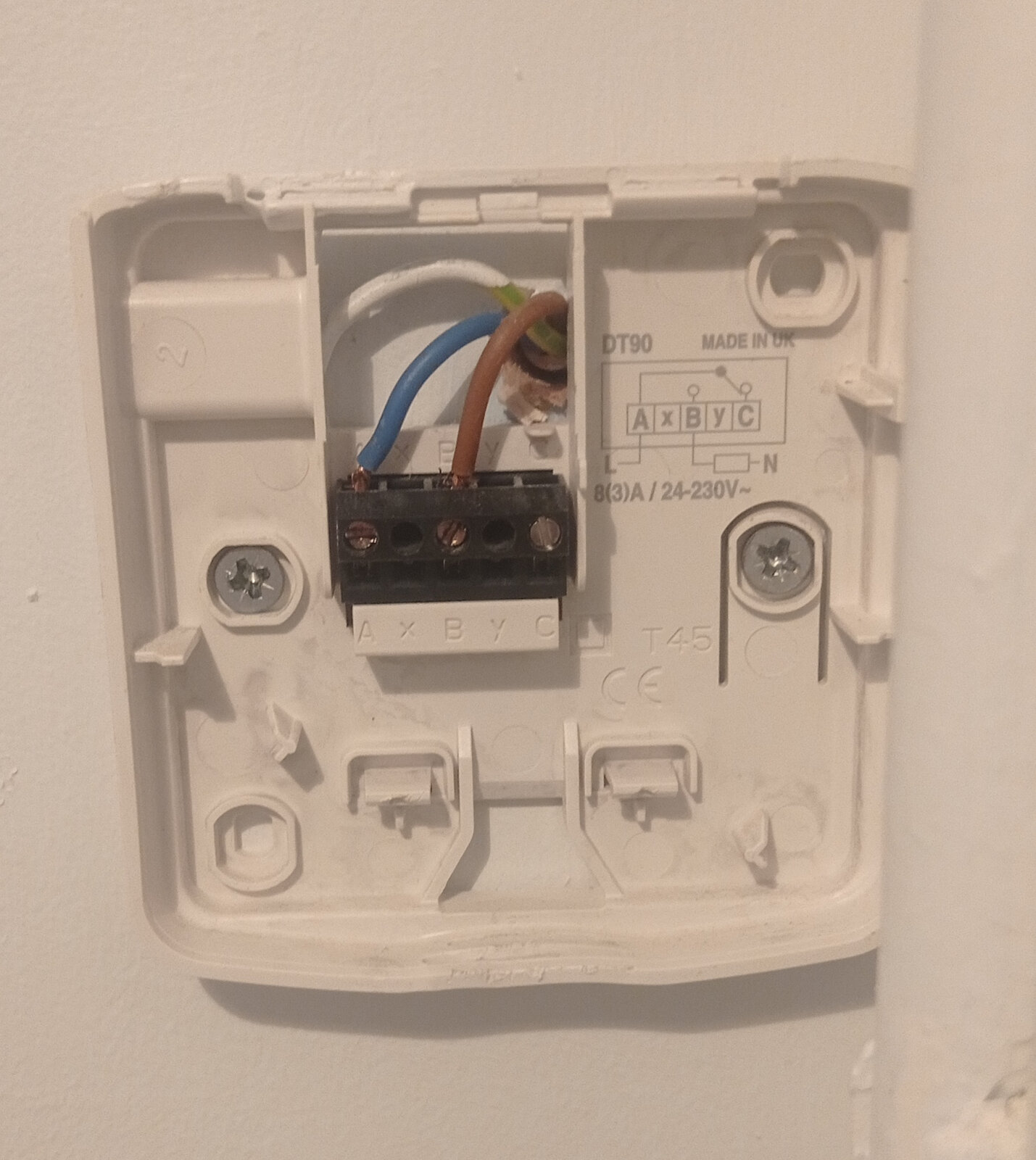

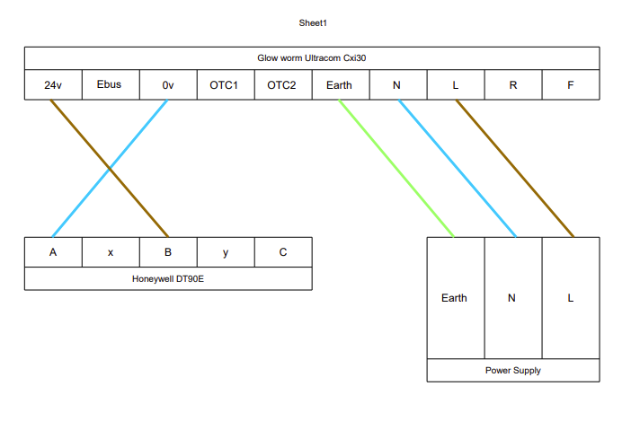

Looking on some advice for my parents if the boiler and thermostat are wired up correctly?
The boiler and thermostat were both installed around 2012 and I'm not sure if the thermostat has ever worked correctly. Any time my parents have wanted to increase the temperature in the house they've always gone to the boiler and pressed the advance button on the front to switch the boiler on for heat for the radiators as no matter what temperature is selected on the thermostat the boiler never fires up. I can hear the click in the thermostat when increasing the temperature, also I've replaced the batteries just in case.
I've attached a diagram of the current wiring set-up and a couple of pictures of the wiring in the boiler and thermostat for reference.

Before you turn anything back on you need to sort out that terrible wiring :(
It should work, as it's only a switch (wired up different terminals). Can you post photos of the boiler front and thermostat? Agree with @Mister Banks - wiring needs tidying.
Clearly wired by a cowboy as the cable clamps are not gripping cable, this will not stop it working, but rings alarm bells.
So it says ebus and unused terminals say opentherm which is confusing me as opentherm is a type of ebus, so I would start by down loading the manual for the boiler.
The boiler can likely be turned up/down or on/off, the up/down option is the best, but the thermostat is on/off.

Oh dear, what an absolute mess, the wiring is terrible.
The DT90 is simply a thermostat, in order for it to work the boilers internal control must be set to CH ON, if you actually paid somone to install that mess do not get them back, and switch the boiler on and off manually on the boiler control panel, the thermostat can not over ride the boiler timer it needs to be set to on
Edited
Oh dear, what an absolute mess, the wiring is terrible and completely wrong, that thermostat can not be connected to the ebus connection.
The DT90 is simply a thermostat, in order for it to work the boilers internal control must be set to CH ON, if you actually paid somone to install that mess do not get them back, in the meantime disconnect the two wires in the ebus connectors and switch the boiler on and off manually on the boiler control panel
I did wonder about that, but wasn’t entirely sure, as they’re seems to be another terminal for ebus, so thought it was just 24v.
I stand corrected, it can be installed like that, after looking again I can see that the OT wire is not used. I will edit my origional post

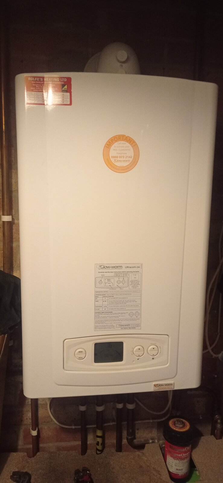

Thanks for the replies guys. food for thought, I'll have a read up in the manual. It was installed by a work colleague of my stepdads where he was working at the time. I've tidied up the wiring and clamped everything properly. I've uploaded a image of the boiler.

Providing the temperature is high enough on the front, could be the thermostat that’s failed. If you join the blue and brown wires together, does the boiler fire up?
I'll give that a go next time at my parents house. I'll also try disabling the internal timer and see if the thermostat does anything then.

its not the qualty of the thermostat, that is how it works, its a thermostat, leave the boiler timer set to constantly on and switch the boiler on and off with the thermostat
A small follow up. Taking ianmcd advice putting the boiler on constant the thermostat works perfectly. If I switch back to the boilers internal 24 hour timer the thermostat doesn't appear to be able to override the internal timer.
