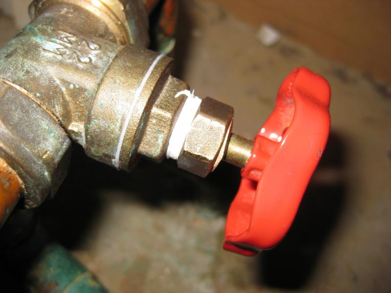

you might just get a new valve in if you undo the compression nut near the floor. you will need a certain amount of 'play' to get it in.
could be easier to spin the valve so it faces you. strip the gubbins out of it and make good all seals etc and reassemble.
B&Q will not be the cheapest place for a 22mm gate valve over the weekend.
most gate valves are compression, you might get away with re using the nuts and olives left on the pipe when you remove the old one. put some ptfe round the olives before you fit the new valve (not the thread)
if the nuts dont go onto the new valve easy enough do not force them, hacksaw carefully thru the old olives (without cutting the pipe) and prise off. then fit the new stuff.

I tightened the gland nut yesterday though and since then I have not been able to feel any water around the spindle but the pressure is still dropping!
Might be a silly question but if the valve is no longer wet and the pressure is still dropping then does that mean that this leaking valve was not the cause of the pressure loss or could it still be the cause even with no visible water leaking?
I think I may have overtightened the gland nut slightly too as it started to make a cracking noise when I turned it and I think the top of the nut looks like it has started to lift away from the rest of it:

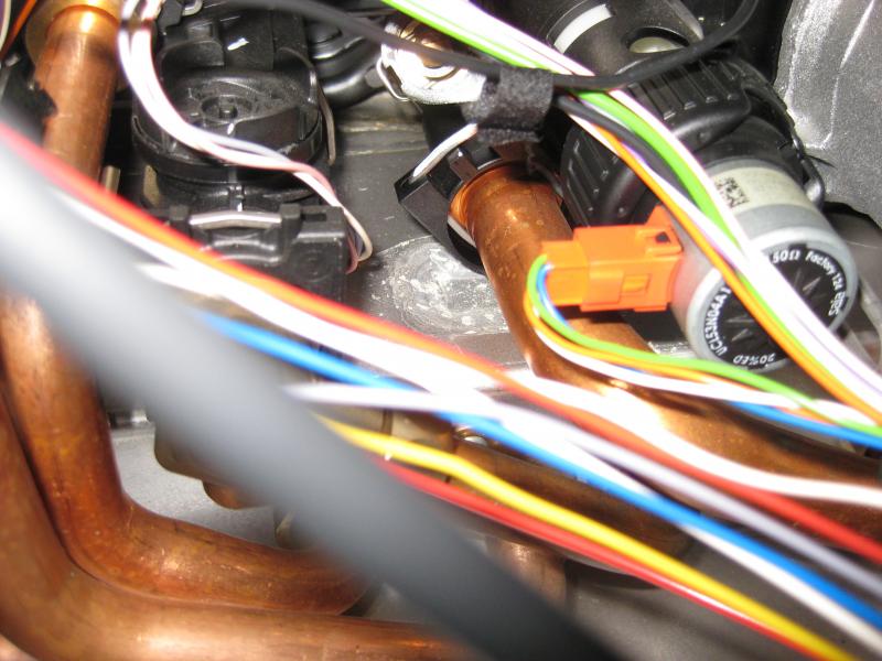

Also, probably nothing, but there is a lot of white residue in the bottom of the boiler which looks like the remains of a leak to me. This might be normal for the inside of a boiler though, I'm not really sure:

white residue is a common clue of internal leaks on a boiler, check all joints inside.

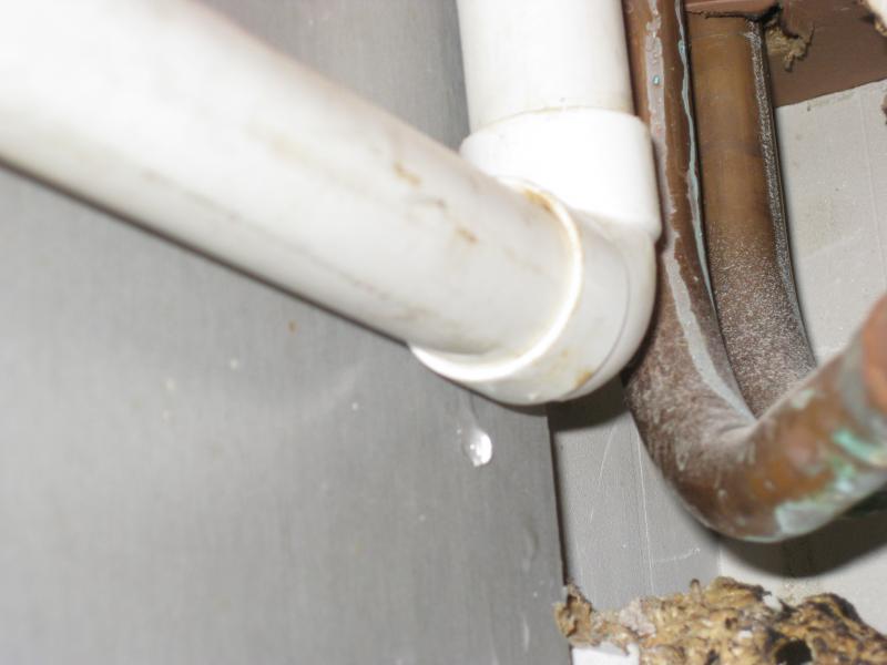

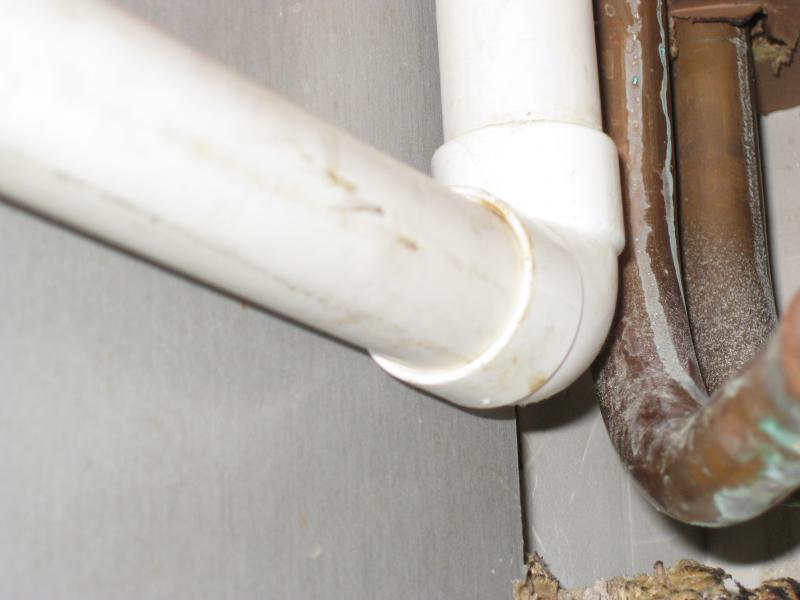

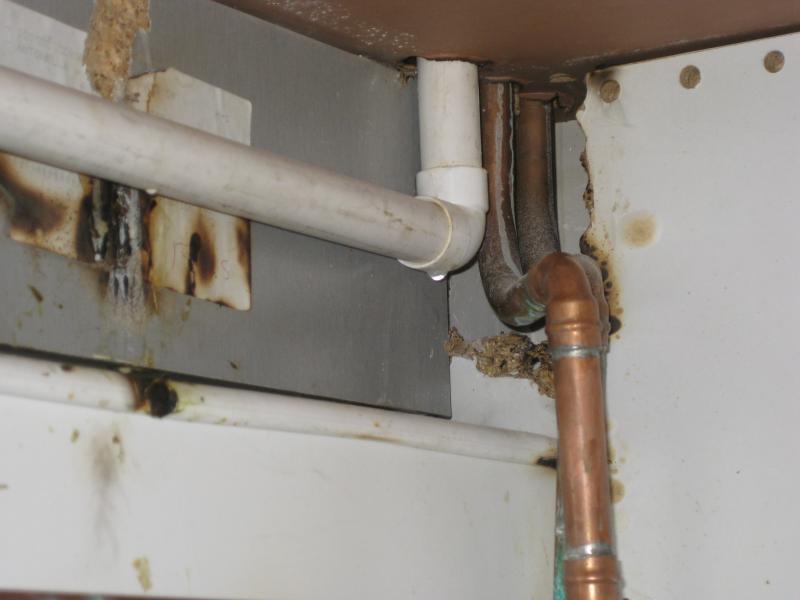

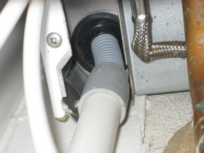

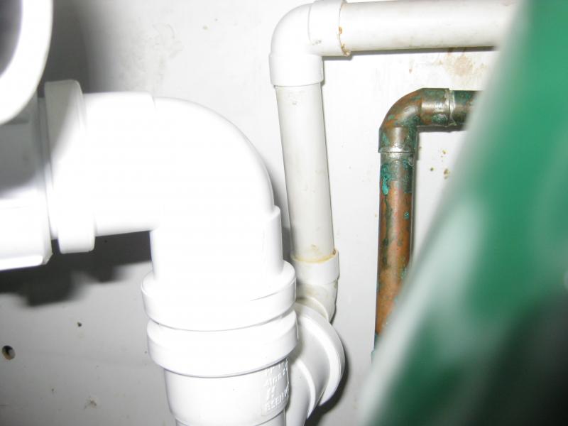

The condensate pipe comes out of the bottom left of the boiler, goes along the wall to the right and then down through the top of the work surface. It then goes along the back of a cupboard and ends at the drain pipe from the sink:
When taking these pictures just now I noticed what looked like a drop of water on one of the bends in this pipe in one of the pictures. This bend is about a full arms length away in an awkward shaped cupboard so its a bit hard to reach. I reached it though and felt what seemed like a bit of liquid then when I took another picture straight afterwards the drops were gone. Don't know if that's significant?:
Before:
After:

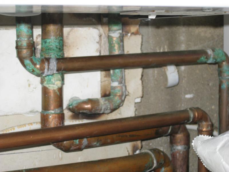

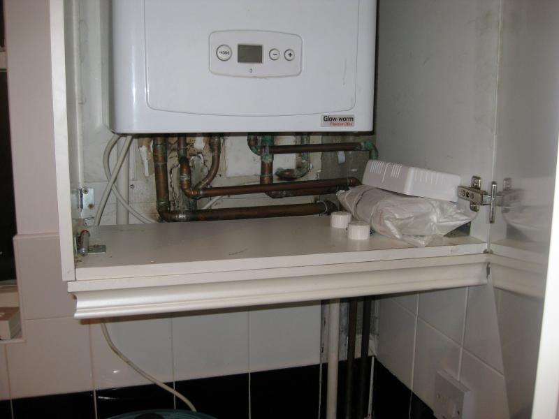

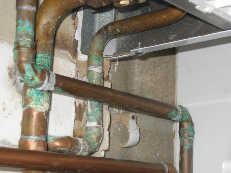

I think the blow off pipe is the pressure release pipe? If so it comes out of the boiler (pipe starting in the top right corner of the first pic) bends downwards and disappears outside through the wall of the kitchen, we are 2 floors up:
I can see no obvious leaks inside the boiler, although once about 4 months ago there was some drops of water coming out the bottom of it but this has never happened since. We have also had 3 visits from Glowworm technicians who have not found anything either. I just spotted the white residue in the bottom of the boiler yesterday and thought it looked suspicious.

things to try next.
1) with the boiler running upto temperature, feel the blow off pipe where it disappears through the wall, does it get hot? can you see where it exits the building? it should be visible from outside somewhere, is there a damp patch around it or is it dripping? it will be difficult to know which is yours if there is more than one sticking out.
2)with the boiler turned off, disconnect the white condense pipe from the grey pipe under the boiler, put a bowl underneath it to catch any drips. do the drips continue? do they stop eventually?
3)is the automatic air vent working ok? is the plastic nut on top loose? does water come out if it is loosened?

leave it disconnected for the length of time it takes for the boiler to lose pressure or the bowl overflows.
you shouldnt get near a bowl full, if you do then it means the HE has gone on the boiler.
condense pipe takes condensation away from the boiler and disposes of it.
the blow off pipe shouldnt get warm at all, but it might be heat conducted along the pipe. unless you can rule this out for definite.

White marks in your boiler could possibly be a leak from black flexible tube in the back left hand corner of the boiler. These are prone to leaking when system is cold. The flexible tube might not be fitted as it has be updated to a copper tube so problem doesn't happen on later models.
