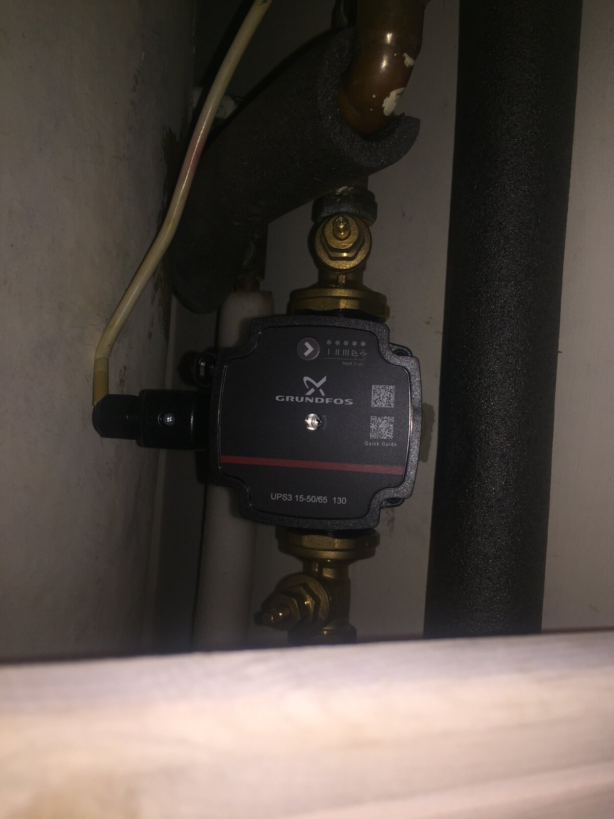

* Pump† = GRUNDFOS UPS3 15-50/65 130

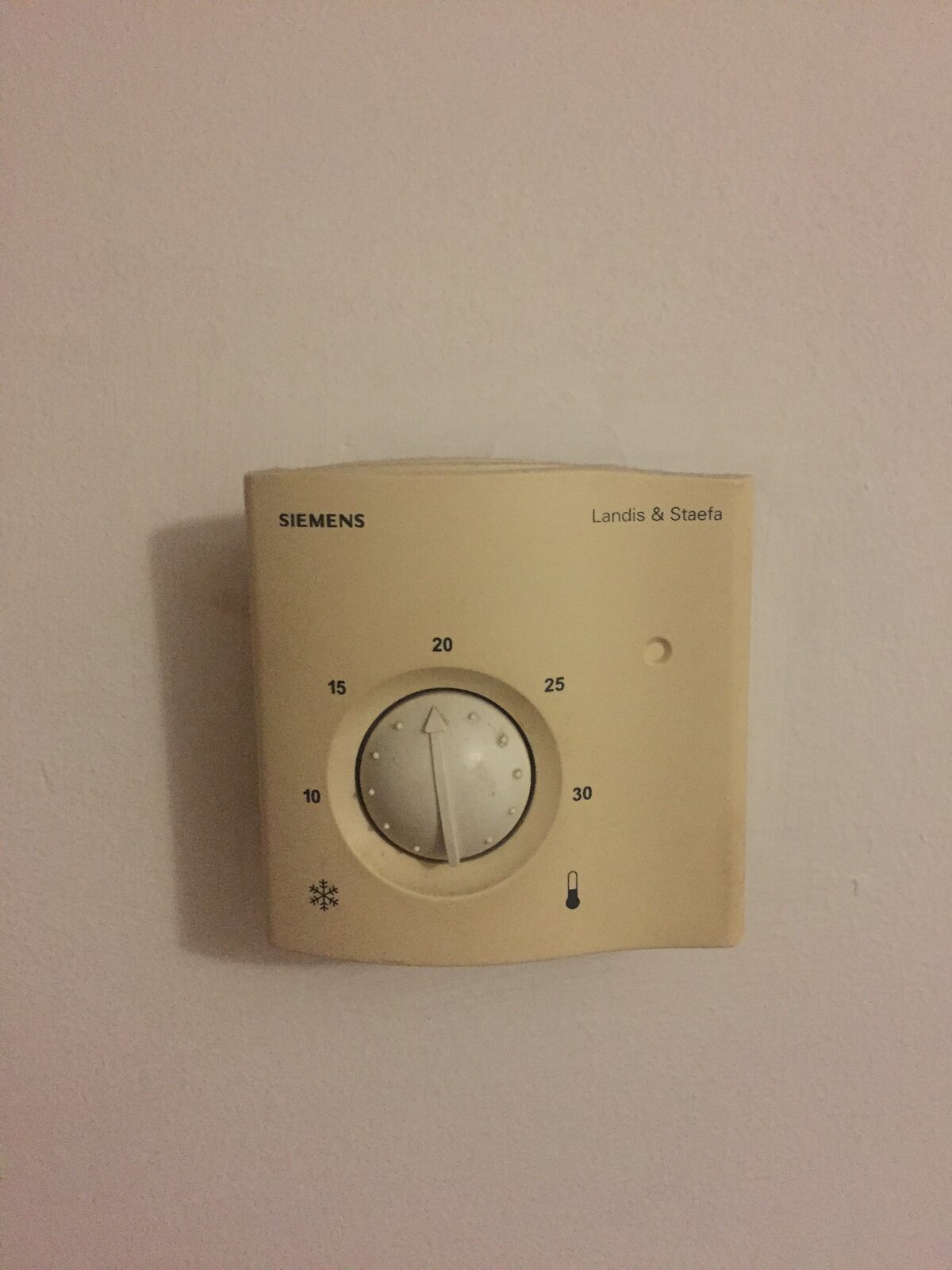

* Thermostat = Siemens Landis & Staefa (unknown model)

† This is not the original pump as during these recent visits it had to be replaced (started to make an awful noise)

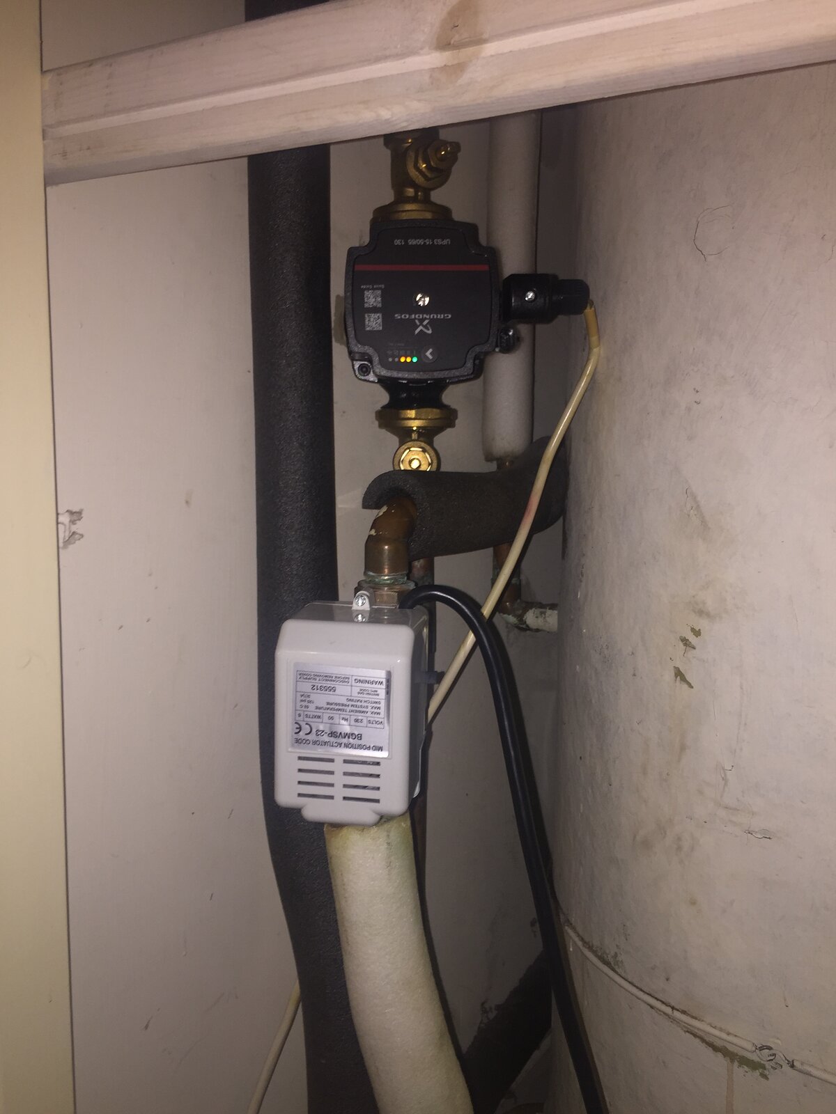

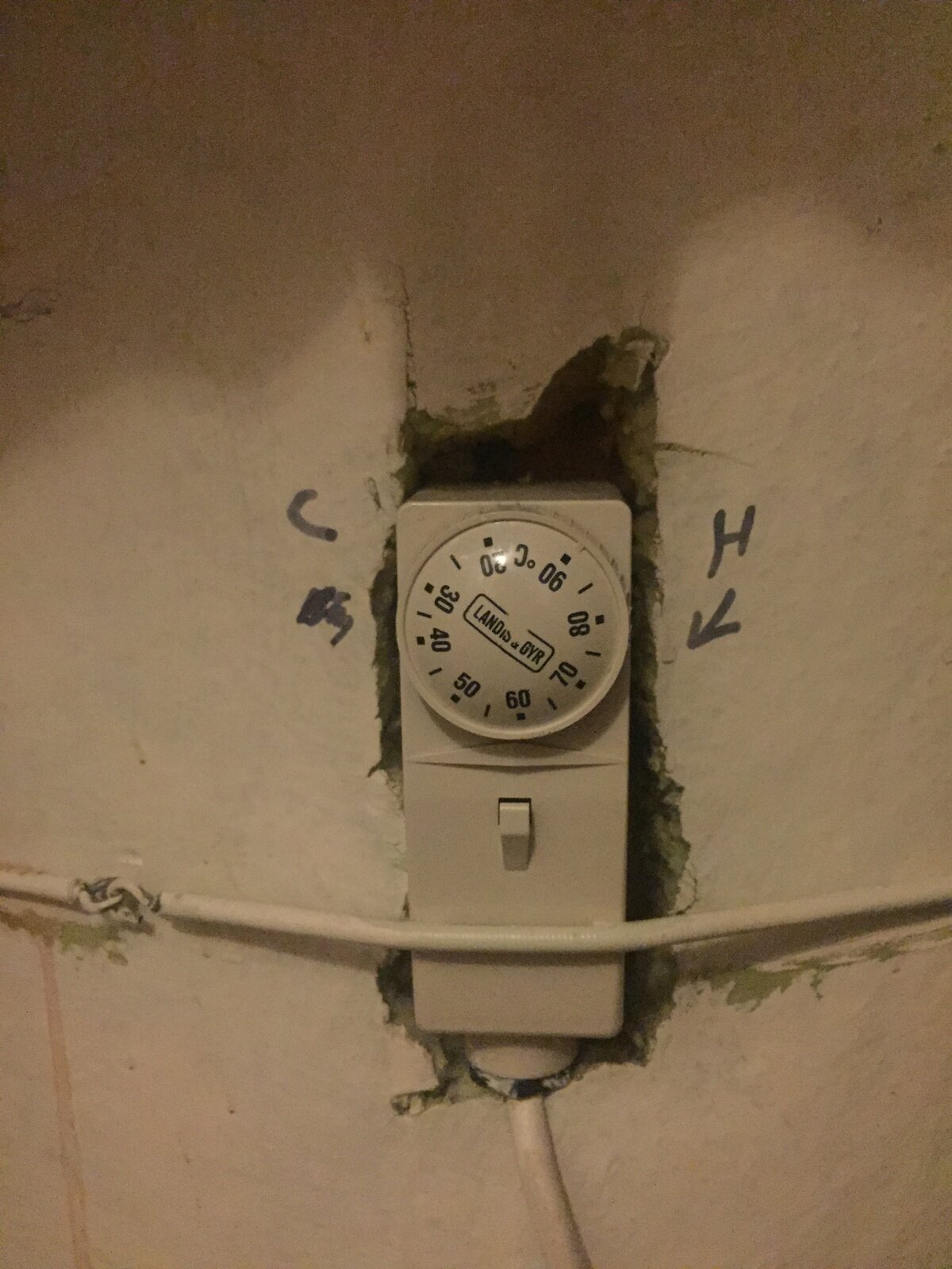

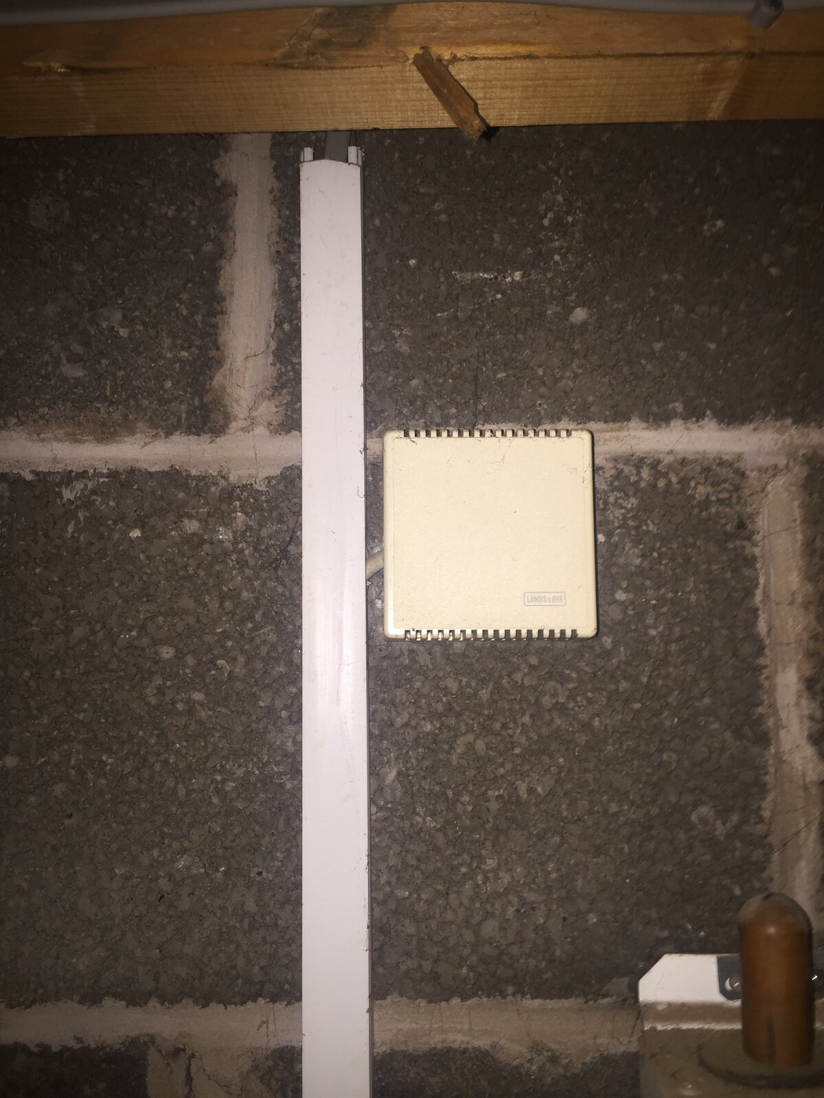

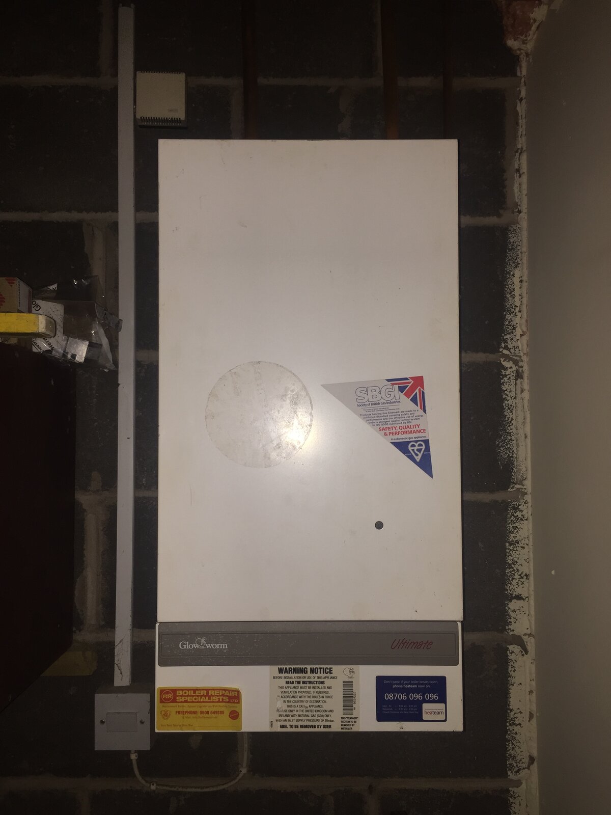

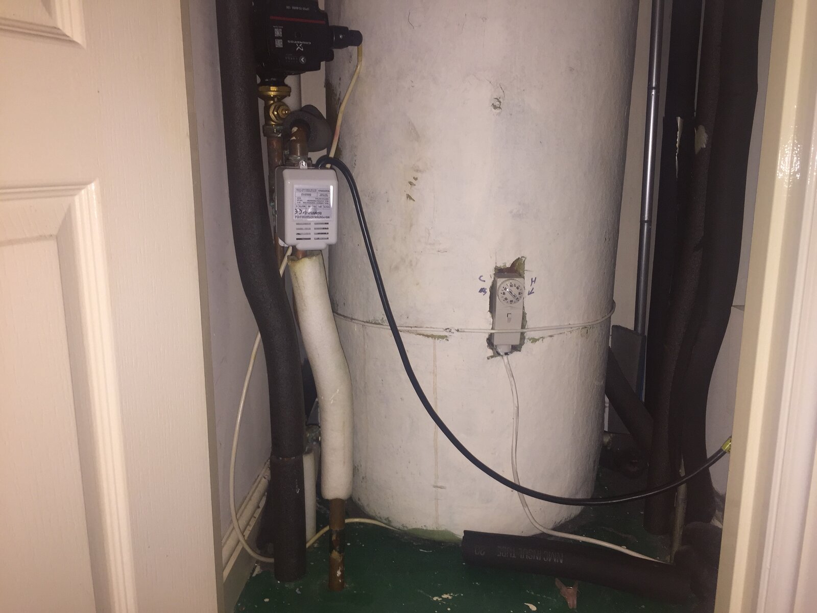

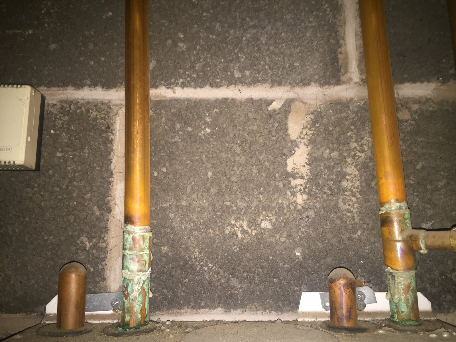

Attached is most of the heating system except the tank in the loft.
Boiler - Top.JPG Possible frost protection sensor.JPG Boiler - Overview.JPG Thermostat .JPG Airing cupboard.JPG Pump.JPG Actuator.JPG Airing cubard - details.JPG Cylinder temp dial.JPG
OK you definately have an open vented, Y Plan fully pumped sytem, not a gravity HW system, when you select CH on only and not HW on doest the HW on indicator come on without being selected ?

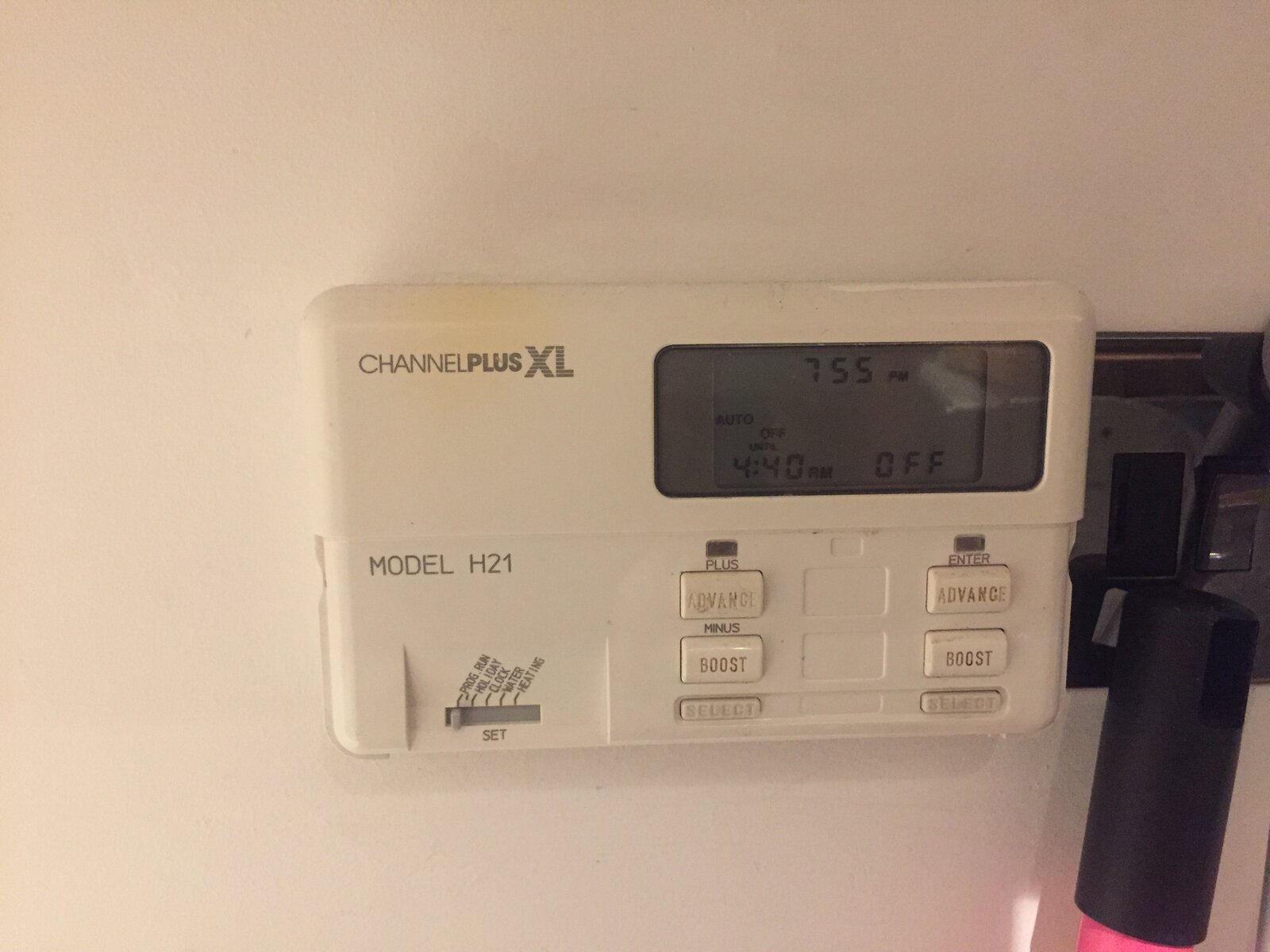

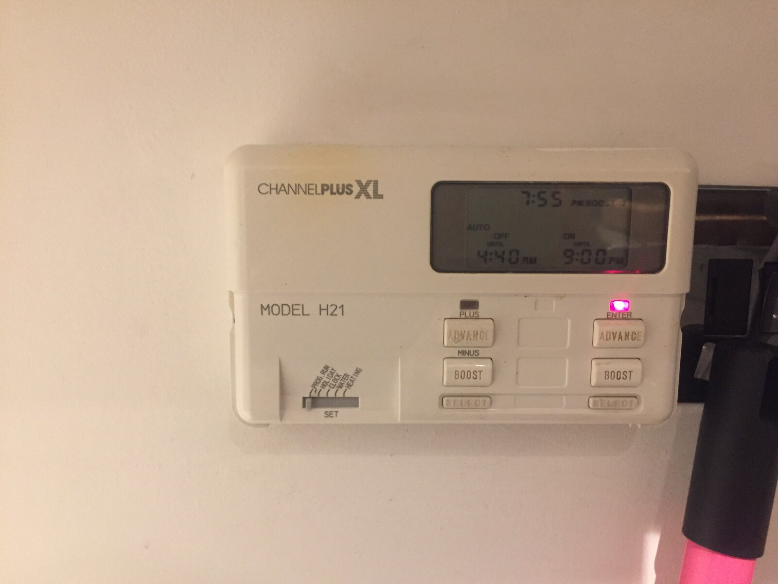

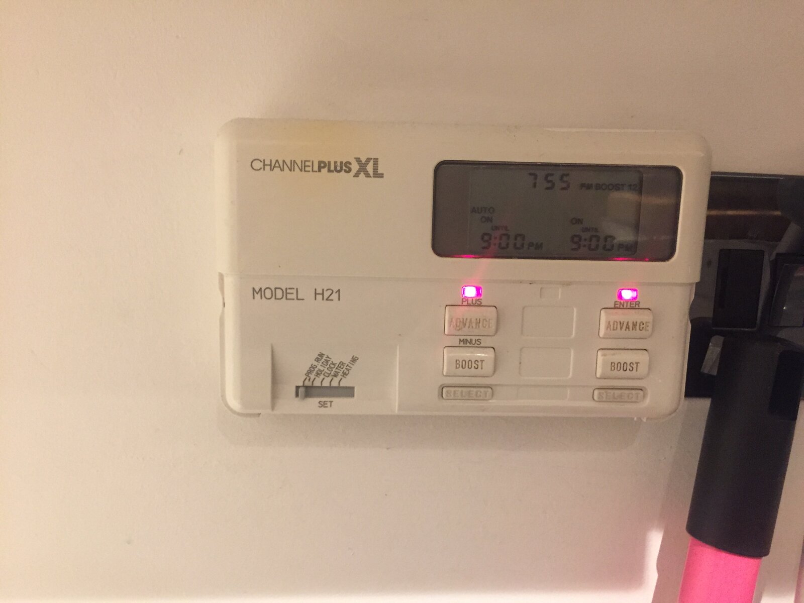

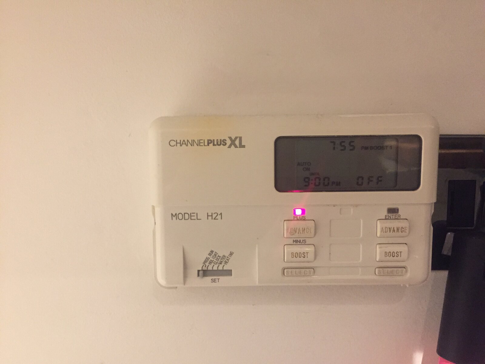

Sorry, the programmer picture didn't attached to my last message.
On the programmer I can turn on Hot Water or Central Heating and only one light shows for the relevant service. There are 4 possible combinations as pictured this time
Programmer - Both .JPG Programmer - Central Heating Only.JPG Programmer - Hot Water Only.JPG Programmer - All off.JPG
Basic checks at the wiring centre would reveal what the issue is.

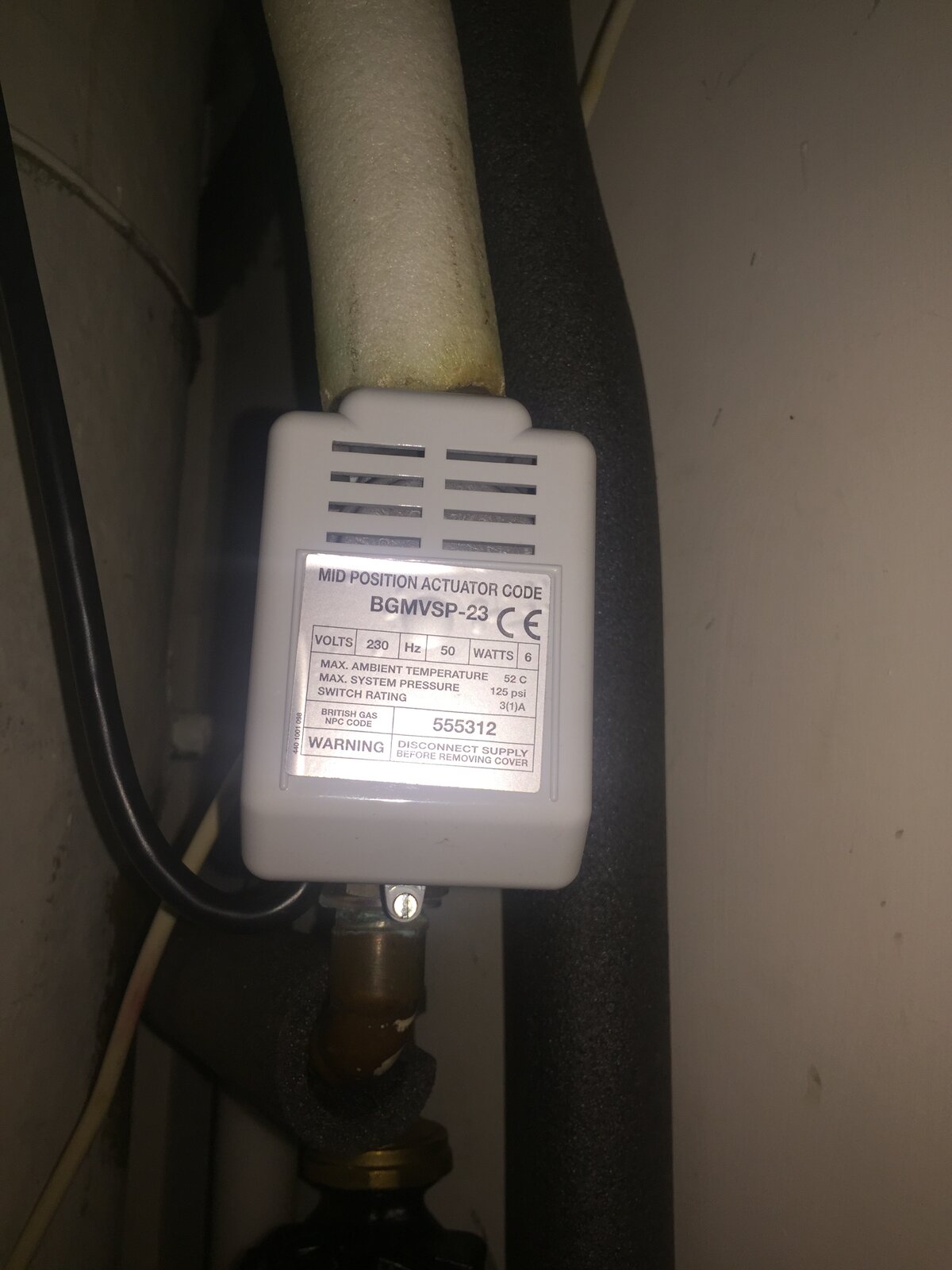

I've just checked that the actuator cycles through the 3 phases. Each combination of the HW, CH as well as HWCH from the controls results in the actuator indicator been in a new location. It is missing the label with the text next to the indicator so can't confirm 100% they are been set to the right value each time but they are been set to "something" different for each combination.
Something to note, when the pump was replaced there was an escape of hot water (isolator valves around the pump has seized), I suspect the hot water may have washed off the label on the side.
Based on all this would is it likely the cause of the issue to be the wiring in the wiring centre been incorrect or something failing with the the mid-position valve (either mechanically or electrically)?
then you programmer is set as fully pumped, has it ever worked properly , if yes I would be looking at a fault actuator, if no I would be looking at the wiring
Mid position valve problem most likely. The MPV sends voltage to the boiler for it to fire up. Checking the voltages at the wiring centre would confirm if the MPV is ,or isn't doing so.

Update on the case for anyone looking in the future. Wiring check confirmed MPV was not outputting the voltage to fire the boiler (heard something re 50v instead of 240v). MPV "outter" part replaced (with Drayton MA1) and we are able to request heating only. Feel all set for winter now :)
