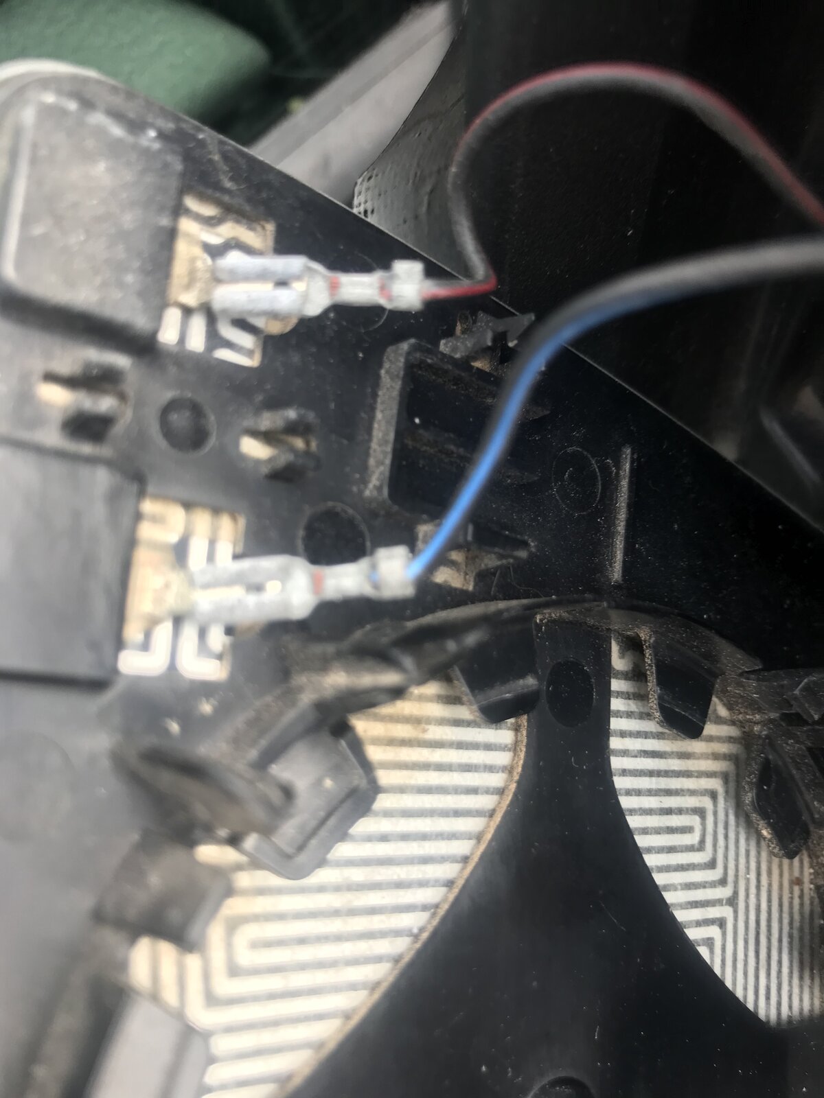

Have bought replacement stick on mirror for my Golf. (Original not cracked, just loose) In many of videos, you can remove backing plate from wing mirror to do the task. However, in my case the connectors seem to be welded to the wing mirror. (2013 Golf-not heated, just needed for tilting etc)
Don’t want to yank them off if welded.
Any advice much appreciated.

They look like the usual push fit Lucar 3 amp connectors....there may be some corrosion there which is making them tight but they should still pull off.
Try some WD40 or whatever to make things easier first and gently use some snipe nose pliers.

I'm confused. That's a heated mirror. Mine kept falling off. I stuck them back on with 3m VHB
Thanks both
I naively assumed wing mirrors weren’t heated, as never seem to clear. Have used WD40 to ease off connectors as suggested.

They don’t come on automatically with the rear screen like some Fords do, you have to turn them on using the same button you use to adjust them. Just turn the knob until the dot lines up with the heated mirror symbol.
