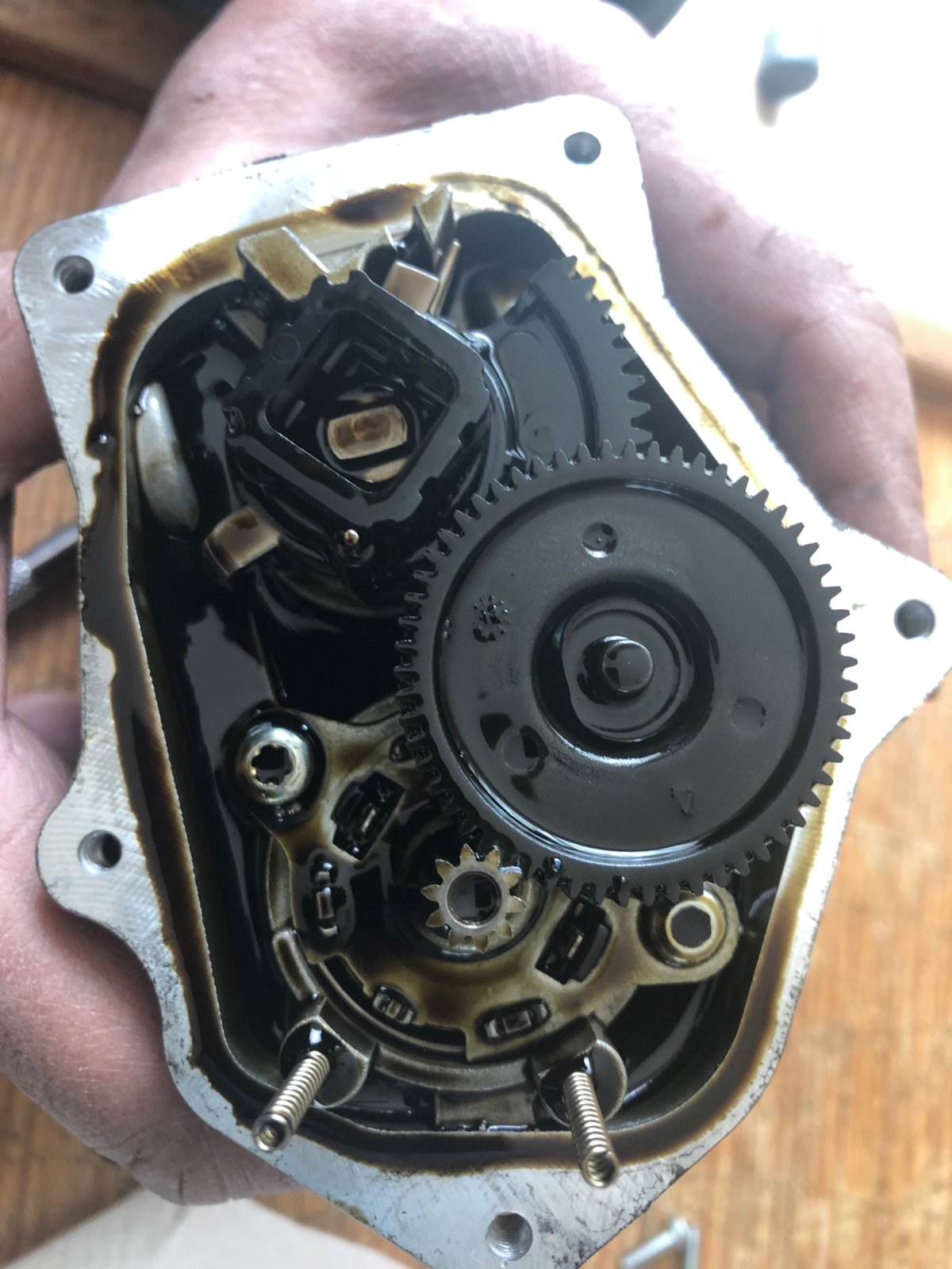

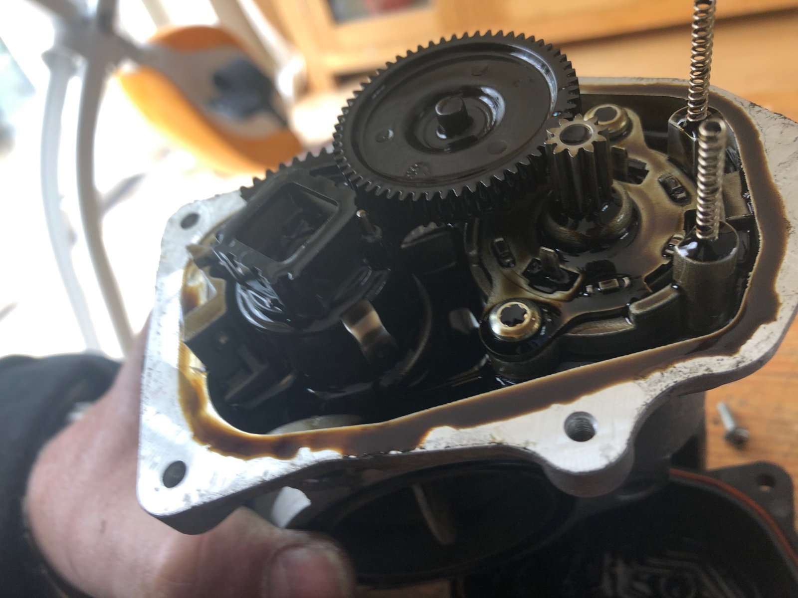

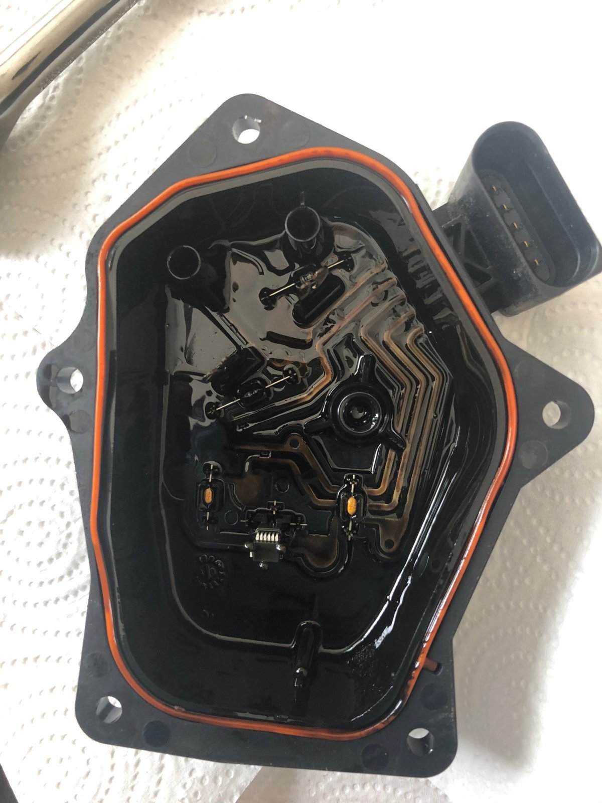

Many thanks for your replies really appreciate it. Update today was took off the throttle body again, opened black PVC cover the for electronic / mechanical gears are. The whole compartment was Full of Oil!!!! Drained off half a litre of oil and God know how it got in there as the seal was in intact!
Removed the gears, springs and motor all where fully immersed in oil. Sprayed and who electronic circuit board and throttle body with WD40 and cleaned everything out meticulously. Re-assembled the unit and relocated it back into engine inlet manifold.
Cleared codes out and took car for a long run placing different loads on the engines etc.
So far all seems fine!!!! No Engine light on no codes!!!!!!
Hopefully this has fixed the problem!!!
Many Thanks all once again.

Caesar, this deserves respect with a capital R (y)
1/2 a litre of oil? Where the hell did that come from :eek:
I’ve only opened one of these before (early Polo) and that was dry.
Anyone care to comment?
John :)
Not sure on the vw setup but on other marques the crankcase ventilation is directed back through inlet and this mixed with the soot gunges up the inlet manifolds.
Some redirect this to a seperate catch tank.
And well done to the OP.
For sure I’m well familiar with closed crankcase ventilation and have often scraped incredible layers of crap off the butterflies and so on - with this one how the thing was still performing well is beyond me.
So, in future I’ll split the next one instead of just fitting new, so cheers (hail?) Caesar (y)
John :)
