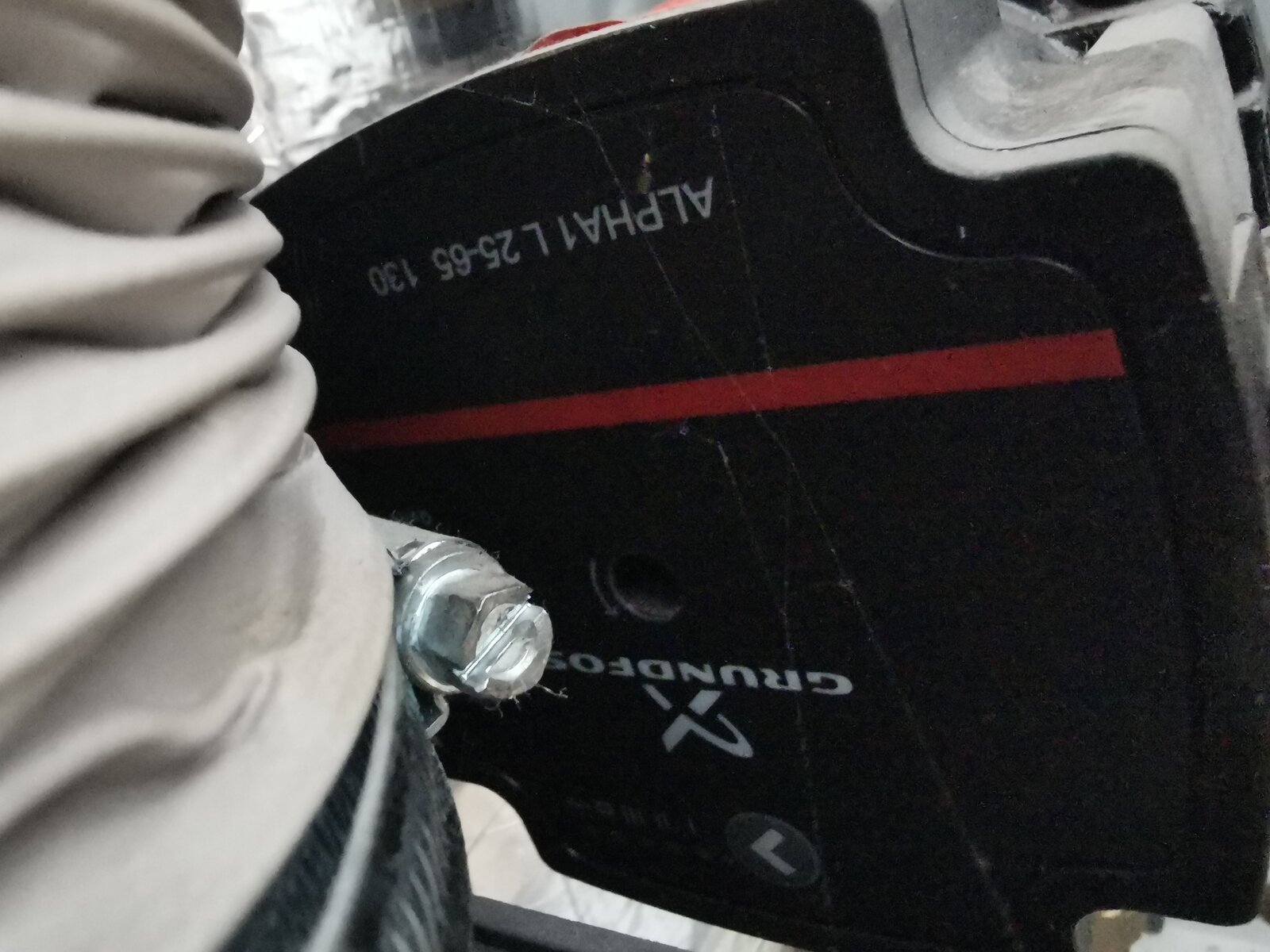

Hi. The pump lights are green, orange, orange. Is that correct. Thankyou.

Picture of said pump please

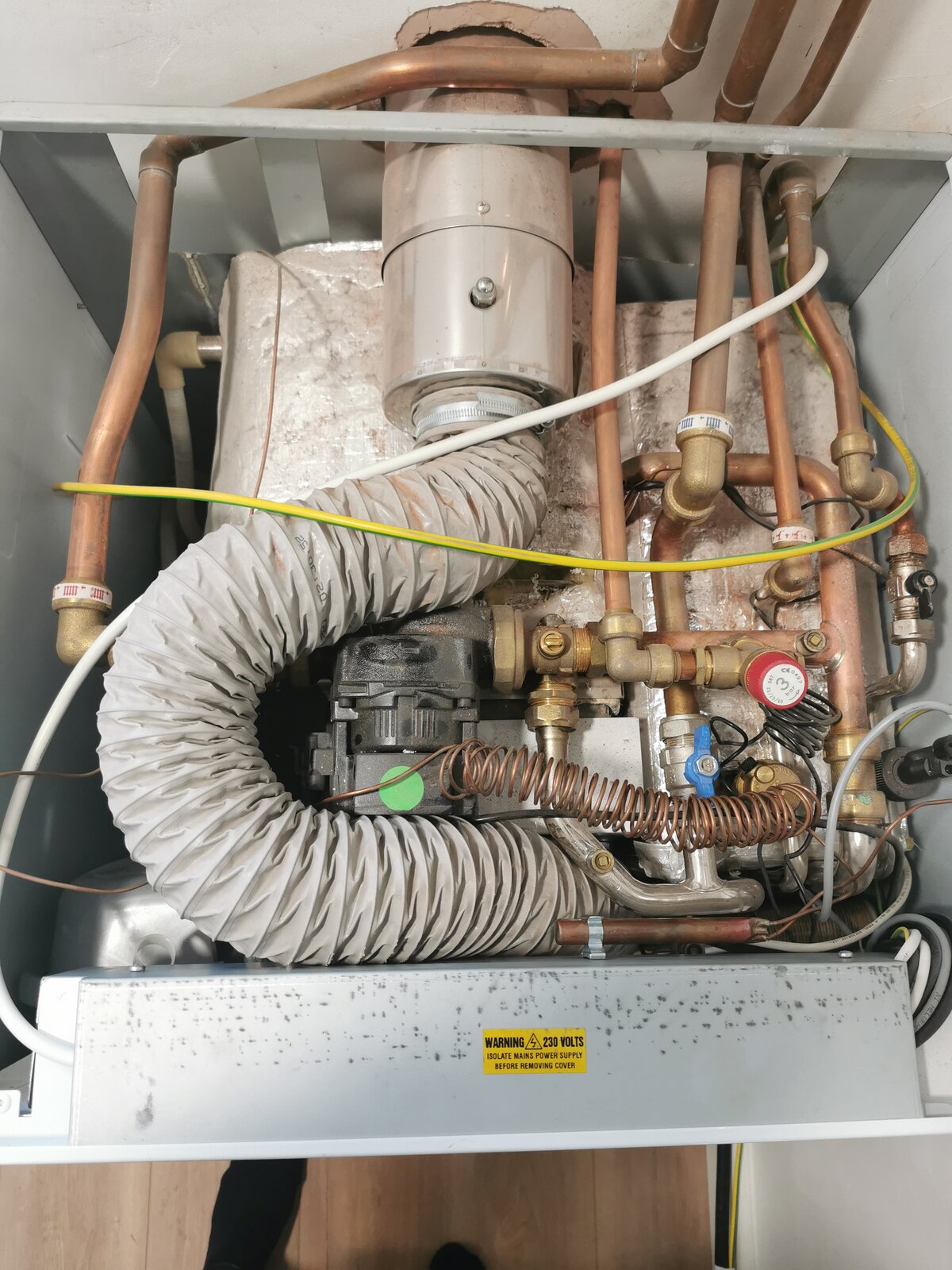

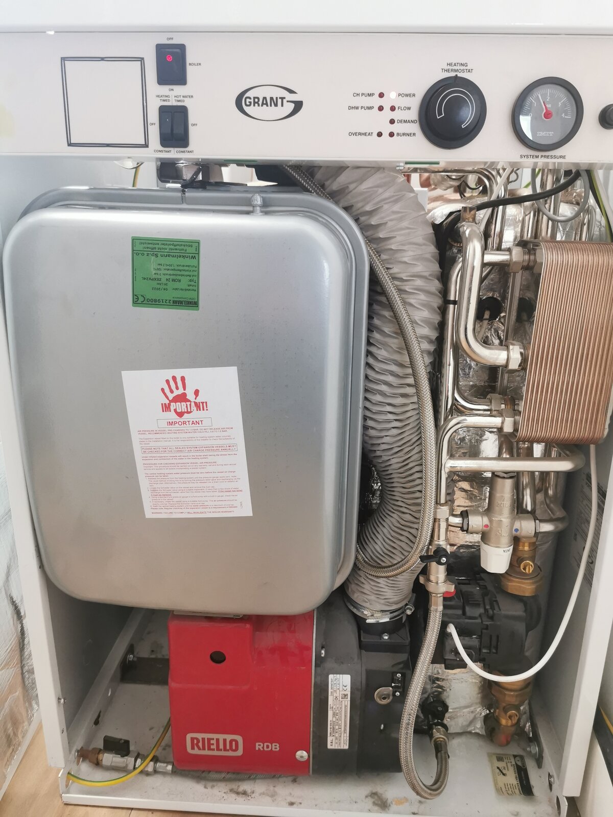

Take both top covers off and take a clear picture of pipework to boiler.
We have found on the Grant combi's dependent on pipework layout extra air valves are useful.

Can't get better one of pump. Thank you.

OK the pump settings you have are correct (constant curve 3)

Pipework looks to be no problem I would say going to need eyes/hands on.
Either get installer back or talk to Grant there technical helpline is excellent.
Maybe looking at air ingress on inlet side of pump.

With regards to the suspected air ingress. Do you mean on the pump itself? Thanks.
