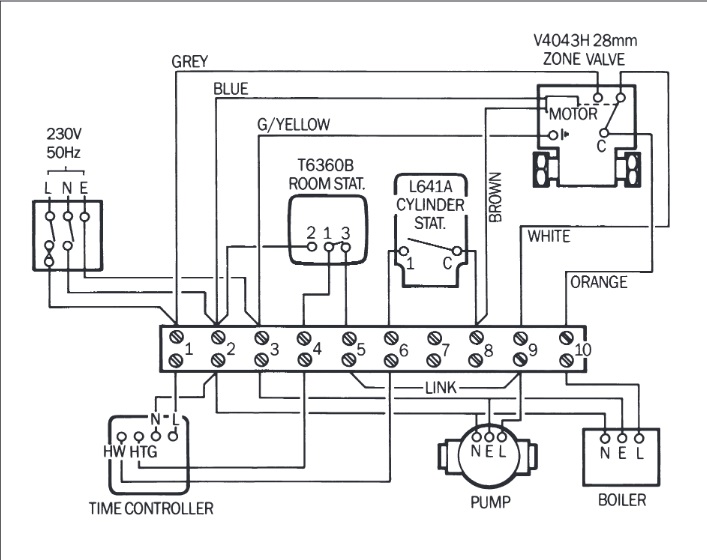

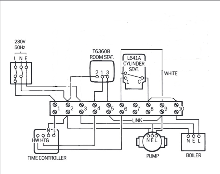

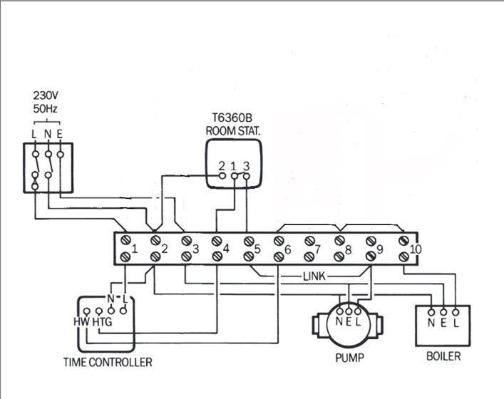

There are three basic diagrams, C-Plan_old2.jpgthis was the norm for years, then we added the tank thermostat C-Plan_old.jpgand finally we added a motorised valve, C-Plan.jpgall C Plan means is it is thermo syphon, and smart thermostats have different ways to control it.

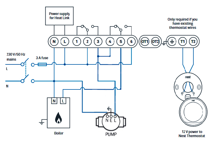

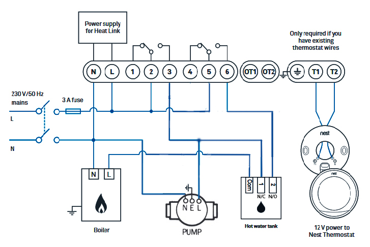

Hive has a separate supply to pump and boiler, and a software fix, Nest uses the fact it has volt free contacts C-Plan_basic_Nest.jpg I think this C-Plan_basic_Nest_tank_stat.jpgwill likely work with Nest, however I feel Nest is a poor option as it has no option to work with TRV heads.
Many systems are like Hive, with terminals internally connected, I think the Nest second diagram will work, but I have not tried it, so crossing fingers I have made no errors.
So wait for a few more replies and see if they think my diagram wrong, I remember doing boolean logic, but a long time ago, so maybe I have made an error.
