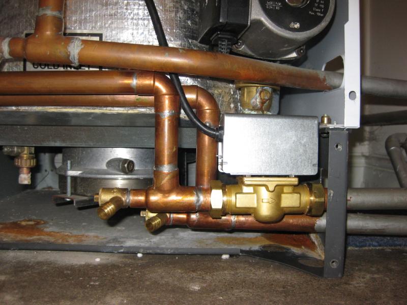

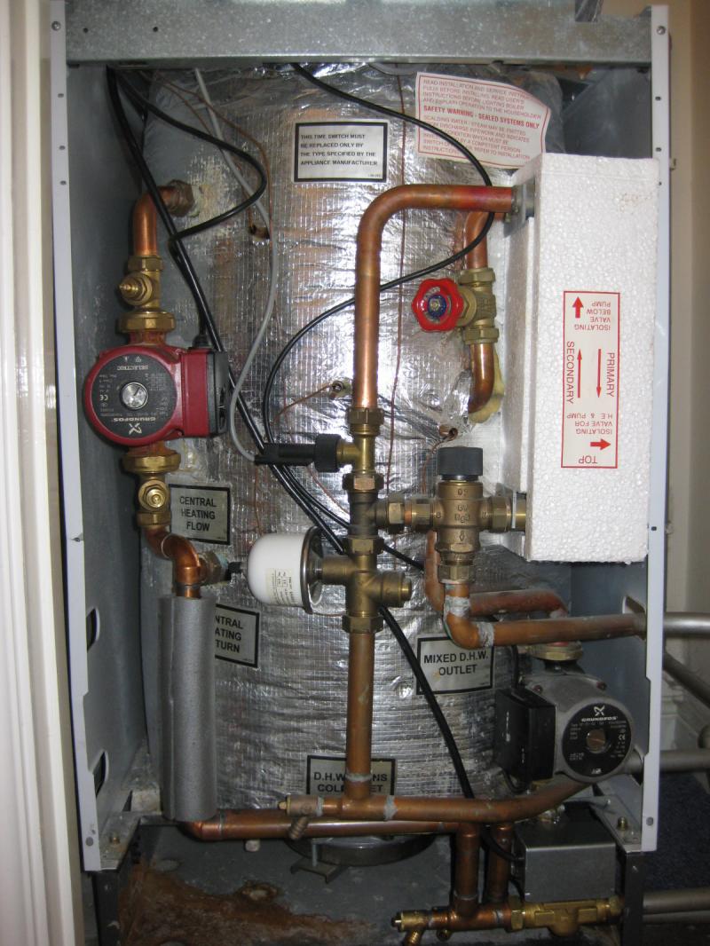

I had exactly the same experience with a swing valve so in the end I too fitted a zone valve.
I used the power to the pump to open the valve and the microswitch in the actuator was then used to turn on the pump.
Couple of images below

I discussed it with my engineer and as the gas and combustion sides would retain integrity I did it myself.
Couple of tips :-
The manual says to not plumb across the front bottom of the boiler. Mine was plumbed here so I re-plumbed. This is to allow access to the 'sump'.
The position of the new valve does not allow access to the actuator screws to remove the actuator head on failure. I have had one failure so had to use pipe wrench to turn the valve body on the pipe to allow the actuator to be replaced. Then re-positioned valve and tightened up.
Looking at the pictures I do not know why I didn't fit the valve immediately below the CH pump, there may be reason.
I used a valve and actuator that were a cheaper copy of the Honeywell. Yes, it was cheaper, but as I have had to replace the actuator it was false economy. I have now fitted a Honeywell actuator.
HTH
andytw

Thanks for these tips! My boiler had a service this morning so I had a look inside to see what was what. I have some of the flexible metal pipes instead of solid plumbing, so it looks slightly different to yours. I am not particularly competent with these things so will get a proper plumber in to do the work.
