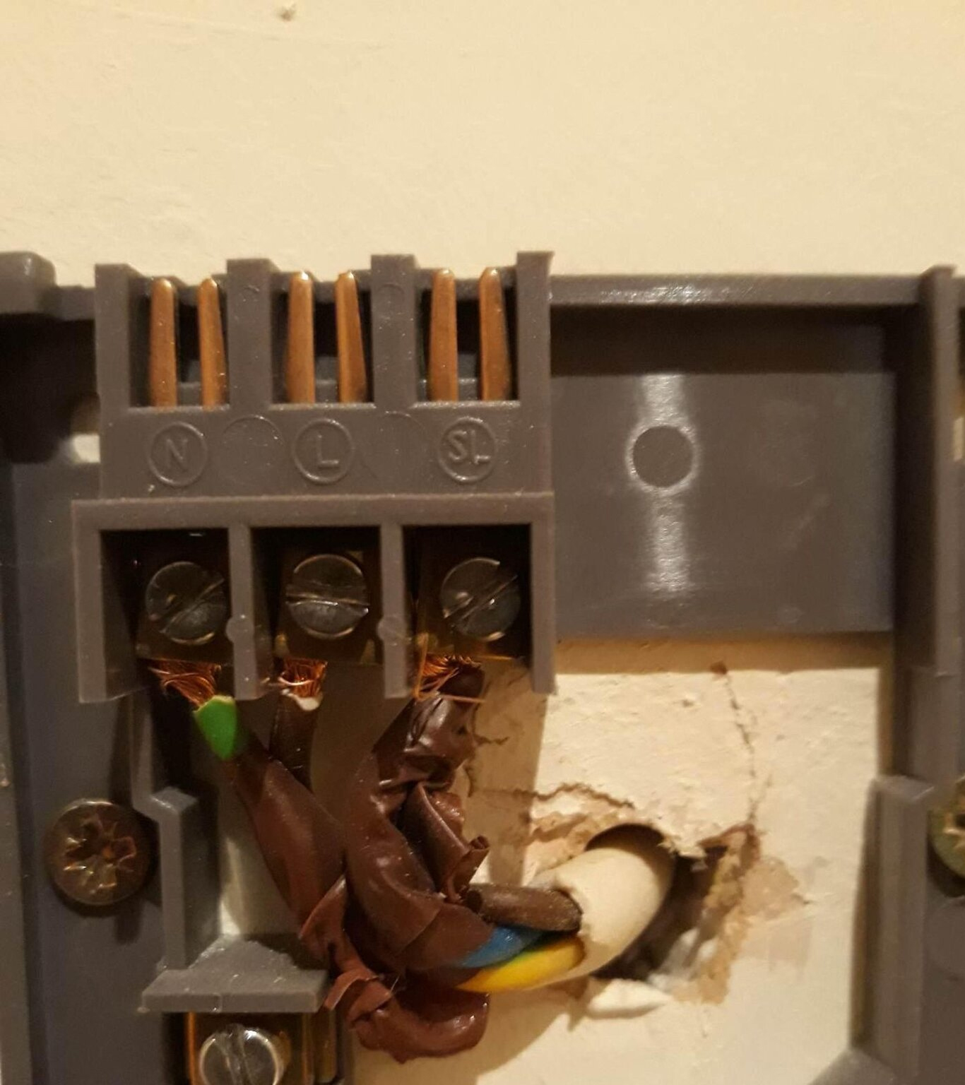

I have re-read @JohnW2 comments, and with a flex we would assume not fixed, and if not fixed I can see when not considered part of an installation, so for example a class II extractor fan to a FCU one would consider that being OK without an earth, but supply to FCU would have one.
But this temp.jpg may be wired in flex, but where the wires are routed means it is fixed and that brown tape does not really comply with how I read the regulations. The same here temp.jpg @stem referred to it as bad practice, I would say it boarders on being a C2. If we look at the plumbing section it seems to be the norm temp.jpg again and again earth coloured wires being used as line, being over marked. There is normally an expensive way around the problem Nest e for example, or very cheap mechanical thermostats will often work without a neutral, although with a large hysteresis, not even sure a large hysteresis is bad, as the thermostat is often only there to stop the boiler cycling once all rooms satisfied. The TRV controls temperature.
