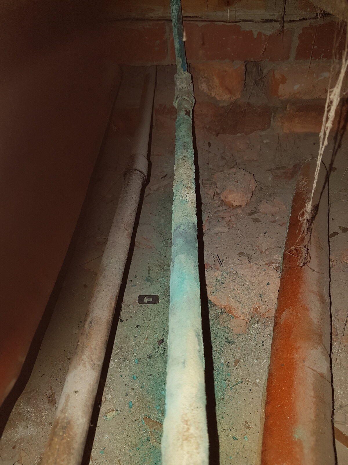

I have the floorboards up and have noticed one length of CH pipe that is thick with green crust along it's entire length (It's about 2m long, between two compression joints). Its as dry as a bone so no abvious leaks. Do I need to be concerned and replace it?

indoors? a "crust" sounds odd all the way along the pipe. It's more common at a joint, from flux or a water leak.
I like to clean it off with a green nylon scouring pad and wipe off with a damp cloth.
If, in future, it comes back, that indicates an active leak and is easy to spot.
Maybe Ken gets more industrial pollution, but my copper pipes, indoors or out, just patinate to dark brown, like an old penny.
Bargain Bucket - would you post a pic? I'm with JohnD -never seen verdigris like yours on an inside pipe.
Will do. Might take a day or so as my I did my back in last night (recurring problem as I get older).
As requested, here's the green pipe.
