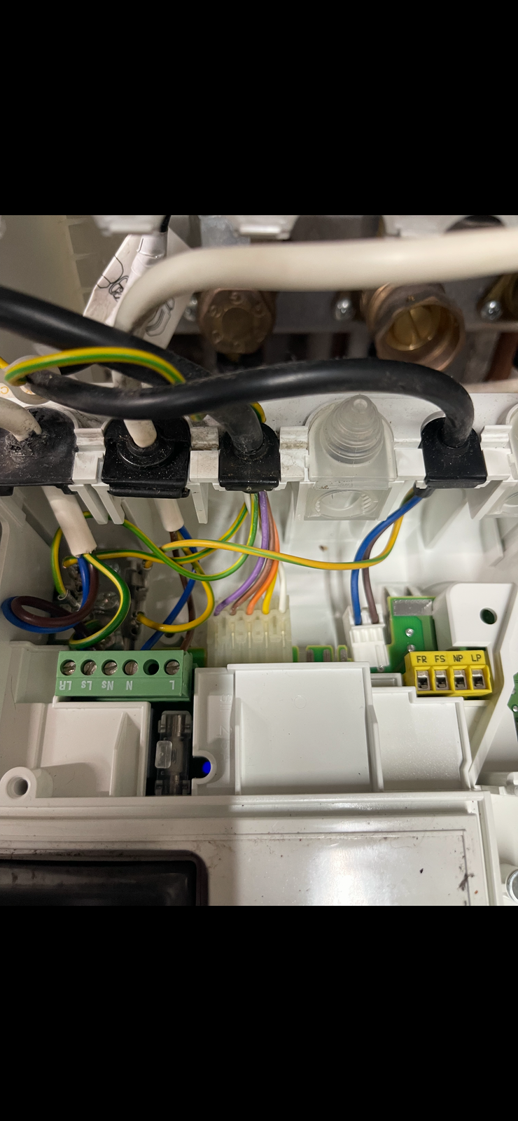

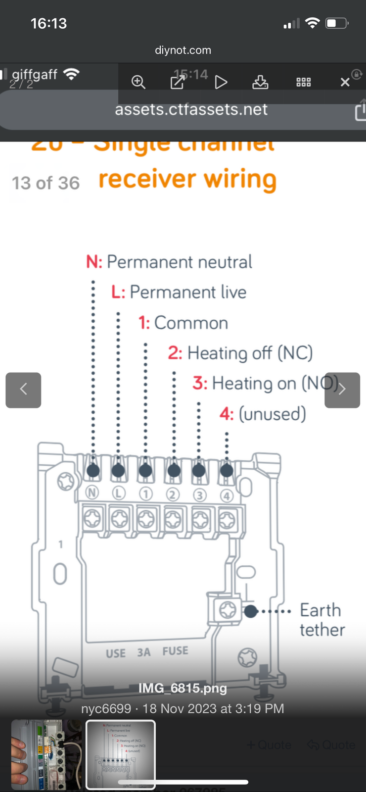

Hi all, Can you clarify the following for me please for a single channel hive connection into the boiler. I’ve read similar posts but not quite the same set up.
Picture 1 is inside the boiler.
Picture 2 is the single channel.
Is it LS on the boiler to 1 (common) on the hive and LR to 3 (heating on) on the hive.
Is it only 2 wires or do I need to find a live from somewhere.
Many thanks and appreciate any help.
Yes
No, it’s 4 wires. What do you think permanent live and permanent neutral mean? Also, on that boiler, you may need to safety check afterwards if the cover forms part of the combustion circuit.
It would be:
Ls (Live supply) from boiler to L on the Hive receiver backplate.
Ns (Neutral supply) to N on the Hive.
Lr (Live return) from terminal 3 on the Hive.
Earth, to earth.
A short link wire would be added between L and terminal 1 on the Hive.
You would need a four core flex to wire as above.
Is that a picture of your boiler?
There seems to be some flex already connected to the Lr and Ls terminals?
You need a permanent live & neutral into the Hive which you can take from the boiler, then connect Ls to T1 & Lr to T3.
I use 4 core cable
I use 4 core cable
Wouldn't you use a five core cable, if you are connecting Ls and Lr separately to T1 and T3?
Doesn't need an earth, just there as a tether. Can get away with 3 core if need be.
Agreed, the Hive doesn't need an earth (although try arguing on the electrics forum about all points, or outlets requiring a connection!).
My point is; as the oversleeving of a green/yellow core as a live conductor, is now explicitly banned in the regs, and finding a flex without a green/yellow earth core is difficult; you necessarily have to have a 4 core flex.
Or as has been suggested above, keeping Ls and Lr separate, and not using a link on the Hive, then that would require a 5 core flex.
If we suggest using a 3 core flex, naturally a DIYer will pick up a standard cable. Of course it would still work, but I would prefer to give advice that was compliant with the regs :)
