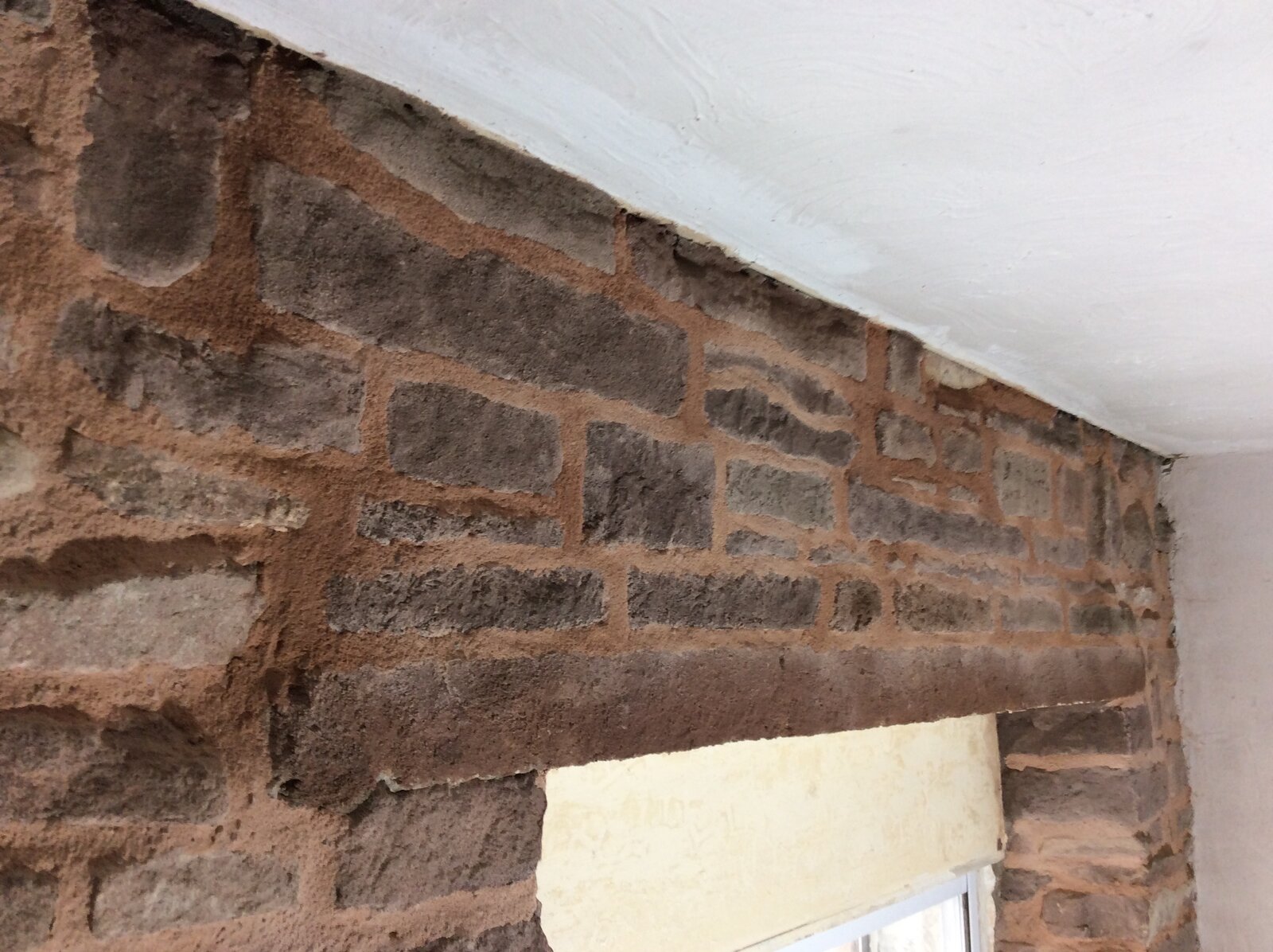

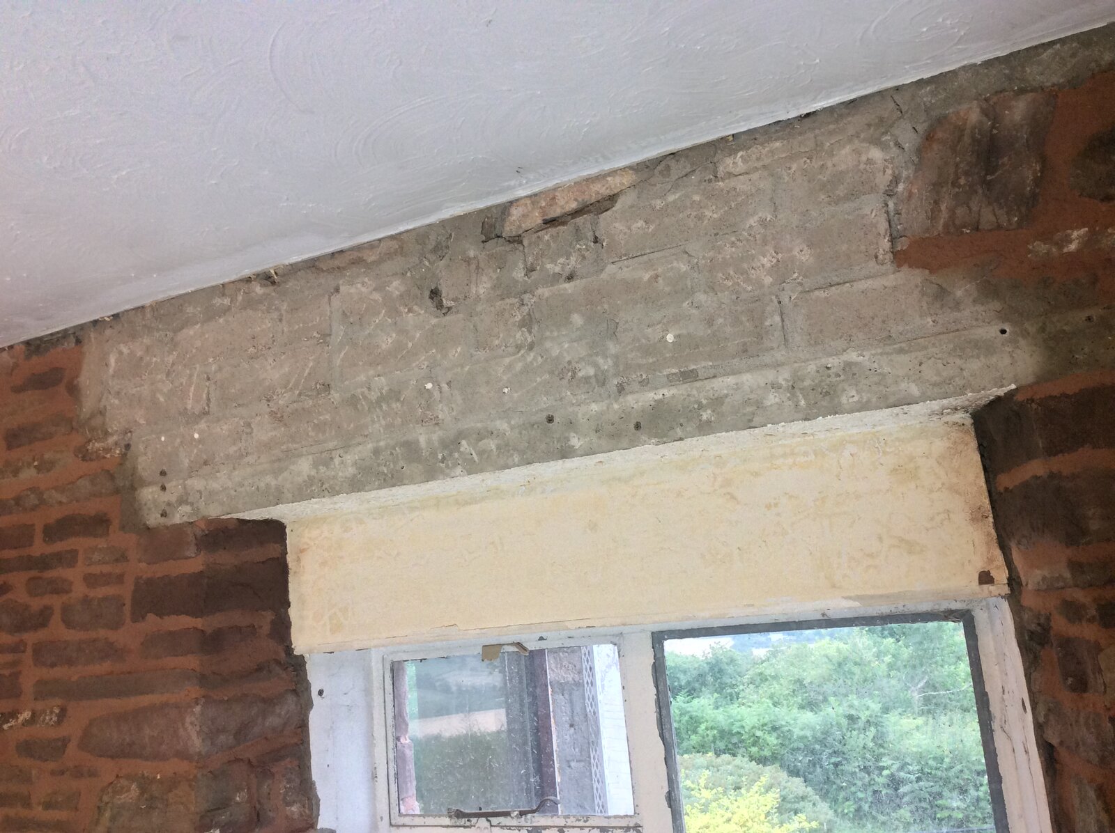

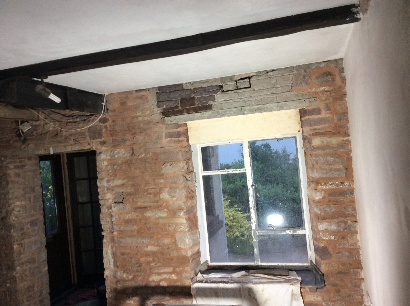

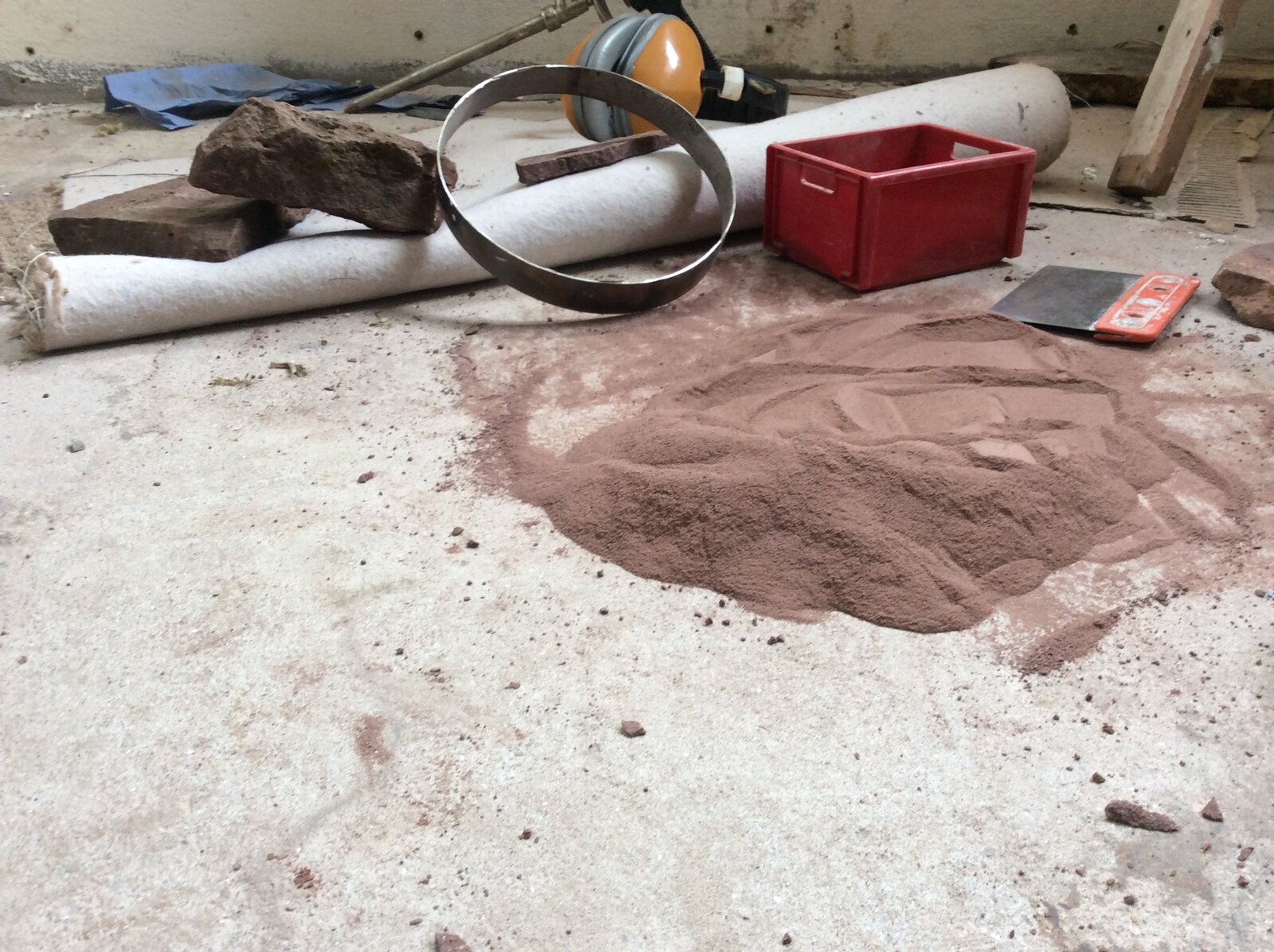

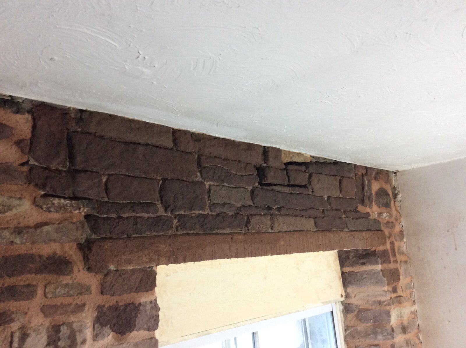

Exactly, Ive been doing similar for years with different sandstone to disguise concrete that couldn't be easily replaced with natural material...texture can be varied depending on how hard one crushes the stones.
Ive done similar outside 4 years ago and its as sound as a rock
Is that concrete impressed with a stone effect and then painted with crushed sandstone? Nice work. What approach did you use to make the outside so durable?

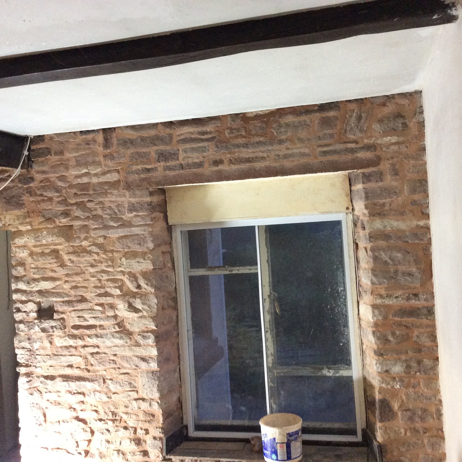

No not impressed, I cut into the concrete bricks to make them more stone like then raise the surface of each with different coloured crushed stone .
