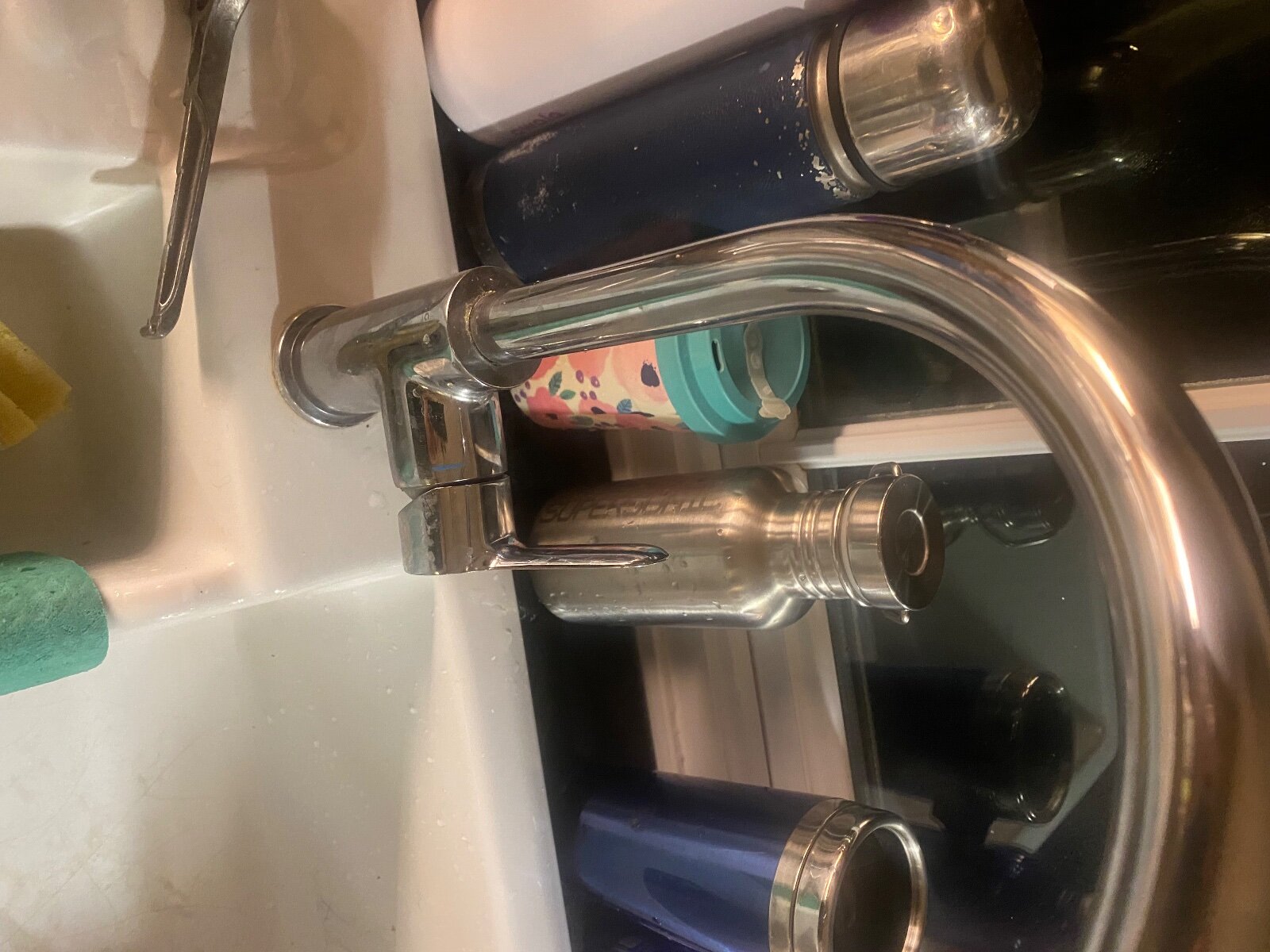

I have this tap from screwfix. It’s about 10 yo. It’s just started to be stiff when opening and closing it.
Is this fixable? Is it a cartridge issue?

I think my tap is the Grohe Bau curve 2017 model onwards. So the cartridge is 46963000. It costs on eBay £53 delivered.
A new Grohe tap (prob the same design) at screw fix is £65. Any idea why the cartridges are so expensive ? I may as well buy new as I can change myself. Seems a waste.
With it being 10 years old, I would replace the tap.
I'd agree. Simplest way.
--- and then you can attempt to dismantle the old one to access the cartridge and discover how that's almost impossible without damaging the chrome parts.
That cartridge is circa £35 delivered from https://www.showerspares.com/search/grohe-28mm-ceramic-cartridge-46963000/ and other similar places. Makes eBay seem a rip-off.
Grohe have a store on Amazon and similar kitchen taps can be seen at £55 there. So do some more research before purchase?
