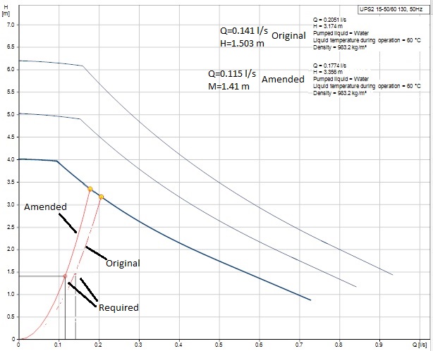

Here is a chart for the UPS2 on my system, with two graphs overlaid . The "original" line is the calculated flow rate and head when all rads are in use. This works out at: flow 0.141 l/s, head 1.503m. As the pump is on fixed speed 1, the actual working point is: flow 0.2051 l/s, head 3.174 m.
I then "turned off" three rads and recalculated flow and head, which was: flow 0.115 l/s, head 1.41 m. This is the "amended" line. Note that the required flow rate and head have both reduced. However as the system curve (red lines) has moved to the left the actual working point has now shifted to: flow 0.1774 l/s, head 3.356. The actual flow has reduced but the head has increased.

No, you cannot use the pump's working point to determine the system resistance.
However, the working point must be on the system curve, so you should able to calculate the actual resistance if you know the required flow. Which brings me to a query about your test.
<snip>

Calculating head from experimental data
Basis of calculation
If you know the required flow, actual flow and actual head (from pump graph) you can calculate the head at the required flow using the following formula:
H = kF², where H=head, k is a constant, and F is the flow rate.
What is the value of k? This varies from system to system. It also changes if the system changes, e.g a rad closes or a zone is shut. k can be calculated from the actual flow and head. Using my graph as an example:
Pump flow and head: Fp=0.2051 l/s, Hp= 3.174m
k = 3.174/0.2051² = 75.45
Required flow = 0.141 l/s; so actual head H = kF² = 75.45 x 0.141² = 1.5 m.
Compare this to my calculated head of 1.503m
If you had an accurate figure for the actual flow for the first floor zone, you would be able to plot this on the pump graph and obtain the actual head. This will give k. Obtaining the head at the calculated flow is then simple maths.

You're a wealth of information @D_Hailsham. Thanks very much for taking the time to explain this. And now the use of Proportional Pressure makes complete sense too, as the required head vs the actual head of a pump on fixed speed are always somewhat different when flow is reduced.
