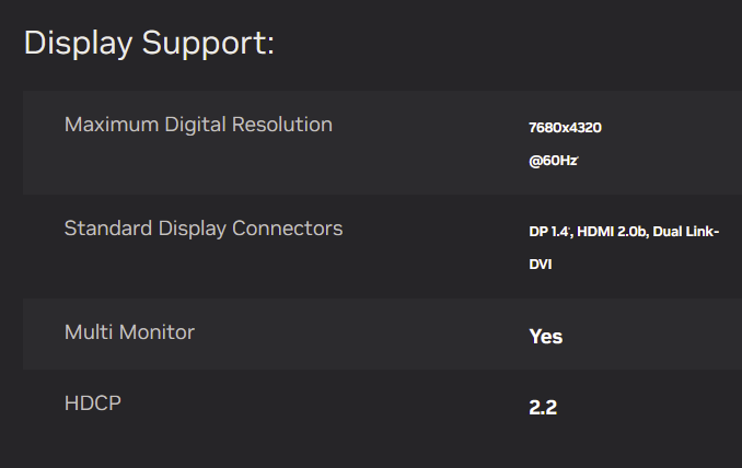

I have that card, and want to use 2 or 3 4k displays. Though the third could be lower.
Please Pick me a display or 2?
I currently use 2 displays, but both are old. (smaller is lower res)
The card has 3 different outputs: I don't know what I can do with those
I don't do games; it's for dtp, cad, stock screens, all fine stuff.

Are you referring to the Nvidia GTX1050Ti ?
I have one of those and am not seeing 4K on anything.
1920x1080 is the highest I get although that may be a restriction of the monitors themselves.
It does however run 3 monitors OK.
I use 2xDVI and the HDMI port.

I use an Nvidia GT 1030 and have a 4K plus a Full HD (2K) screen, both at 60Hz.
So a 1050 should be able to handle this and more.
The DP and HDMI will handle 4K at 60Hz. The DVI is probably more limited (I use mine for full HD).
I have a years old BENQ IPS screen, it's utterly lovely. I would recommend BENQ, and I wouldn't consider anything other than IPS.
Definitely get height adjustment. Definitely ensure all monitors are the same pixel size if you're using multiples, otherwise they won't align. E.g. I have a 27" 4K, and a 13" 2K. The second is a quarter of the size of the first and has a quarter of the pixels so it lines up properly.

I saw 7680 x 4320, and thoght that would do.
How do you use 2 DVI?

MY card has 2xDVI output a HDMI and a displayport.
However my daughters new card has only 1xHDMI and 3XDisplayport.
Which is a problem given that she only has HDMI monitors so has to use an adaptor.
